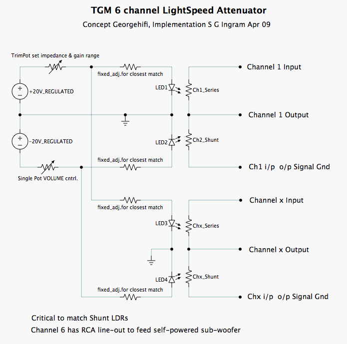

Joined 2009
I know this thread is exploring the finer points, but I'm yet to realize the starting point !!
My needs are 6 channels. I can't see this working out if I have to match 12 LDRs so I will have to go with "Mark1.5" with LDRs in both series and shunt positions but I will only attempt to match the shunt LDRs. That's still 6 of 'em so it won't be perfect. The left-over LDRs that weren't well enough matched for the shunt positions will be used as fixed series resistors.
Here's where some advice will be helpful.
1) Any concerns if I use +/-20V regulated supply rails ? - I will have these in the chasis already for the pre-amps and I'd like to avoid using yet another psu.
2) Is my general schematic OK ? (attached) - I have used some fixed resistors which I'll select to try and balance out some of the differences between LDRs - at least it makes a bad situation better.
3) I have separate signal and power grounds. The signal grounds will meet the chasis at some point but I want to reserve the option to choose where and possibly to use a ground-lift resistor in the process.
4) I haven't put any adjustment resistors in parallel with the actual LDRs, I assume that although this may improve matching it will hurt the sound quality.
Am I missing anything ?
