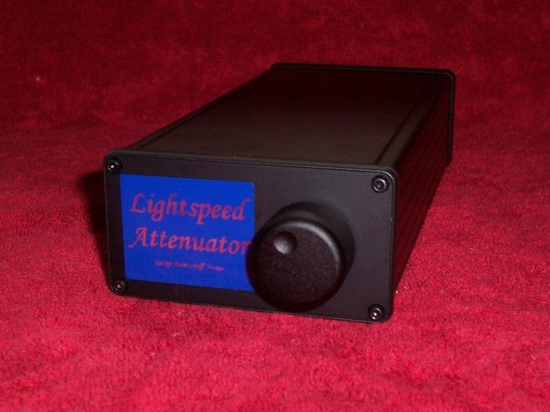

tinitus said:
Still have no clew as to what all this is about, other than a a very fine attenuator
Are there any pictures anywhere
I believe this is the first time I have posted it up, there you go, it's not exactly eye candy, but then neither is the price.
Cheers George

tinitus said:
This ligtspeed attenuator is obviously a very good foundation fore a sweet purist "preamp"
And excells over any other pure passive option
Still no answer to my question
Wont the lightspeed work just like any other attenuator when combined with a buffer or gainstage?
Apart from not depending on stepped switches etc
Seems to me it has its obvious advantage mostly when used as passive, where any other fails
Except maybe TVC/autoformers attenuators, though they are flawed by the step switches, and number of steps
Or is it because I dont understand the design
But fact is that many high quality attenuators around here easily cost the same or more than the finished product offered by George
So I could very well imagine to use it with say a Pass B1 buffer or Aikido
Or simply just ad a simple source switch module
Not really sure how to do it
That's half right, when you add a buffer you narrow the playing field between the different passives, still the Lightspeed wins out, but the margin has narrowed, "remember what I keep saying the best buffer is NO buffer" The sound is only as good as the weakest link in the system. Take out one of the weak links and you have broadened the playing field.
Wouldn't it be nice to drive the speakers directly from a dac's current output with volume done in the digital. No problem the a current output dac would love to see an 8 ohm speaker load trouble is the speaker would have to be a 1000db odd efficiency.
Cheers George

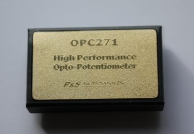

Oh, is the optocoupler below similar to the lightspeed principle?
This is a very expensive way to go, and I have no idea if it is MkI or MkII in configuration, if it's MkI it's a ripoff
Cheers George
