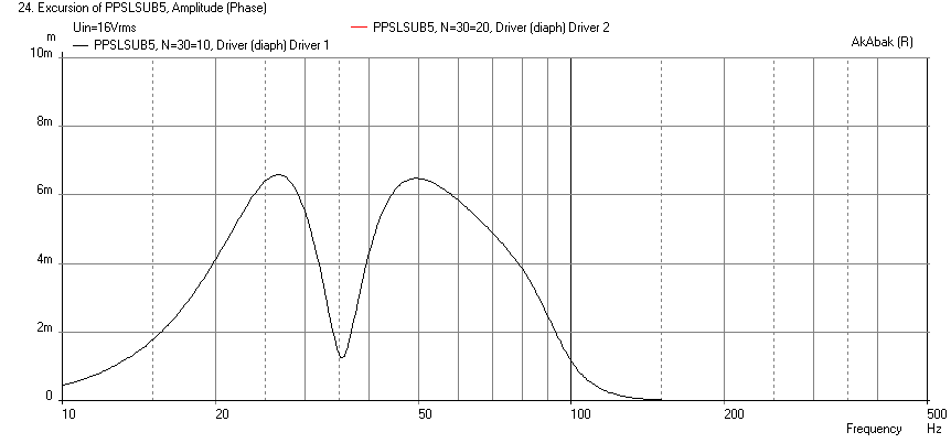

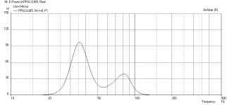

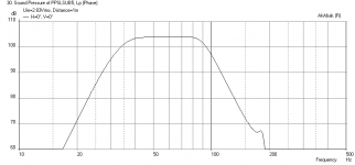

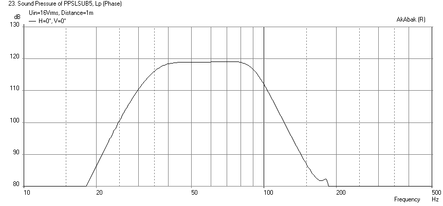

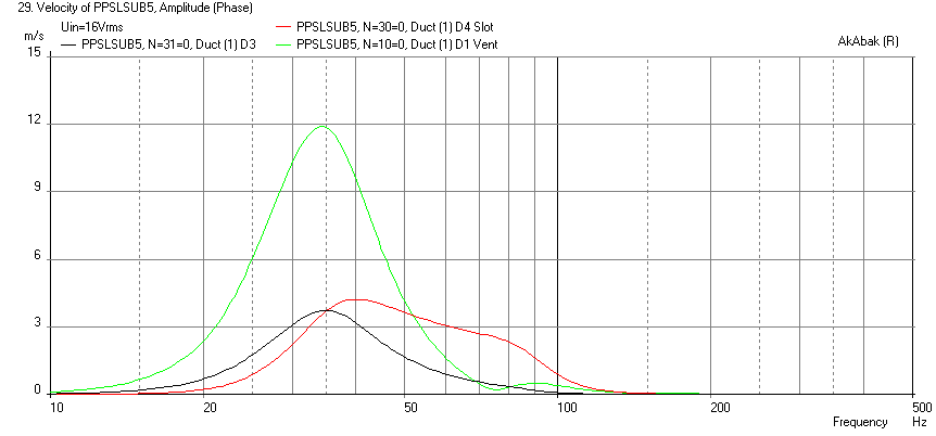

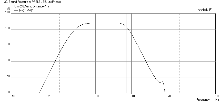

Here is a design that I came up with:
Each rear chamber is 33 liters and box has two chambers of internal dimensions of 10in high, 14in deep, 14.4in wide. There is a central slot of dimensions 10in high x 14in deep x 7.5in wide. There is a wraparound slot vent connecting each rear chamber to the central slot vent with dimensions of 1in wide x 10in high x 28in long (each). Use a -24dB/oct 28.5Hz high pass filter and a -48dB/oct 90Hz low-pass filter.
Drivers are wired in parallel so I am assuming you have a 2ohm capable amp?
Here is predicted sensitivity at 2.83v and 1m:

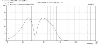

Here is cone displacement at max voltage of 14v rms:
Here is max SPL frequency response at 14v rms:

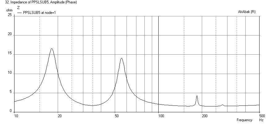

Here is calculated impedance (note tuning is about 35Hz):
Here is max velocities in rear chamber (black), wraparound vents (red), and slot (green) - you might want to make slot a bit wider to reduce chuffing noise:

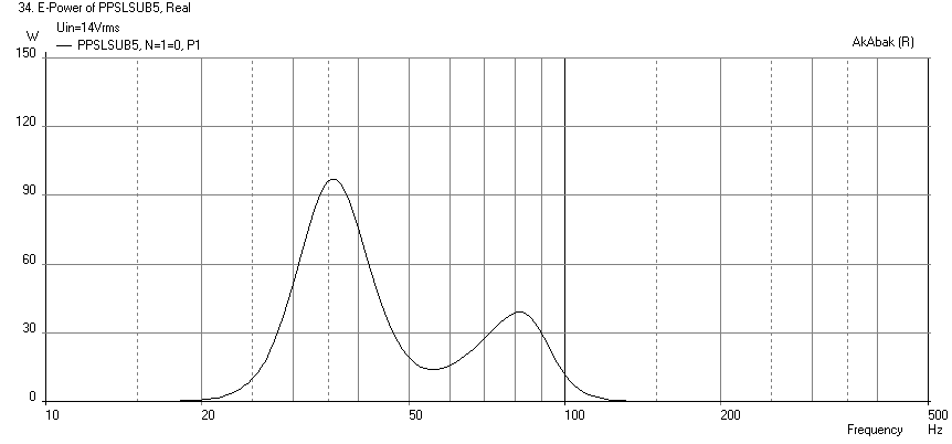

Here is electrical power:
