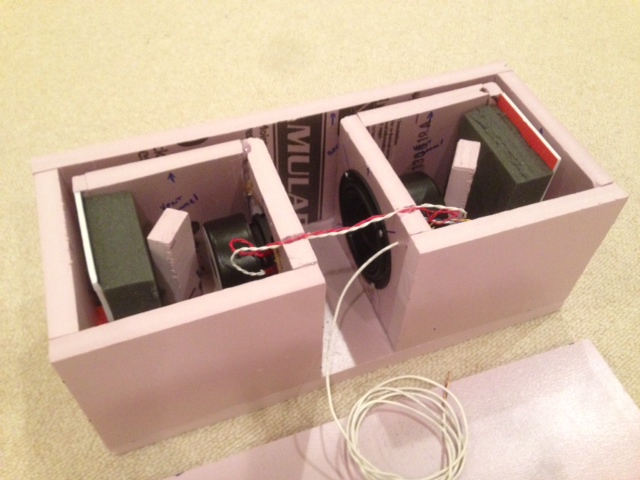

The construction was accomplished using hot melt glue and the final panel was glued with liquid nails. The weight of the enclosure without drivers is very light - I would say on the order of under a pound - feels like air.
Installing the drivers was tricky because I should have made the slot about 4.25 in wide to accommodate the depth of the driver and magnet during installation. As it is, the surround of the second driver had to rub against the first one in order to get it in. I ended up setting them both face out for easy access to the screws.

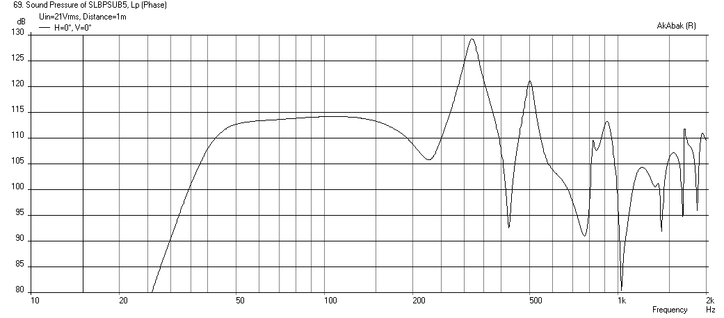

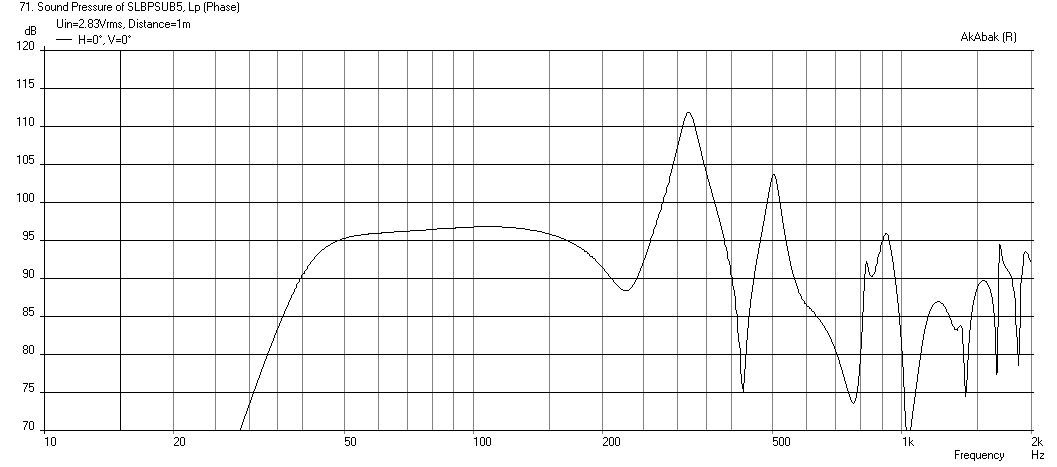

The simulation predicted about 95 dB at 2.83 volts at 1 meter at 45 Hz before falling off:
Predicted xmax of 5 mm is reached at 21 volts if using a 39 Hz -24dB/oct high pass filter. Max SPL is about 113 dB - not bad for a couple of 5 in drivers in a foam box:

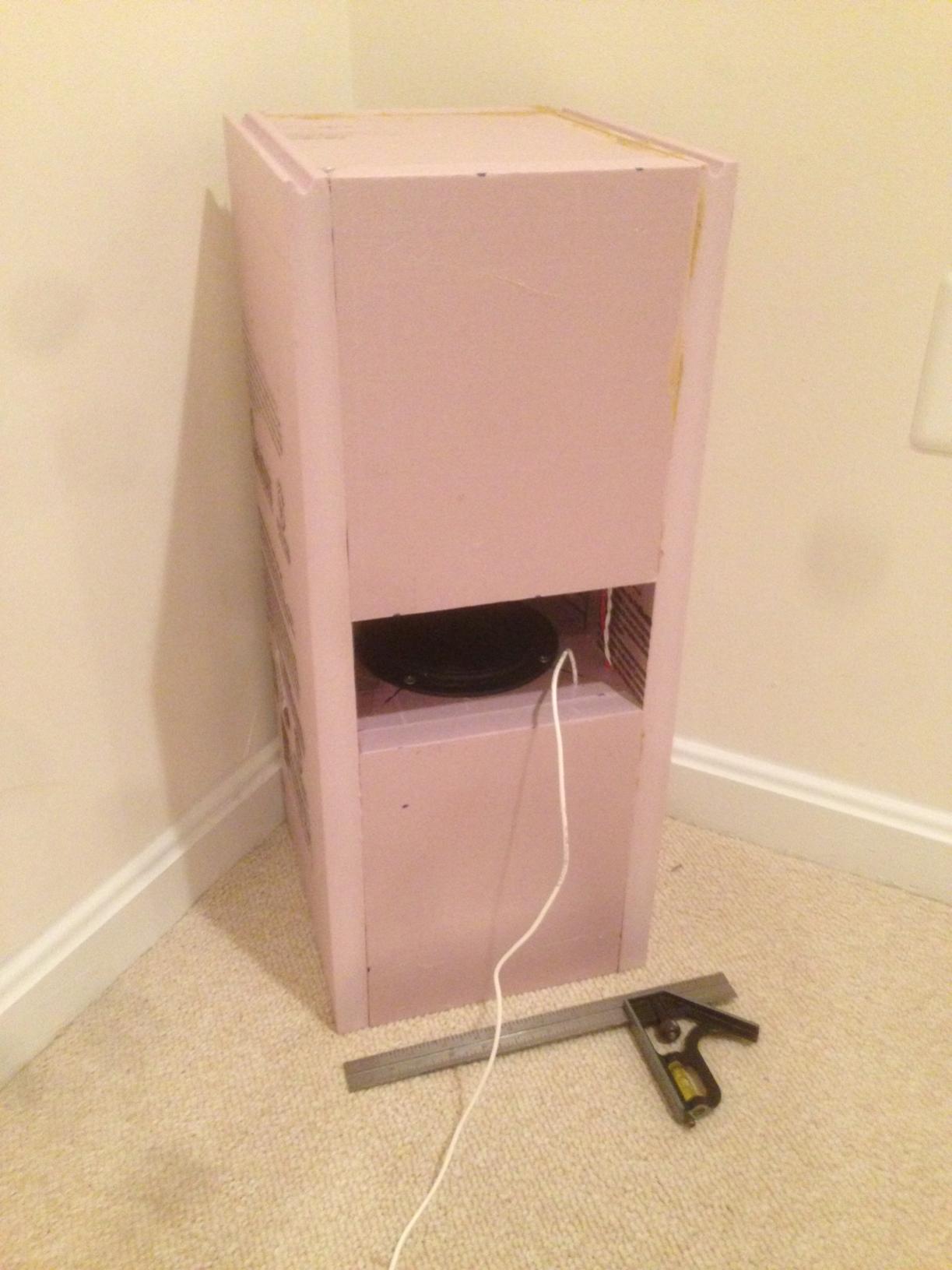

The construction went together very quickly in less than 2 hours and using no more than a razor, straight edge, hot glue, and liquid nails. Here are the construction photos:

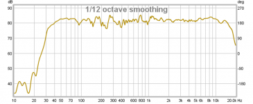

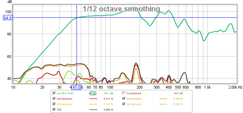

I can't make a measurement in an open field so my basement room is full of room modes and other artifacts that cause pretty big dips. However, I can see that the peak SPL at 2.83 volts and 70 Hz is about 95 or 96 dB. Making a measurement at the exit plane of the vent also seems to mitigate some of the room effects:
How does it sound? Very nice - gets very loud fast. :)

way kooL ! - that pink stuff is pretty stiff - by "razor" what did you use to cut it that square? how is the foam for acoustic "opaqueness" for mids and highs? - two 8" of the right kind should rock- if the foam doesn't flex too much. Are SLPP in general cleaner than single driver horn, pipehorn and TH?

By razor - I used a $0.99 utility knife with blade fully extended and a piece of Masonite paneling as a straight edge. When cutting keep blade vertical to ensure a square edge. This manual approach ended up with several edges that were not square and that is where void filling glues and hot melt comes in handy. Hot melt needs to be used sparingly as it melts foam. I think caulking or expanding polyurethane may be good here.

Hey thanks! I thought about the thin wood facing for the driver mounting too and it would have been nice but then would have been counter the "no power tools and no sawdust" goal that I have set for myself. I ended up using pieces of triple wall cardboard glued to the back side of the foam as "nuts" for the wood screws to bite into and hold the drivers. So far not one piece of wood was touched in this project.

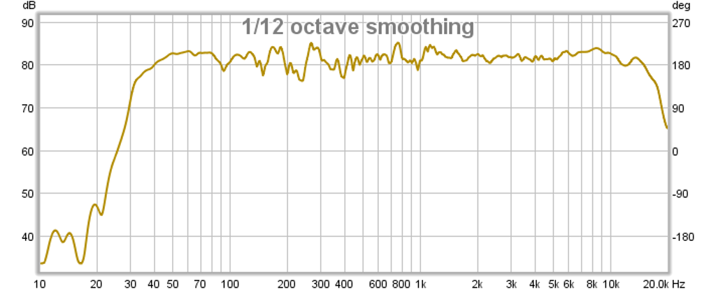

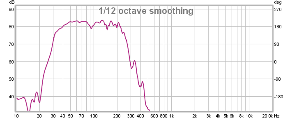

Integrate Foam SLBPsub with Nautaloss II via miniDSP

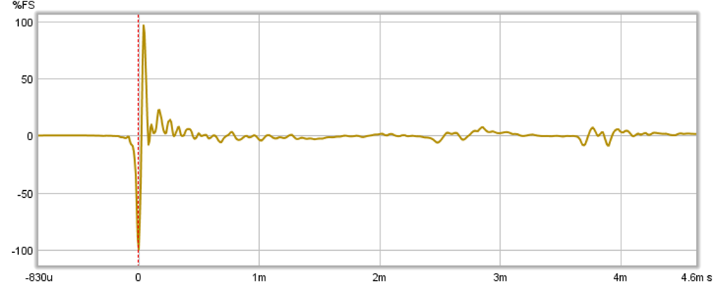

So I had a little more time to do a more careful setup to fully integrate the new sub with my existing system in order to test the sound quality with listening to full range music rather than bass beat heavy dance tracks. My setup is described in detail here http://www.diyaudio.com/forums/full-range/247598-nautaloss-ref-monitor.html. The current setup is the Nautaloss II which uses dual Vifa TC9FD drivers for the fullrange monitors, a miniDSP 2x4 for XO and EQ duties, and TPA3116D2 bi-amps powered by 19 volt laptop bricks. The electronics setup looks like this:
I then proceeded to make a measurement at the listening position near the middle of the room and used REW to smooth the subwoofer response. I selectively removed any major valley-filling (positive gain) EQ in order to avoid increased HD. The goal is to cut peaks and not fill valleys. Here is the response after REW is applied, and the sub has -36dB/oct high pass at 28 Hz and -36dB/oct low pass at 175 Hz to integrate with the fullrange tops. I also applied a +9dB low shelf (Q=0.8) from 45 Hz on down to bring up the deeper notes. Here is the response of the sub after REW:
Now, the Nautaloss II tops are switched on and this is the resulting response:
This is the corresponding impulse response from the system:
It sounds very tight and articulate with just enough reach to cover the 41 Hz bass notes. One of my favorite test tracks is SRV's Tin Pan Alley. Sounds fantastic.
