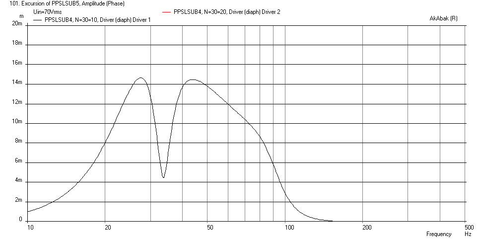

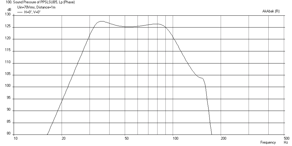

Design for Sundown Audio 8V2 driver

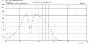

Chrapladm requested a design for a sub that could use the 8inch SA 8V2 driver (which has 16 mm xmax and 500 watts RMS power handling - SA Series).
It turns out that with very minor tweaking of the geometry used in the MCM55-2421 that Tb46 came up with above allows this driver to work pretty well as a sub that has 31Hz (-3dB) and capable of about 125dB (at 1kW to the pair power limited not xmax limited) when corner loaded.
The final design ended up at exactly 1 cu ft volume per driver rear chamber, a 7.5 in wide x 10 in tall x 14 in long central P-P slot vent, and the only tricky part is the very long vent which will require a labyrinth to fold 36 in long 1.0 wide x 10 in tall slot vent per side into the box. Note that the slot is a rather wide 7.5 in to fit the 6-5/8 in deep driver in a push-pull config.
Here is the predicted SPL vs freq at max power of 70 volts RMS:
attachment.php
Here is the corresponding cone displacement with a 29Hz -24dB HPF and a 90Hz -48dB/oct LPF:
attachment.php

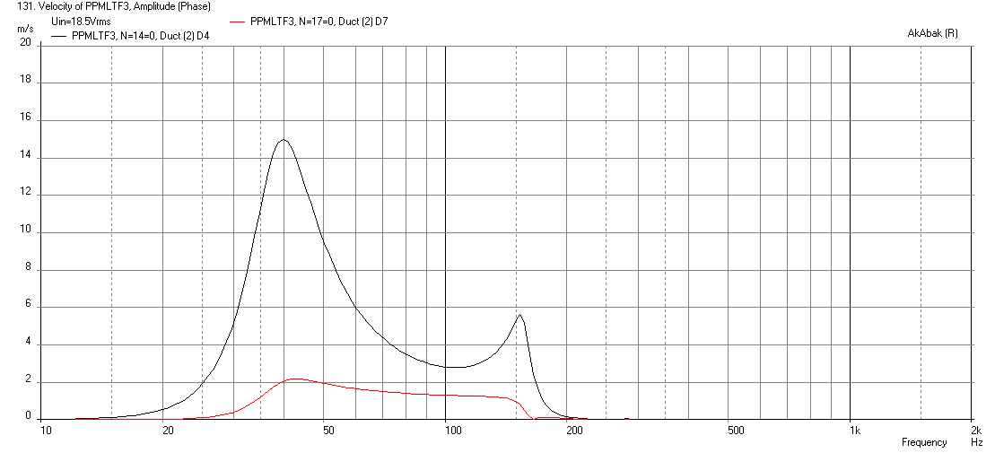

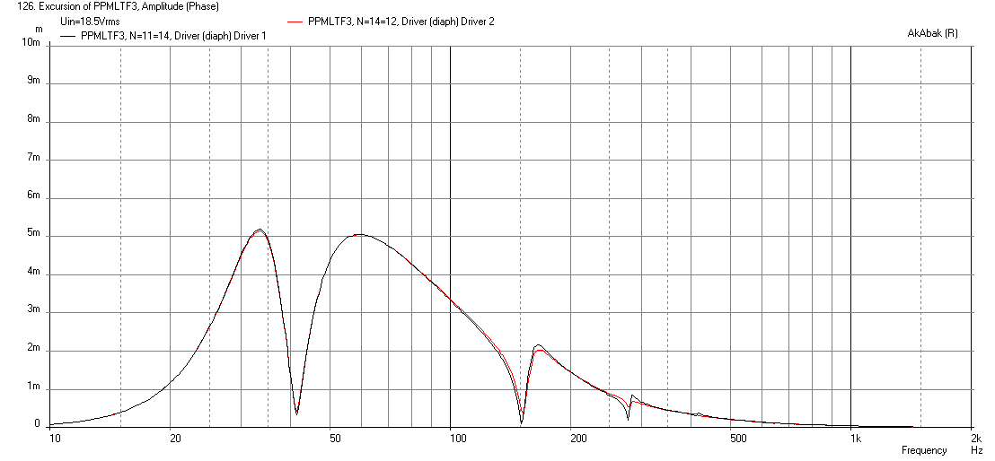

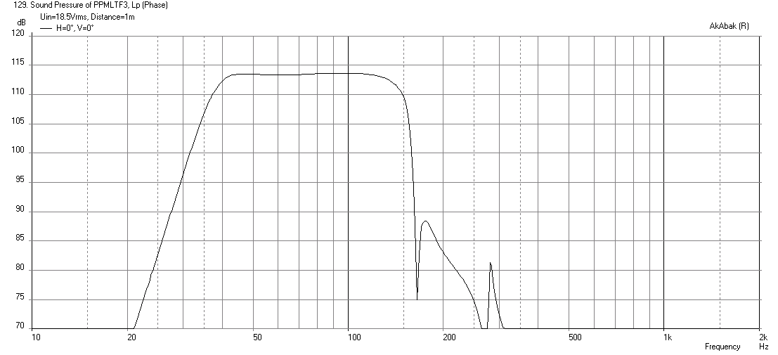

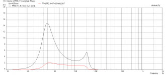

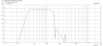

Push-Pull ML-TransFlex (PP MLTF)
From some work I did on modeling a PP MLTF in this thread: http://www.diyaudio.com/forums/subwoofers/259509-new-sub-design-constricted-transflex-simple-build-series-tuned-6th-order-17.html#post4029749 I realized that it might be advantageous to convert the SLBP sub into this alignment with a few steps:
1. extend the length of the chamber to support 1/4-wave action
2. combine the two chambers into one in order to make more compact by allowing the drivers to be mounted push-pull on the same baffle but one flipped.
3. Convert the long thin vent to a larger cross section to serve as a mass-loading duct for the TL.
4. Have the ML duct exit into a common outer driver chamber/mouth where the sound radiates and this allows the 6th order bandpass action to happen.

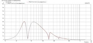

So I came up with a much more compact design for the dual W5-876SE that is now 16in (W) x 16in (H) x 12in (D) - assuming 0.5in thick panels. Here is the predicted frequency response at xmax (18.5 volts) when corner loaded. A 38Hz 24dB HPF and 150Hz 48dB LPF were applied:
attachment.php
Here is the cone displacement at xmax:
attachment.php
Here are the vent and mouth exit velocities at xmax (all good):
attachment.php
Although it is corner loaded, the sensitivity obtained with a couple of 5 inch drivers is remarkable, and the response is very flat from 40Hz to 150Hz.

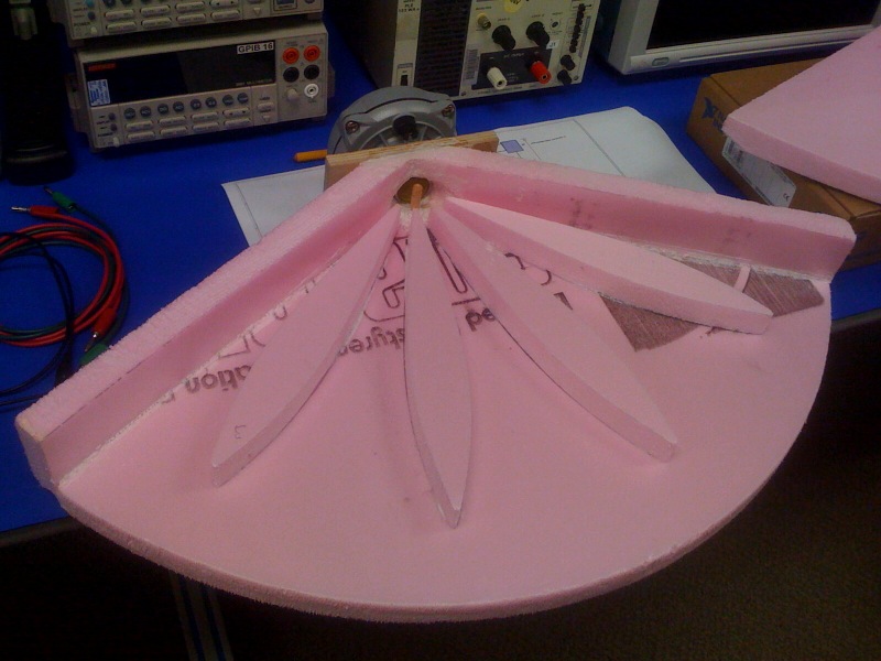

When I cut the styrofoam Smith horn, I had a lot of trouble with knives and saws
dragging and tearing as much as cutting. Eventually resorted to a guitar string on
a bamboo bow, heated by a car battery charger...
Your Smith horn looks fantastic! How does it sound? I had good luck cutting straight lines with a brand new box cutter blade. Get the ones that break off. When it starts to drag and make rough cuts get a new one. Your curves may be difficult to get clean like that with anything other than a hot wire. For the Smoth horn where did you get the dimensions or is this your own design?
It sounded okay, till he dropped it and broke it off near the throat. After that, despite some gorilla-glue fueled repair attempts, it was never quite the same again. :)
Seriously, it did work, though I recall it still had a bit of a honk and some sound leaked through the foam board.
Finally, we did (temporarily) attach some NXT exciters to the contraption to extend its response downwards . The approach did work (though we didn't mess with crossovers etc to optimize the sound) but the horn might have been fractured by that time. I don't recall.
Original thread here : http://www.diyaudio.com/forums/multi-way/153831-styrofoam-smith-horn.html .I've attached the design doc and theory to this post
