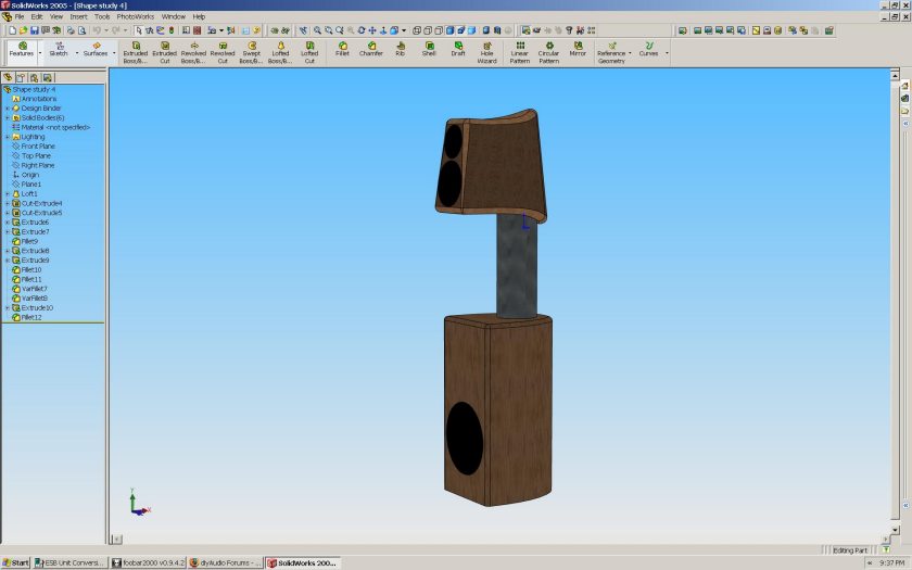

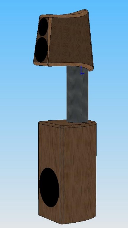

I designed this strange looking speaker as a space solution for myself as a high end computer speaker for use in close to a desk and as a near field computer monitor. It started as a two way with an integrated stand that could increase the volume of the cabinet for better bass response. It is designed to fit tight in a corner if necessary, and the head unit can rotate for placement flexibility. Then I decided to use the base as a woofer cabinet and the following monstrosity came about. Forgive the funny textures. There is something wrong with my Solidworks. It's behaving buggy and I can't get some of the 2D textures to work properly.
Anyway I though this or something similar might work as a good full range side surround speaker in a small room because of it's rotating head and integrated woofer/base. Since you were thinking about surrounds in the other thread the other day I thought I would show you this creation. I think I am going to try and make something like this for my computer workstation.
The base of the upper cabinet is about 33 inches from the floor so the tweeter is about at my ear height when I sit down. 8 or 9 inch woofer and 5.25 mid/bass.

Looks funky!
Interesting idea, I'd have never thought of that. Certainly I can see a valid use where space is tight. This is nearly always the case for most folk's surround channels. They're either tiny little wall mounted efforts that don't extend much below 100hz or they're a decent size standmount or floorstander but with horrible positioning in order to remain room layout friendly.
That design might work to the advantages of both approaches ie. fairly full range that can be easily placed in the room.
I think the aesthetics might need a bit of juggling but the design is pretty sound. Neat idea.

I thought that they looked kind of cool when they were in the 2 way stage before I added the integrated woofer and the base was just a 1.5 inch thick slab. But they wouldn't blend too well visually with your front design. The base is just a footprint size that I need to get them to fit where I need them. And one is in a corner. But I thought that since they won't show much in my application that I'd leave the base as is. To have an 8 or 9 inch woofer with a computer speaker will be kick butt. Right now I'm using some cheap mass market Pioneer mini speakers and an Onkyo receiver. Better than normal computer speakers but I would like a bit better. Mostly used for low level background music and training videos while on the computer.
I'm using Solidworks 2005. It's a couple of years old and the 2D model textures don't seem to work correctly. They work on common shapes that have flat surfaces but have a hard time if the surfaces are not flat. The 3D realview textures won't work since I don't have an official Nvidia Quattro FX CAD video card. I won't buy one. They are a racket but rendering still works if I need a good rendering. I usually use Autodesk Inventor for most projects but I like Solidworks for speaker conceptual design because it has more chamfering options.
Here's a screen shot, I'm using 24 inch widescreen LCD HP monitor which I recommend for CAD. Sorry for the small compressed image. The original screen dump was 7 megs and I had to compress it.
What resolution is that?
I use 1920x1080 through a 102" front projection effort - good for gaming and movies but not really a typical CAD setup. :whazzat: I've seen 30" LCD's with 2500x1600 or something like that going for fairly reasonable money(approx £600) I've found the more desktop real estate you have the easier and quicker the whole thing is.
I'm going to have to look at those M&K surrounds you are basing your design on. Good luck.
The M&K use really poor drivers in some weird tri-pole arrangement(think 3 driver arrays pointing 90 degrees to each other) but I like the overall space saving design of the cabinets.
