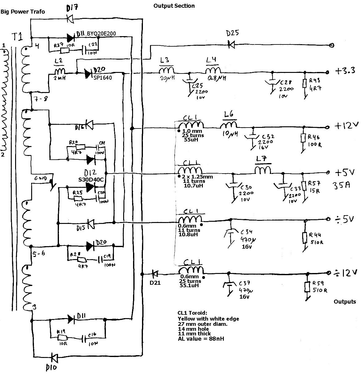

How many µH is the output filter toroid coil from a puter ps ?

You need to know the 'Al' value of the core in nH/turn^2. This is often quoted in the manufacturer's data sheet.
For example, if the Al value was 1uH per turn-squared, then the required number of turns to get 20uH would result from the equation N^2 =L/Al therefore N^2 = 20, so you would get 16uH from 4 turns, or 25uH from 5 turns.
In reality the Al value is likely to be lower than this so you'll be able to adjust the number of turns to get closer to your desired value.
If you don't know the Al value, and you have an inductance meter, then simply wind 20 turns or so on the core, measure the inductance, and apply the equation above to determine the number of turns to get your desired inductance.

Try micro metal material -2 or -6, that's what give the best result. At least KoolMu material too.

PS. If you change the core material, you will change the pole of your feedback loop...Always think about this!
