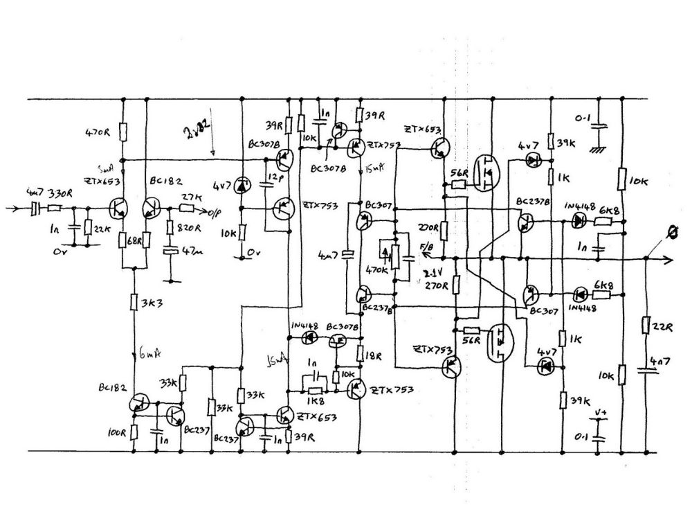

Can you post the schematic that you drew, maybe one of us can complete or correct the rest.
I haven’t seen that particular piece of paper for many years unfortunately. I'll have to start again.

The 'new revelations' thread was interesting but it amuses me that there are people who so keen believe the myth of Les Sage's sliding-bias non-switching topology.
I think that enough circuits have been posted to convince people that they were just very good & compact class AB designs.
There is no magical combination of mistakes we could have made when transcribing the circuits that could have removed evidence of the non-switching function and yet still left a workable amp design!

I agree, based on other non switching designs there is nothing in any circuit which suggests this was ever implemented. Only in Les's literature and possibly notes and or dreams.
