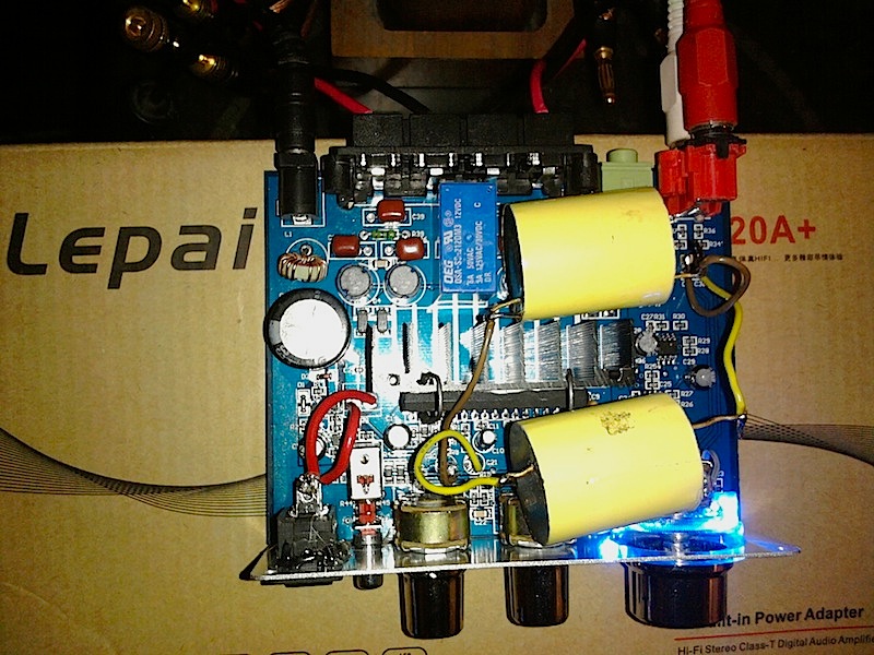

I put my "dead" unit components on board again and gave it a try first connecting an vu meter to the outputs since I don't own a multimeter and the neddles responded as they should to the volume set and power. I did that to avoid blowing up my speakers in case everything was wrong
To bypass op amps and tone controls on TA2020a+ pcb 101110 you must remove c30, c31, c20 and c21.
Then just connect c31 positive to c21 positive and do the same with c30 and c20. Yes, the caps orientation for c20 and c21 are wrong printed on the pcb.
As you can see I used the same bipolar coupling caps that wer originally placed at c20 and c21. I have mundorfs, metal film, nichicons and new inductors on their way to my home already.
Shame on me for asking you guys how to bypass it. It needed only a look at the schemathic of the old lepai, the ta2020 datasheet for pinouts and ta2020a+ pcb. I feel ashamed for asking on how to do it.
Oh i'm pretty happy with the result. No clipping, no hiss I can increase the volume much further with the plesure of having a much better experience. I almost can't believe it is the same amp. I don't need op amps to play louder with the expense of heinous sound quality .

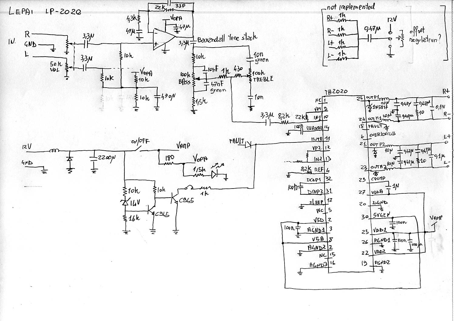

Good question. I assume both op amps were bypassed. A look at the schematic will tell us. Do you have a link to one? I could only find this older v schematic from djnemesi:
That post is here.
I can't find the 1.75uF caps.
But it appears the input hits c30/31 first on the 2020A+, then goes to the pot, accounting for the bypass including the volume control. That's not the way it is on the older schematic. I read in another forum that those caps are not good for audio applications.
C20/21 should be the coupling caps. But I can't find anything of that value on this schematic. Wouldn't they connect to or near pins 10 and 13 of the Tripath chip? I'm out of my comfort zone, dunno.
