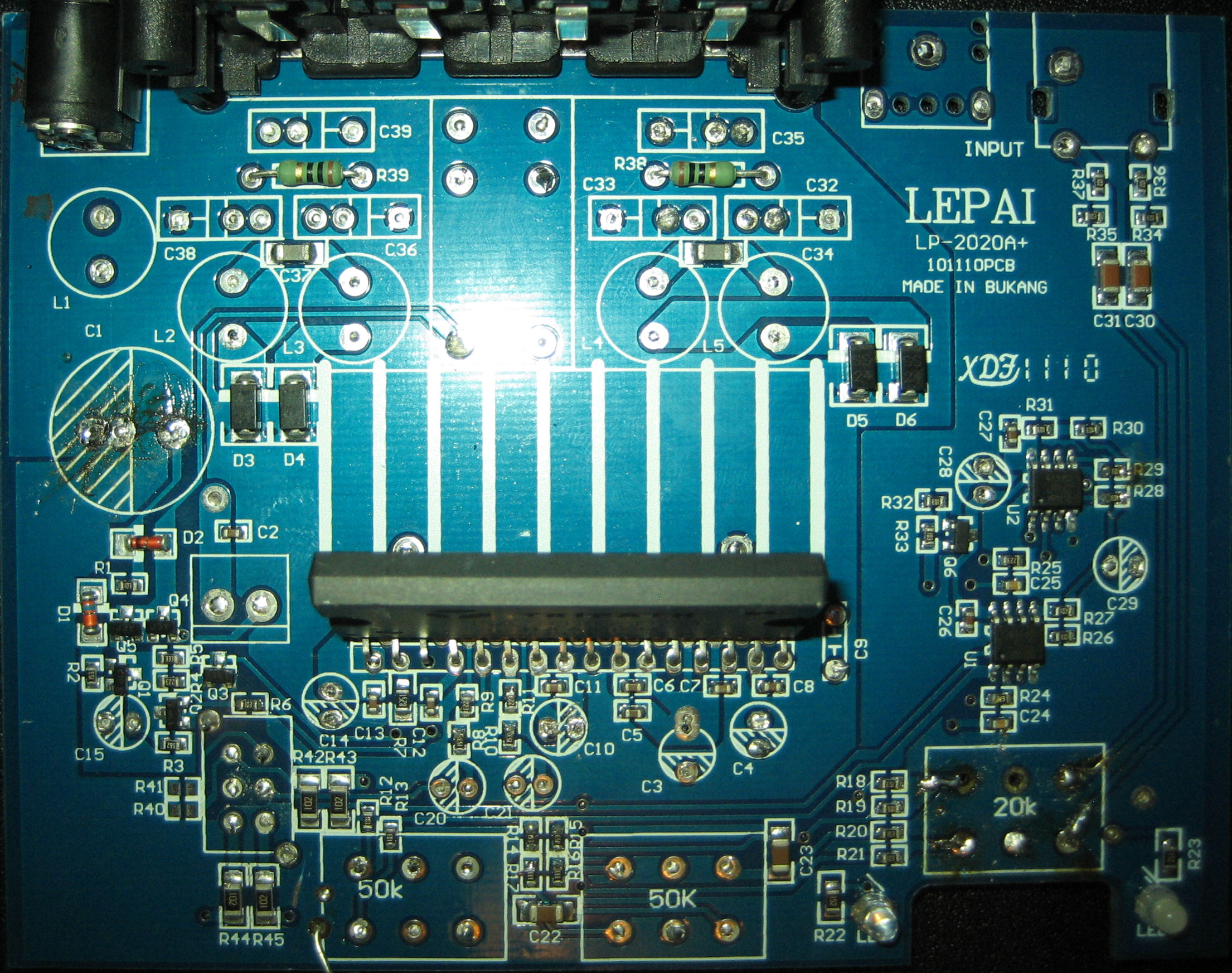

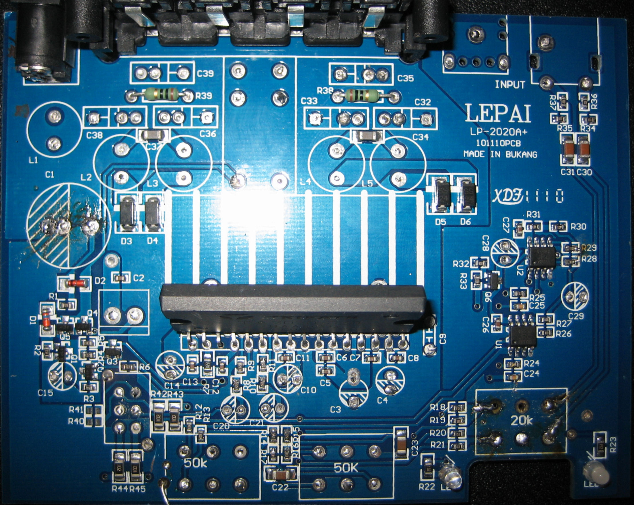

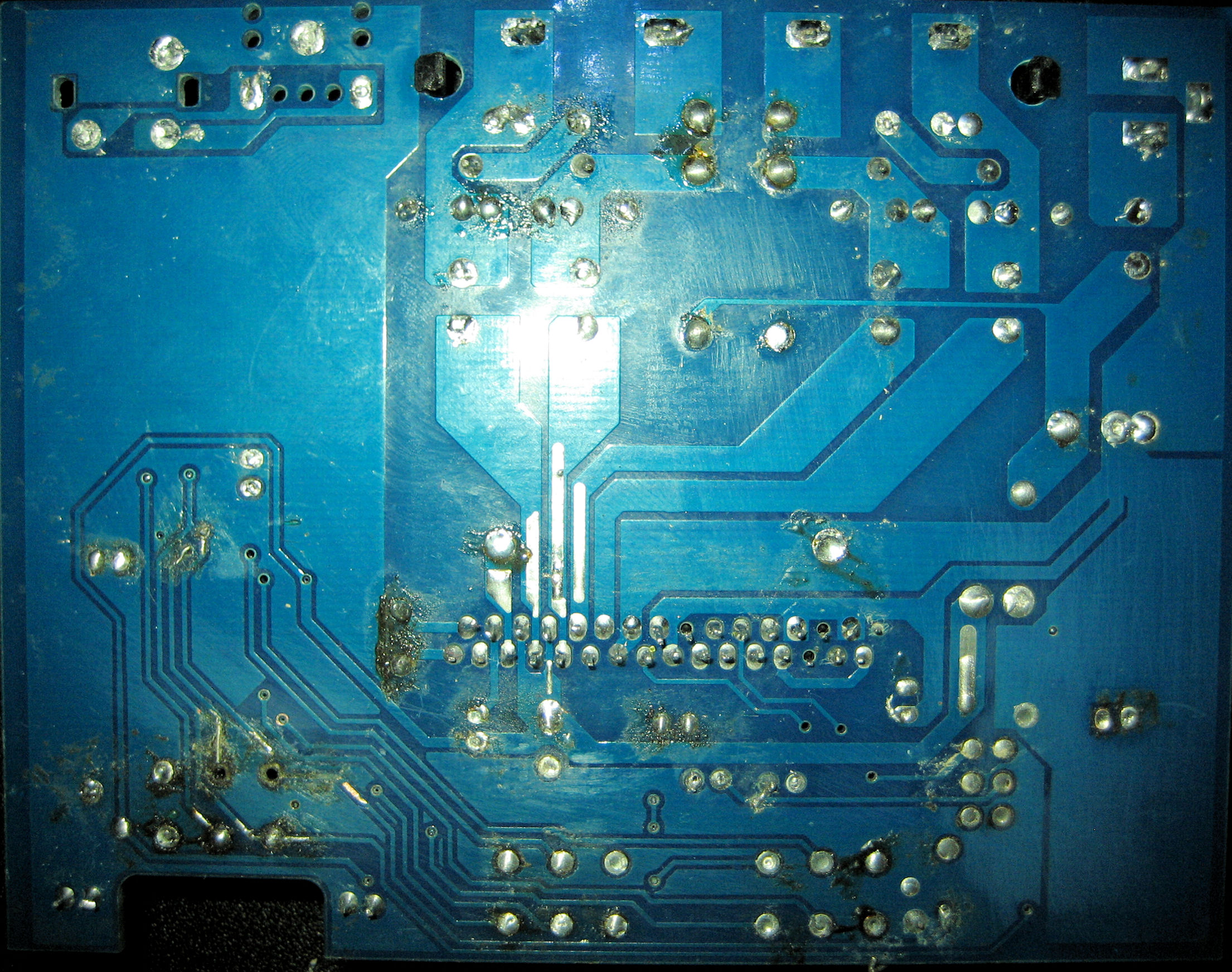

I received four TA2020A+ today and while I did purchased the old version with through hole components there is nothing I can do about that:(.
Three of them worked out of the box and one was dead.I tried to look out for shorts, bad soldering and I even replaced caps but nothing changed.
Two units had awful bass and some hiss while the last one had a much better overall sound quality. I did opened that unit and the one with better sound had black capped inductors while the other two, blue. I don't know if the better sound quality is related to the different inductors but who knows.
I know that many of us, lepai ta2020a+ owners want to bypass tone and or opamps and while I don't have the skills to trace the pcb and create a datasheet / find a solution I can always use the dead unit and get it almost naked and that's what I did.
I hope it helps and if anyone happens to need a photo or details about a specific section of the pcb just ask, please. Bellow I attached some high res photos.

So if took it right from what was wrote here and what the old version schematics shows. To bypass tone controls and op amps on the pcb 101110 (ta2020a+ ) one just needs to remove c30, c31, c20 and c21. and then connect c30 negative pad to c20 positive using coupling caps and do the same with c31 and c21 ? Do I need to cut traces or remove any other components ?
Thank You
That's it.
I put my "dead" unit components on board again and gave it a try first connecting an vu meter to the outputs since I don't own a multimeter and the neddles responded as they should to the volume set and power. I did that to avoid blowing up my speakers in case everything was wrong
To bypass op amps and tone controls on TA2020a+ pcb 101110 you must remove c30, c31, c20 and c21.
Then just connect c31 positive to c21 positive and do the same with c30 and c20. Yes, the caps orientation for c20 and c21 are wrong printed on the pcb.
As you can see I used the same bipolar coupling caps that wer originally placed at c20 and c21. I have mundorfs, metal film, nichicons and new inductors on their way to my home already.
Shame on me for asking you guys how to bypass it. It needed only a look at the schemathic of the old lepai, the ta2020 datasheet for pinouts and ta2020a+ pcb. I feel ashamed for asking on how to do it.:eek:
Oh i'm pretty happy with the result. No clipping, no hiss I can increase the volume much further with the plesure of having a much better experience. I almost can't believe it is the same amp. I don't need op amps to play louder with the expense of heinous sound quality .
