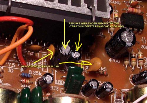

I think it would be very useful to replace bulk capacitor (180uF: TA2020 schematics have two x 180uF, someone goes up to 1000uF, I noticed that two x 470uF give better mids...). Any experience?
Hi Calamaro,
Do you mean that I should change the 180uf cap and metal cap in pair as attached photo?
Thank you.

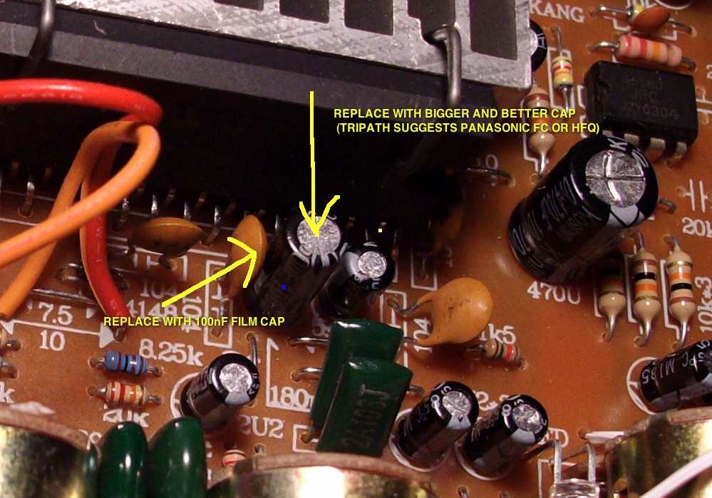

panda360:
no, just replace capacitors pointed by the arrow (one electrolitic and one ceramic, please see pict.). As electrolitic replacement Tripath suggests Panasonic FC or HFQ, but I think anything will be better than the existant one! Anyway go for a low ESR and add some capacitance (470uf or even more). Replacement will be more confortable if you invert electrolitic and ceramic cap place (they are paralleled), as ceramic has more room on the board, but pay attention to electrolitic polarity! Plus on chip side, minus on pots side.
