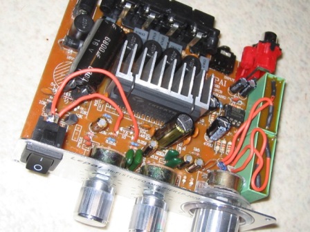

Many thanks for the explanation Calamaro
I attached this small 100nF film capacitor under the board - very quick and easy job. I didn't expect to hear any difference, but it looks like stereo separation is now a bit better.
Regarding big (2.2uF) film capacitors, I have found this one
Do you think it will do the job?
Are there any other mods of this board you can recommend?

I just want to show off my modded Lepai. It does sound so good, much better than in stock form.
I used Panasonic FC 4700uf near the chip and Panasonic NHG 6800uf for p/s.
The signal input caps are MKT 1822 by Ero. BTW, are these better than the Ero MKC 1862?
A friend gave me a couple of each and I am not sure which are the better ones. They barely fit in the box.
I also used OPA2134 for Opamp. I am ordering the NE5532 to try out, may not be as good.
Those little gold caps are Nichicon 2.2uf "Fine Gold".

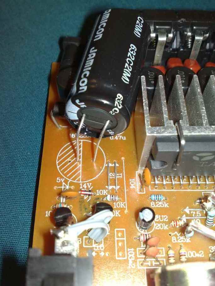

Hey guys, just got back, the Lepai works (or worked) great in the car. I say worked as it is no longer working...
I was listening to some quiet music from an MP3 player, so the volume was up high, maybe on full...
A loud song then came on after, I had around 2 seconds of very loud music and then the amp cut out...
Now all I get when unmuting the amp is a ticking noise. The ticking noise goes when it's muted.
What would be the best way of troubleshooting this? Check for DC offset on the outs?
So far I've check the op-amp is getting power, I'll try and find some small caps so I can try bypassing the tone controls to check the tripath chip is getting a signal.
I have a feeling tho that because of the clicking it's the TA 2020 or maybe the output diodes or inductors. Could I have cooked thru an inductor with excessive current?
I was using 4ohm car speakers, with a passive crossover, so not exactly the easiest load for the amp.
I already have another one on it's way that I ordered on Friday, but I'd like to fix this one if possible.

Sorry to hear that your amp is burnt. Col is correct, The voltage cannot above 13.5V.
Hoped that the TA-2020 haven't burnt.
For your new amp, you may need to add a resistor to lower down input voltage.

I have already modded this unit, just the power input mods (cap reaplaced with a 25v 6800uF unit, inductor and diode removed) so I think I'll try to fix it.
I read thru the TA2020 datasheet again today and it has what sounds to be a helpful thing called a fault pin which can be wired up to an LED & resistor, and I'm guessing the LED will flash to show what the fault is...
I think I may also have some high current inductors, that are around 10uH, I'll try swapping these and see if anything happens.
Ok, I've made some progress (I think), I'm getting 5.1v on pins 2 and 8, 1.05v on pin 4 so I think the TA2020 is ok.
I found that a zener diode is wired to pin 18 (fault pin) and I think this is somehow connected to the pin 11 (mute pin), I tried lifting the zener diode where it's connected to pin 18 and no more clicking, yet still no sound despite a small thump when unmuted.
The zener is still out at one side, and I'm now seeing pin 6 (overload) is grounded when I unmute the amp. Here's what it says in the datasheet about pin6: "A logic low indicates the input signal has overloaded the amplifier"
Is "logic low" another way of saying the pin is the same voltage as ground? I also measured from the +12v on my power source, and it was reading at -12v, so it's definately ground, so could it be a fault with the input signal?
