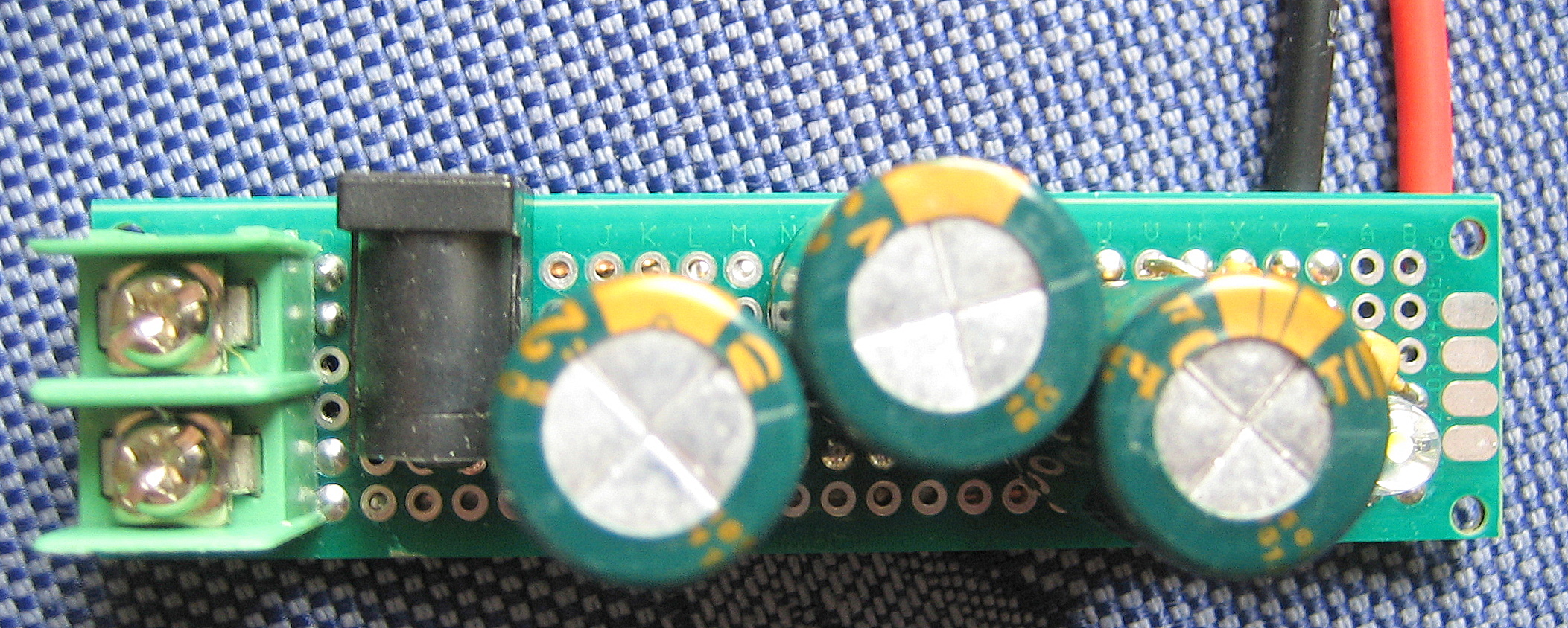

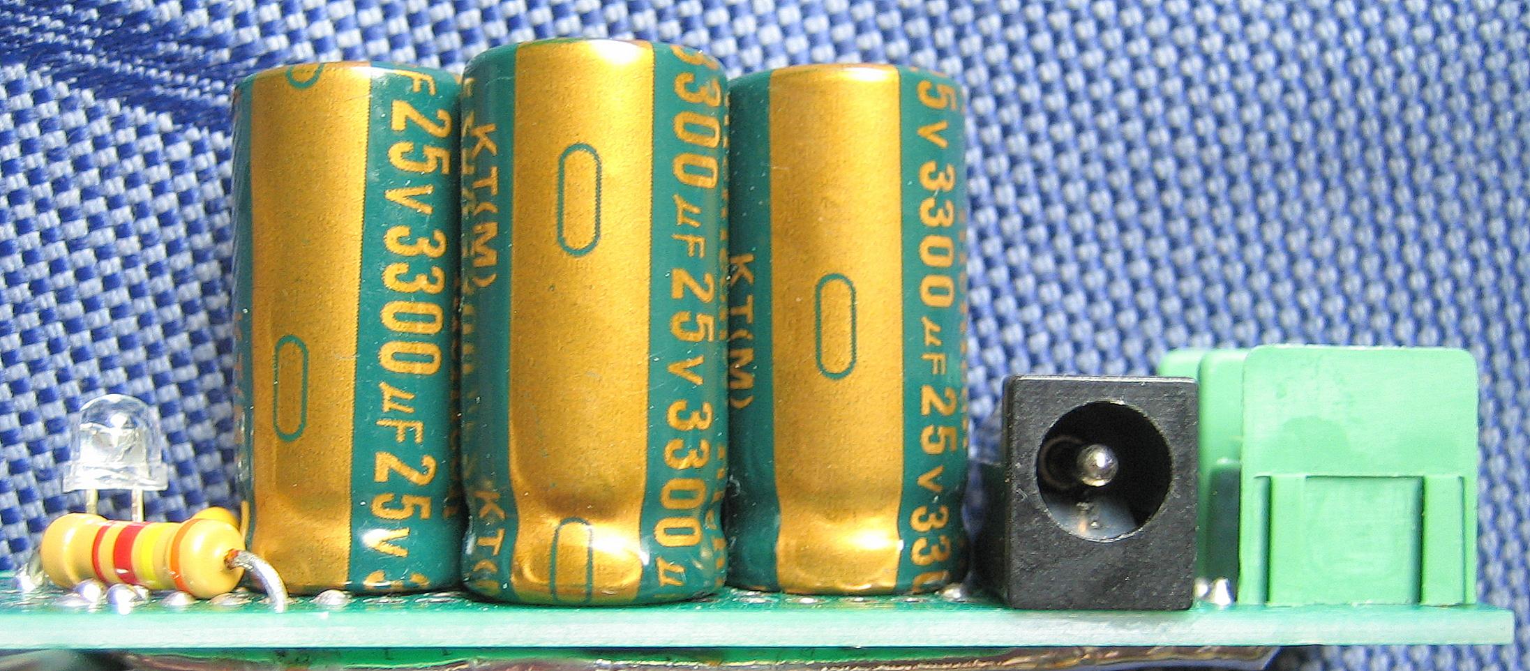

External capacitor buffer
Appended you find two photos of how an external capacitor buffer can be constructed. The one shown uses three 3300uF capacitors, thus, in total 10000uF.
It has got a DC input connector fitting the output connector of the power adapter. Further, it has alternative screw terminals for power input. The output is the black and red wires going to the amplifier power input.
Also, a LED-diode is added to show when the power is ON.
