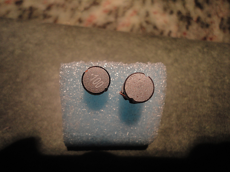

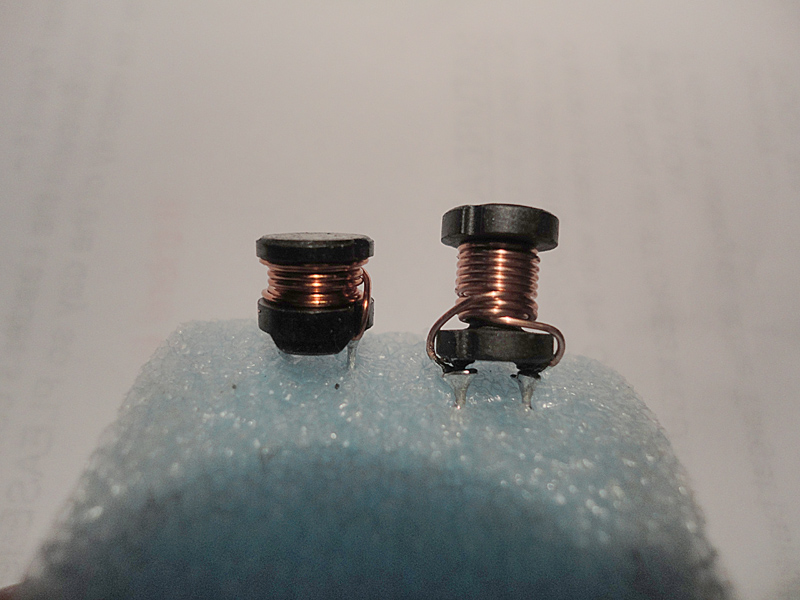

Needed to order some parts from Mouser so I thought that I'd add the Wurth coils to the order just to see what all the talk is about concerning using these to replace the four output coils. I stripped off the shrink tubing to see what it looked like in comparison to the stock coils used in version 3 boards. Looks to be the sane size wire in both. Less wire in the Wurth coil and the Wurth coil is a smaller iron bobbin. Just thought that I would attach photos for those that are curious.
How many ampere are these Wurth coils rated? The ones used in Lepai are 3.15A.
