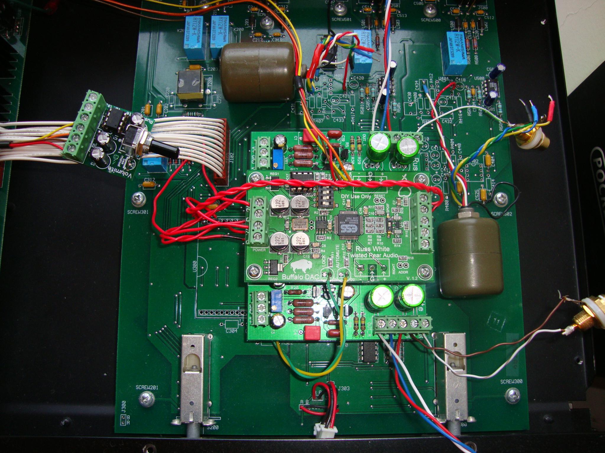

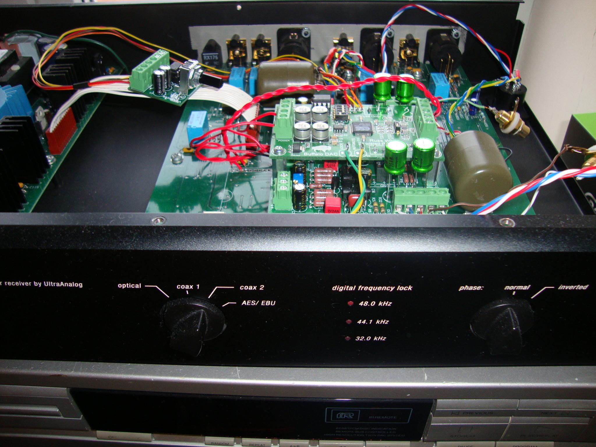

Readers on this thread may recall that I was playing with Legato output swing as a way to tweak dynamics to my system's very particular needs. After finalizing my settings and enjoying listening for a while, I found another very surprising way to augment response dynamics and for a very minimal investment. It took my 'mostly TPA' rig to a completely new level. I had no inkling of its potential. My learning experiences are chronicled in a conversation beginning with: http://www.diyaudio.com/forums/mult...ng-impressions-techniques-56.html#post2428295
I mention it with appreciation here because my results would not have been possible without the *superlative design and performance* of B2/Legato and my other TPA stuff. Post queries over there, not here...

Since it's you, Russ, I'll post here once more.
I've never heard any digital source sound like this. I'd like to sit you where I'm sitting, hand you a lovely beer, and watch your face when some wicked transients or typically muddy, turgid signal comes along in the music. Hearing harmonics in the piano's *hammers* as well as the strings? No sweat.
Overture amps w/ 24 V transformers put out, what, 100 W @ 8 ohms? Pfffff... Mono Opus -> Overture -> goofy painted JBL Pro 15" drivers sound cleaner and tighter than amps rated at 4-5X the Overture output.
I entertained friends and played (among other things) some 96/24 Minnesota Orch. recordings made locally by RR. The guests knew the concert hall well. We all agreed from experience that B2/Legato2 -> (different) Overture* -> goofy painted JBL Pro midrange and tweeter sounded better than sitting in a live audience where the recording was made. *[25 V supply and 1/2" solid silver inter-board connections.]
I used to rant (and my evidence supported the idea) that redbook engineering generally sucked. That's why I was all gung-ho to get into HD source files. And they were/are sweeter, of course. But I was deceived about the information in 44/16 music files. All those tunes recently rose from the dead. I didn't realize that the real life behind the fidelity is, like, ~ -30 db below all the detailed 'up front' sound which we are constantly striving to improve.
B2/Legato2 puts out *amazingly* realistic background ambiance if you can transduce it. The low noise balanced amps aren't hurting either... It's just that the redbook I/O through B2 and the balanced amps was causing ambiance-canceling and dynamic-canceling "surface distortion" in MY transducer cones (which, unmodified, were some of the best transient reproducers I had previously heard!). Reproduction of HD files is improved too - but not improved as much as the redbook. The extent to which "YMMV" in this transducer tweaking technology has to be *extreme* - maybe not unlike carving a cello, to my mind. The background science is sketchy and might be more related to auditory system neuroscience than EE. So be it.
A good point to stop on is this: with B2/Legato to supply the experimental reference signal, one would have the best possible shot for success in tweaking transducers. OK. Back to your scheduled programming.

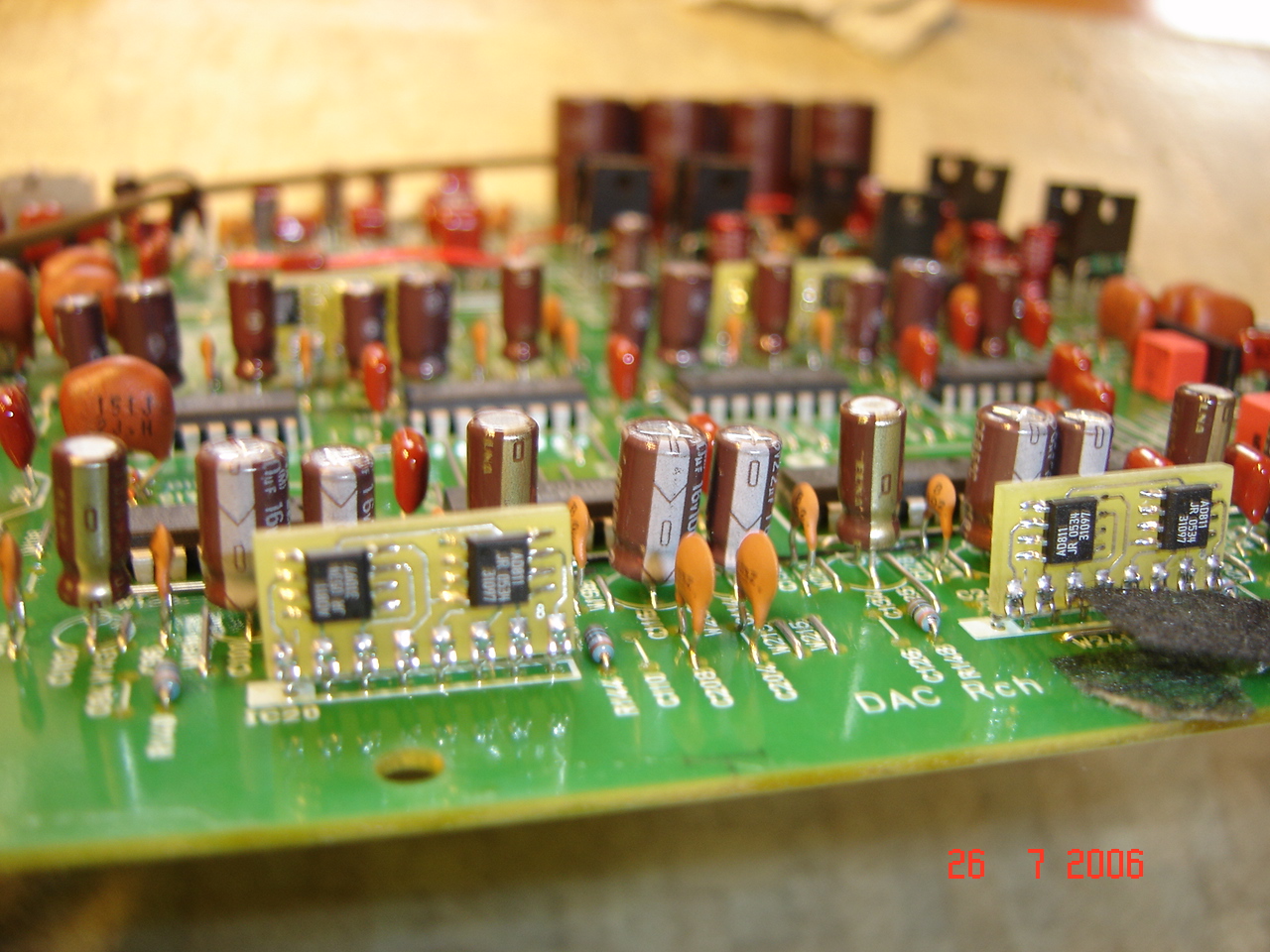

OK, Russ, I understand. Well, here is my integration of Buffalo24/Legato into Adcom GDA-700 DAC. As Ultraanalog chip inside Adcom was broken I'm decided to make this exchange. This is not the final version, I'm also tried transformers as I/V but Legato works very well to me, just have to increase output level up to 2 v. So that's why I'm posted "summary' to make all changes before final intergration.

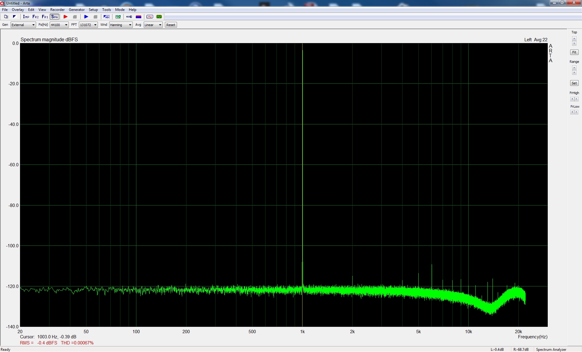

I have measured the SE/BAL output THD @1kHz 0dBFS , and the this is pretty awesone, 2.H is below -111dB 3.H = -107dB
I use the ASUS Xonar STX as my analyser card (Input THD+N at 1kHz:0.0002% /-113dB for Line-in)

FFT plot of my Kenwood + Modified Legato2
Here is a FFT plot of a 0dBFS 1KHz sine from my Kenwood DP7090 with 2x4 PCM1702K and a modified Legato 2 I/V stage, run from a +/-12V battery supply.
Pretty amazing THD of 0.00067 %
And it sounds amazing too !!

Thats not bad at all.
It not quite as good as the standard (ESS) config because there is not enough current through the devices. But those are still very nice numbers.
Thanks for posting the success!
You are actually running the current pretty low. If you are not using the BAL/SE section of the Legato you can increase both it's CCS current and its working voltage (say up to +/- 24V) . This will get you somewhat better THD in the config you are using. You actually only need to increase the positive rail, the negative rail could stay the same, just adjust the current to bring the static bias voltage at about half the positive rail.
You can also increase R5 about double because you are running so little current.
Good work!
