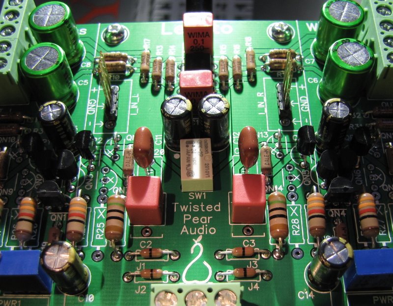

looks excellent. this build is an excellent excuse to get out your whackiest looking NOS polypropylene caps the juxtaposition between high end modern SMD and old world whackiness is superb!! but its all about the sound of course anyone looking at possibly using the linear systems stuff? I agree active devices are an excellent opportunity to play with the sound as well. especially in a reasonably simple/elegant circuit, it is a good opportunity to hear the differences in everything really, with such resolution to back it up.
The trimmers simply set the input bias. Start with them at about mid point.
Measure AVCC at the buffalo II.
Then adjust the pot on each side until the BUF-II outputs are at AVCC/2 (The exact value is not terribly critical so don't sweat it)
It's actually quite an easy project.
Cheers!
Russ

Well, I like the appearance of the board. It looking cool.
I even think I'm going to mount it - now!
Nice and tidy build.
If you are going to be listening single-ended, can I suggest that you swap the op-amp you are using for a LME49720HA (the metal can variant). A subtle but worthwhile improvement can be had by doing this. I've found this several times, in headphone amps and also in the ballsie for my B32S.
