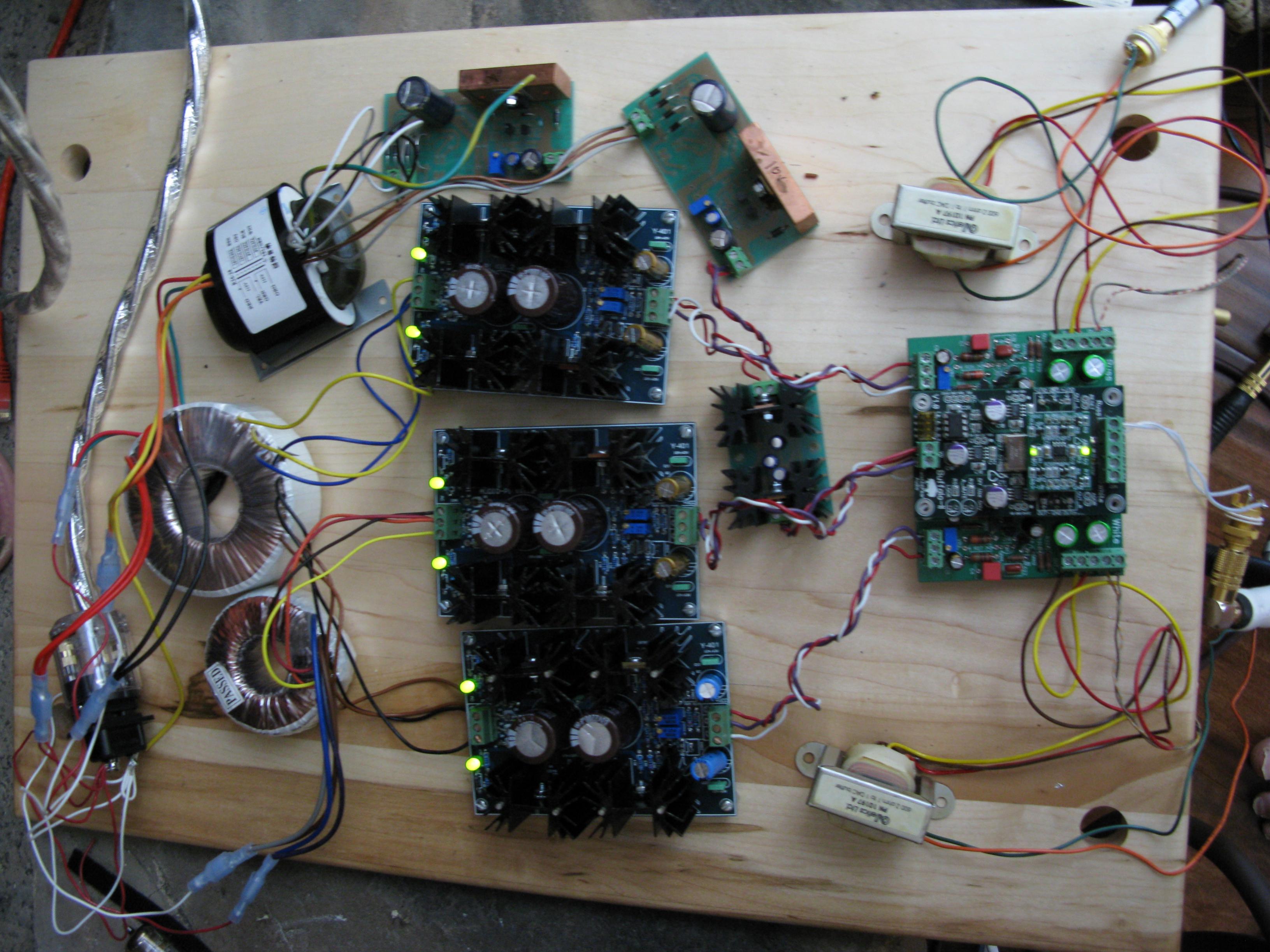

Clearly not optimized but here is my Buffalo/Legato combination. I am using the Ballsie and a pair of BudP Onetics transformers (balanced to SE). After about an hour of listening through each I can say I am very pleased. It is going to take some serious sound time to see if I favor one over the other. I also want to implement the rest of my Paul H regulators.
Best
Bob
Thanks Russ and Brian
