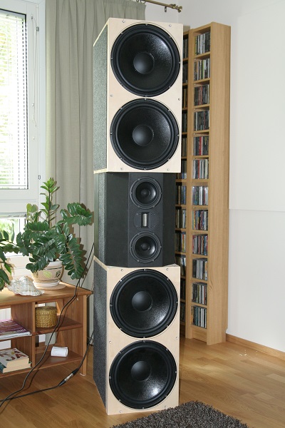

This difficulty to make speakers fit the room and sound right comes mainly from the dispersion characterics being uneven. This is a problem for many large high-end fullrange speakers. It is very difficult to combine high directivity, high output with low distortion and short listening distance, less than 10' (3m). I do not have proof but I believe that eg. Linkwitz LX521 and Kreskowsky's Nao Note have high distortion when played at home theater or rock club sound levels. They are not even meant for that.
Here is a cardioid speaker that obviously can produce lots of clean sound too! By Kimmosto but not documented on his website DIY Loudspeakers Kimmo Saunisto
