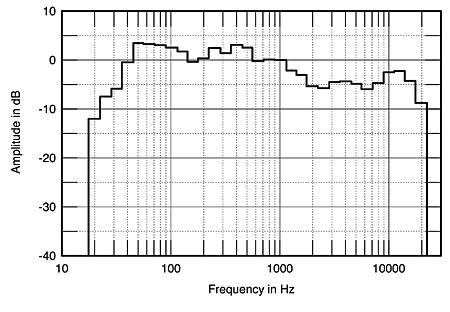

Here is an older variant of the Whisper:
Legacy Audio Whisper loudspeaker Measurements | Stereophile.com
Pity there is no lateral response plot. :(
..like the Watt/Puppy though, the defining characteristic of this design will be those mid-woofers and their reaction to the baffle. In particular you'll hear a lot of "baffle" with this design, which would make it a good candidate for that thread on speakers that sound "BIG".
Old Whisper's 0-30¤ averaged response shows lack of power 2-4kHz and boosted highs - exactly or even worse that was expected by layout and xo (last link of Scott)

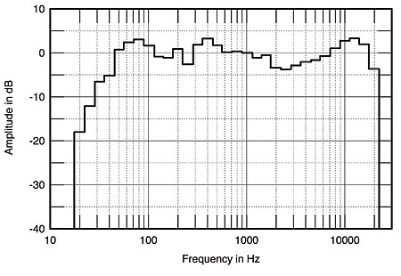

Stereophile liked this "modern" speaker very much and it measures like this:
Vivid Audio Giya G3 loudspeaker Measurements | Stereophile.com

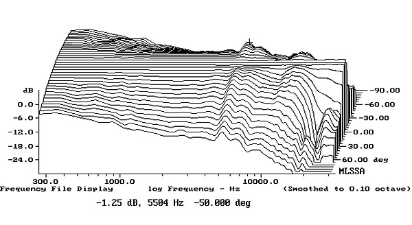

And this is their room response measurement of a waveguide speaker (red) http://www.stereophile.com/content/yg-acoustics-sonja-13-loudspeaker-measurements
When I browse Stereophile's measurements and compare them to speaker layout, it is very difficult to see any kind of correlation. Commercial designs (even high-end) seem to have special voicing built-in. For examle a double-bass speaker has boosted bass vs. to it's single-bass sister. Waveguide 2-way vs regular 2-way usually have a difference. 3-ways can be anything. There are also simply terrible speakers around like this http://www.stereophile.com/content/zu-essence-loudspeaker-measurements
Note: what I was referencing before was only the "listening position" measurements you displayed.
The problem with the "listening position" plot (and comparisons generally) is that there is no real "reference" - that grouping of positions, and most particularly the distance from the loudspeaker (and the loudspeaker's distance from walls), is unknown. In other words the listening position might only be 2 meters away in one example, and 4 meters in another example. Really, it's only there to give an idea of the freq. balance that subjective reviewer is experiencing (to better understand their impressions within the review).
My strong suspicion with the Whisper "listening position" plot is that the listening position is considerably further away from the loudspeaker than what you might see in other "listener position" plots.
Also note: the "waveguide" for the YGA speaker doesn't result in a great deal of pressure loss at even 60 degrees off-axis (or 120 degree window) when compared to the Vivid Audio loudspeaker (up to 8 kHz or so).

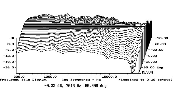

YGA Sonja is mtm with waveguide and has excellent constant directivity. Giya is very smooth but has different profile (rising directivity), since it does not have wg.

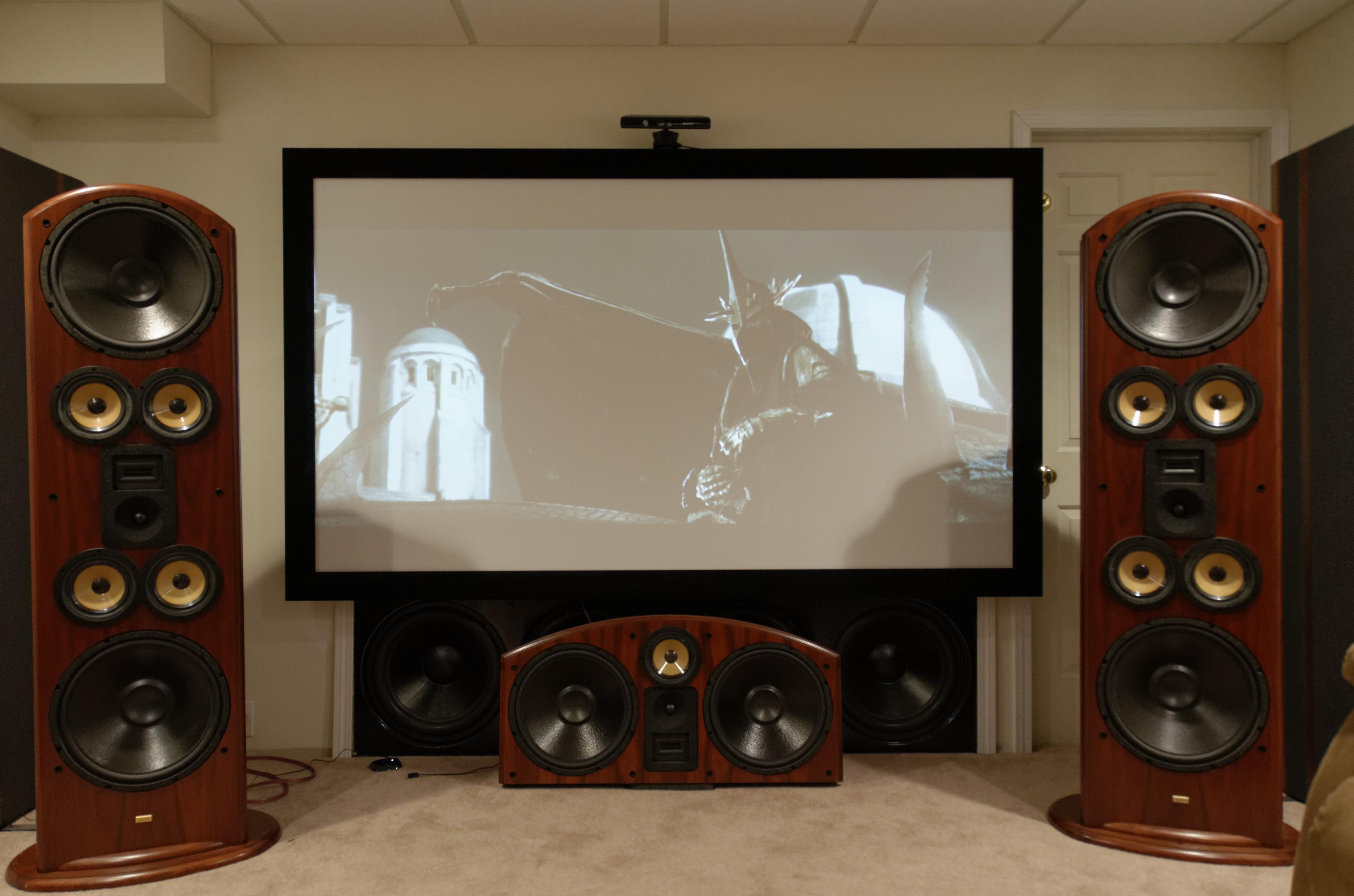

So, I have the Whispers
I have the Whispers and thought I would share my experiences with them at home and at audio shows.
My Whispers
I believe all the stuff like cardiod, nulls, interacting less with the room are marketing talk and Legacy should stop emphasizing that so much. It stretches credibility. They also have it so practiced that is sounds too rehearsed. The Whispers are so different from any other speaker they get asked hundreds of times a day on the design. The conventional wisdom is that the Whisper must have terrible comb filer, and phase coherence issues with all those drivers. Well I have measured mine extensively and the phase response appears great. The speakers completely disappear like they have nothing to do with the sound. I thought it was a crazy stupid design until I heard it in at good room environment and I forgot about all that conventional wisdom. Somehow Bill has tuned all those drivers to work together. The Stereophile review from a while back says the same thing. Legacy Audio Whisper loudspeaker | Stereophile.com
My whispers at home sound better than 99% of speakers at audio shows and 10x better than Whispers at the three audio shows where I have seen the them demoed. I would never have bought the Whispers if it was my only experience with them. It seems they really don't put effort into the placement of the Whispers for the shows. They just seem to plop them down at the sides of the table with no toe in. They put them too far apart, not angled right, not far enough out in the room. I just don't understand it. Dipoles are notoriously hard to setup right. 1/4 of an inch makes a difference. I think they should optimize for 6 seats and the show and make people sit there for the whispers. Instead then always get a big room with 20 chairs and it sounds so-so to my ears. They are indeed unbelievable speakers, but also hotels are HORRIBLE places to listen to speakers for many reasons and Legacy is not dealing with it and turning away discerning people.
Whispers were designed and tuned to have substantial toe it. More than any speaker I have seen. Bill tunes them while they are directly pointed right at him. He actually recommends crossing them over in front of your face.
The bass....It's dipole bass. Very low distortion, very quick, very subtle. You can tell if the drum is strung tightly type of bass. Problem with dipole bass is that it does not have the solar plexus punch than a woofer in a box does. That said, every time I listen, I am still very surprised how much bass it puts out for open-air woofers. It just does not seem possible. I listen both with and without subs.
The reason I have the Whispers is because they combine all that I love about speakers. I had Magnepans and loved the super quick ribbons and dipole sound stage. I had Martin Logan Odysseys and loved the super quick electro-stats and dipole sound stage. They did not have bass impact and could not play loud for home theater. Whispers have the ribbon quickness and air, the ability to play at rock concert levels, the dipole soundstage, and the non-boxy sound.
Audiophiles come over and can’t believe the sound that comes from them. I usually leave the grilles on until after they have listened to them a while and then they freak out when I take the grills off and ask the same questions as you hear at the shows – I just say – hey….. it works doesn’t it?
So Legacy must have done something right with their design……
