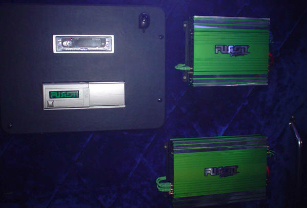

Hi Bull
Have you had a fusion amp?
I like the look of the audiobahn gear but only the big stuff is any good am told, The fusion is not really a big hitter, and the speakers are just not that good am told.
Have you hear or seen the visonik amps, there speakers are rubbish but the amps seem to be doing well on the SPL market, not that i care for that, as i like my hearing! who do you think has the best Value amp, the biggest bang for your buck!? and JBL's GT6000 just dont count, that cost more than my car! somthing under 2K ok!
