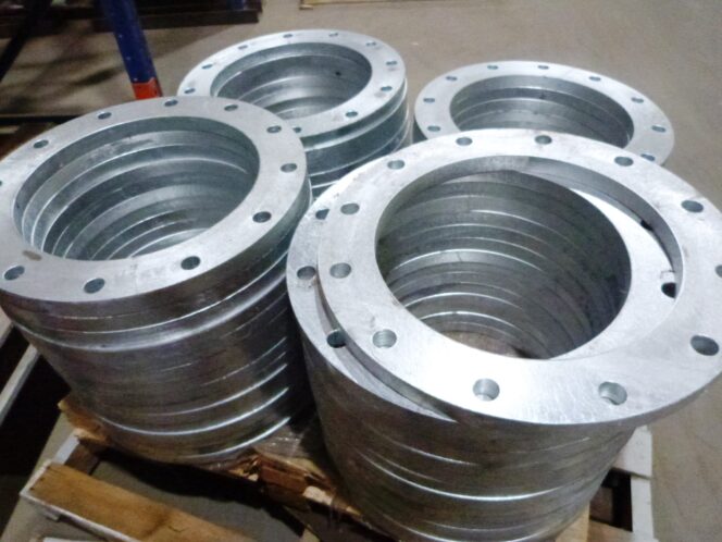

If i could find it i would try very heavy steel backing rings bolted on the woofer basket
https://www.acu-tech.com.au/wp-content/uploads/2018/07/Backing-Ring-664x498.jpg
just to add mass

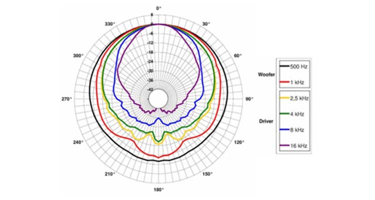

Hi ! thanks a lot indeed I have seen some polar graph in the web
https://www.researchgate.net/public...a-commercial-loudspeaker-Visaton-WB-10-11.png
the dispersion up to 500 Hz is almost spherical
I see many many totl speakers from various brands using the scheme you mention

I wonder which could be the frequency upper limit that can be set ... i am looking at this
https://www.ravepubs.com/wp-content/uploads/2021/11/loudspeaker-1.jpg
the 180° dispersion at 500Hz looks to be at -3dB respect to on axis ? better to stay lower than that ?

i have looked at some polar dispersion graphs and i saw that at 500Hz the dispersion at 90 degrees is down of just - 3dB
