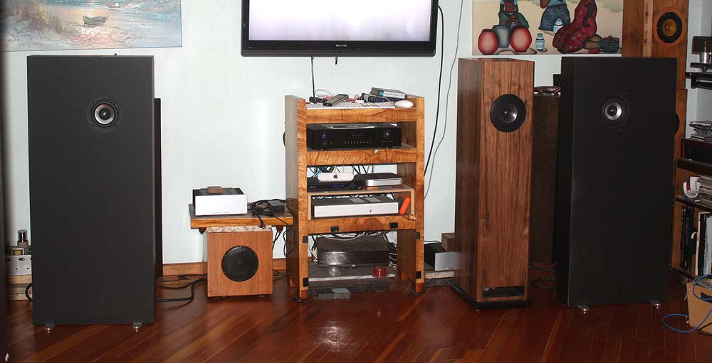

But then why all subs are so heavy ?
Because the drivers are heavy. In my push-push SDX10 woofers, one could use 2 fingers in a driver cutout can lift the box (15mm BB), add the drivers and you really would like 2 guys to carry it.
dave
