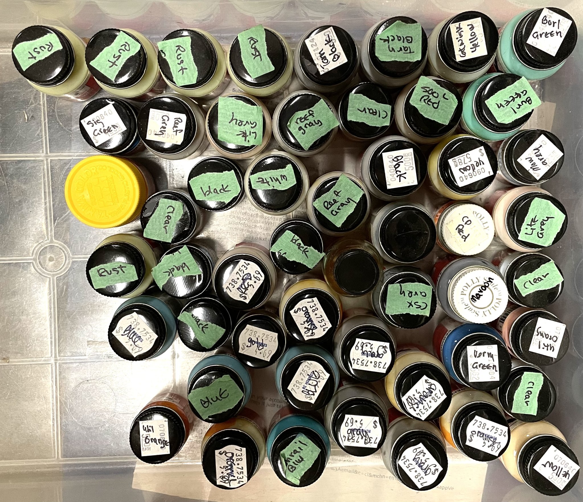

BTW: i have a drawer full of new paint in a variety of colours i will never use. I am happy to ship some of that excess anywhere for cost of postage (likely max $13 USD (unless you are in Canada). Value of 3-4 bottles would exceed the postage. 3 bottles probably does tens or more drivers.
Can I Dave?

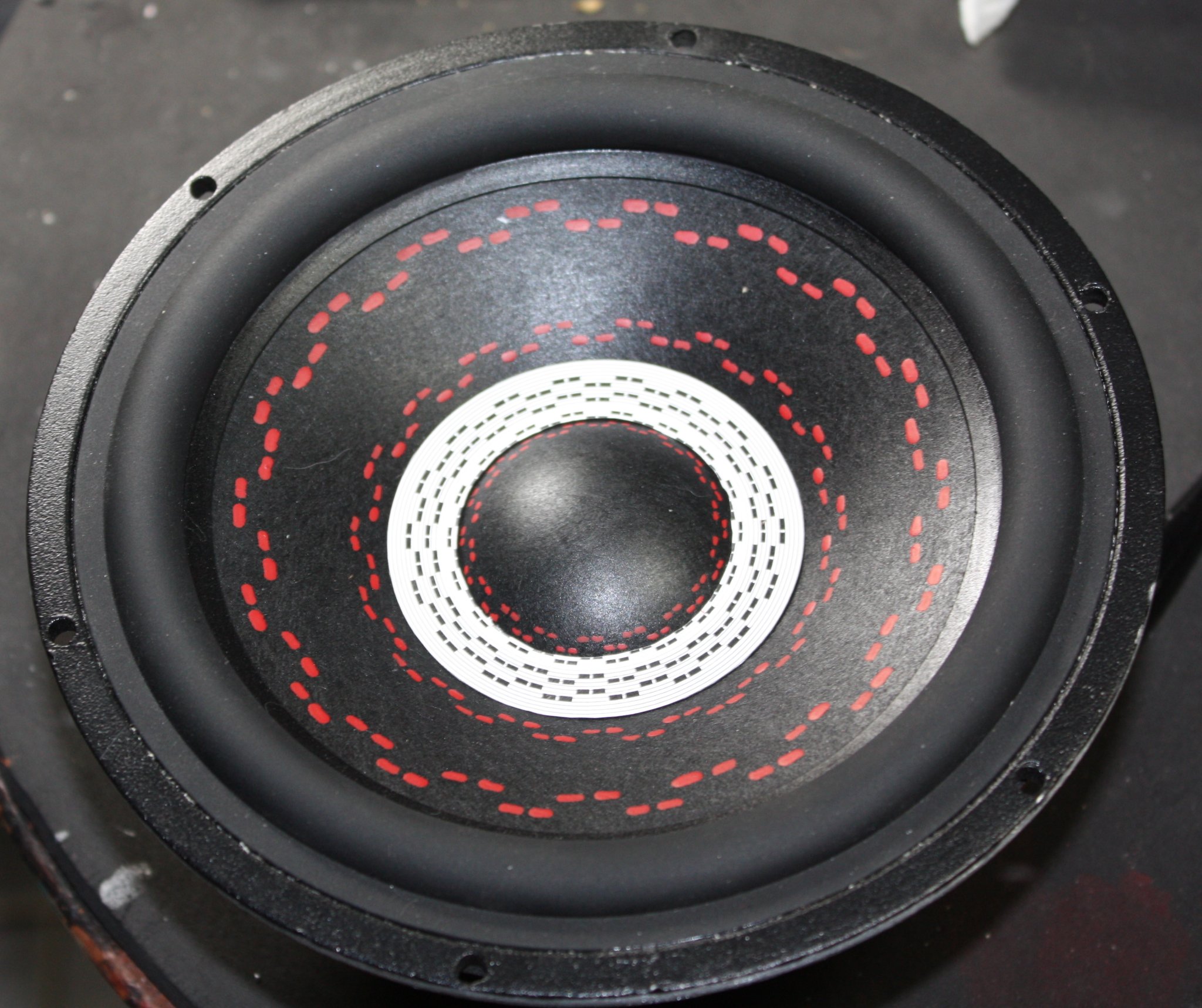

... which is where?in the specific case of the Markaudio cones there is a ringset at the junction between the curves Mark used to shape the cone

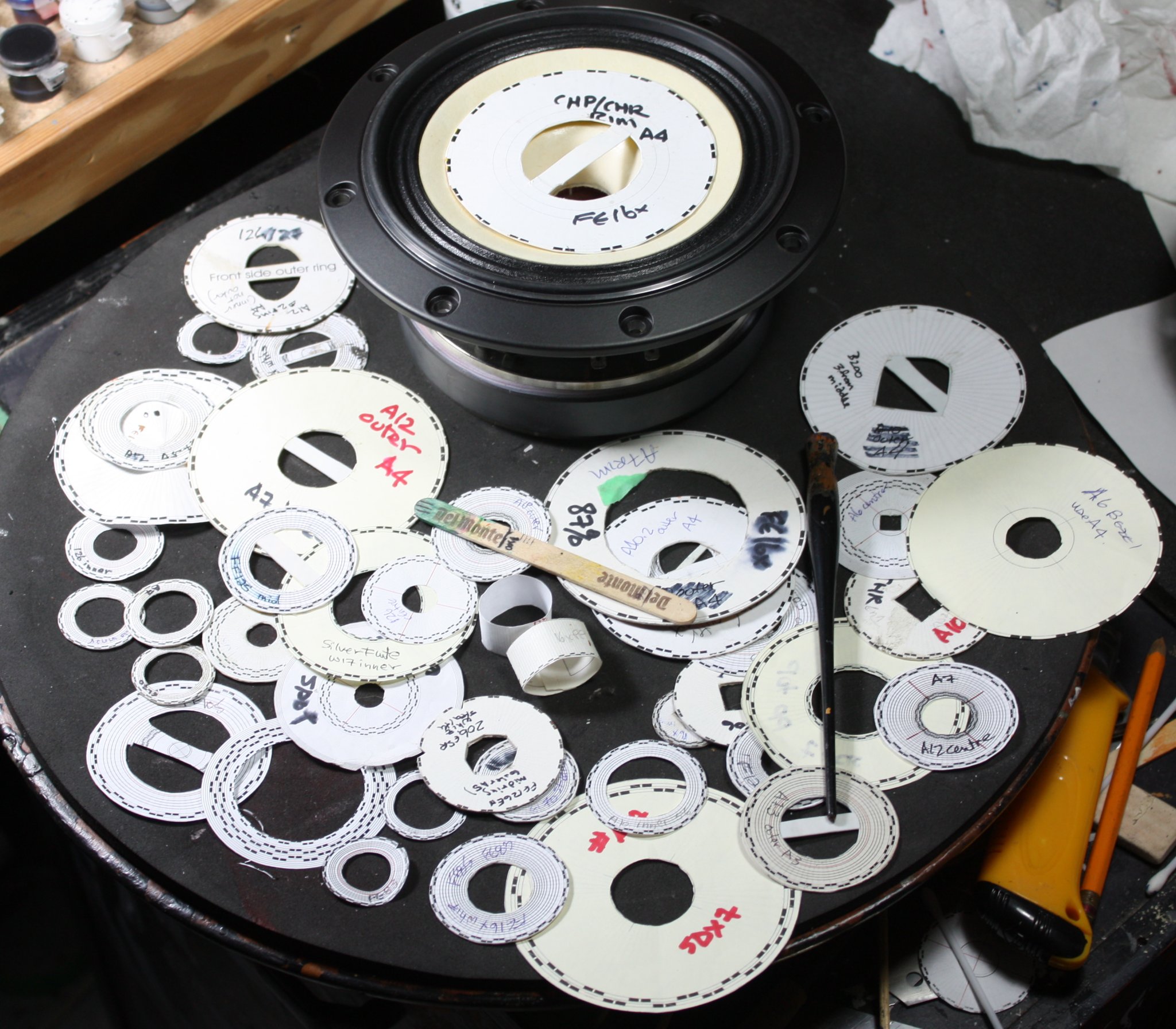

Using the templates... do you cut the paper just short of where you want the line of paint to go -- maybe 1mm or so so that the paint doesn't get sucked under the paper. then cut it again for the companion ring?
then repeat for the next set of rings at the next intersection of curves for the cone?
Do you use the A style nibs to "stamp" the dashes like the lay a trail of footprints in the comics?
... which is where?
You are going to have to wait till i get my templates out and measure them.
Here are some pictures i dug out of templates and how they are used.

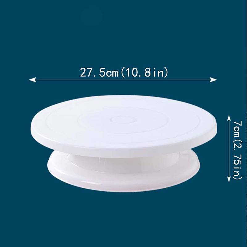

I've bought this item usually used to decorate cakes: Rotating Cake Decorator on Temu that seems useful to EnABL speakers.
