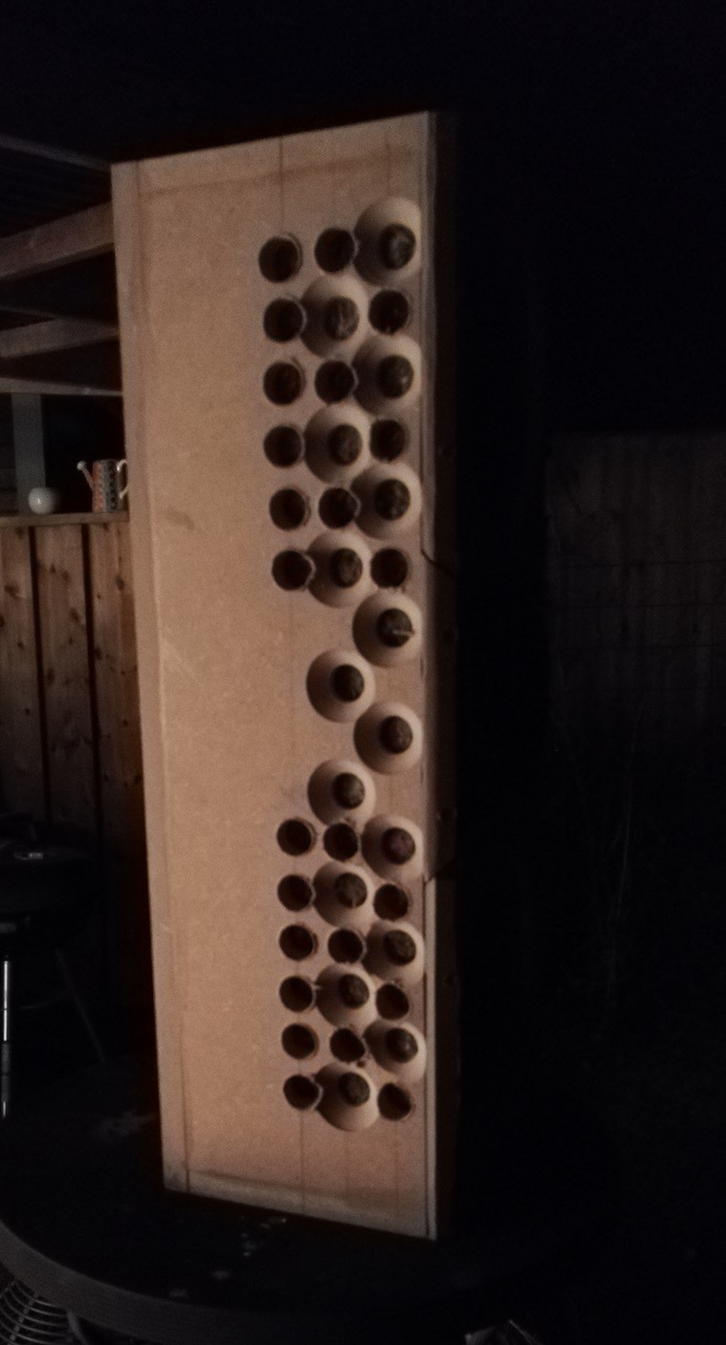

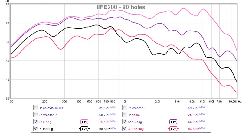

I've not done any polar measurements with the 8FE200 yet, but with the 5" drivers I used initially there is some serious difference between no holes:
and 56 holes:
I'll make measurements soon.
/Anton
24 more holes drilled (now 106 % Sd):

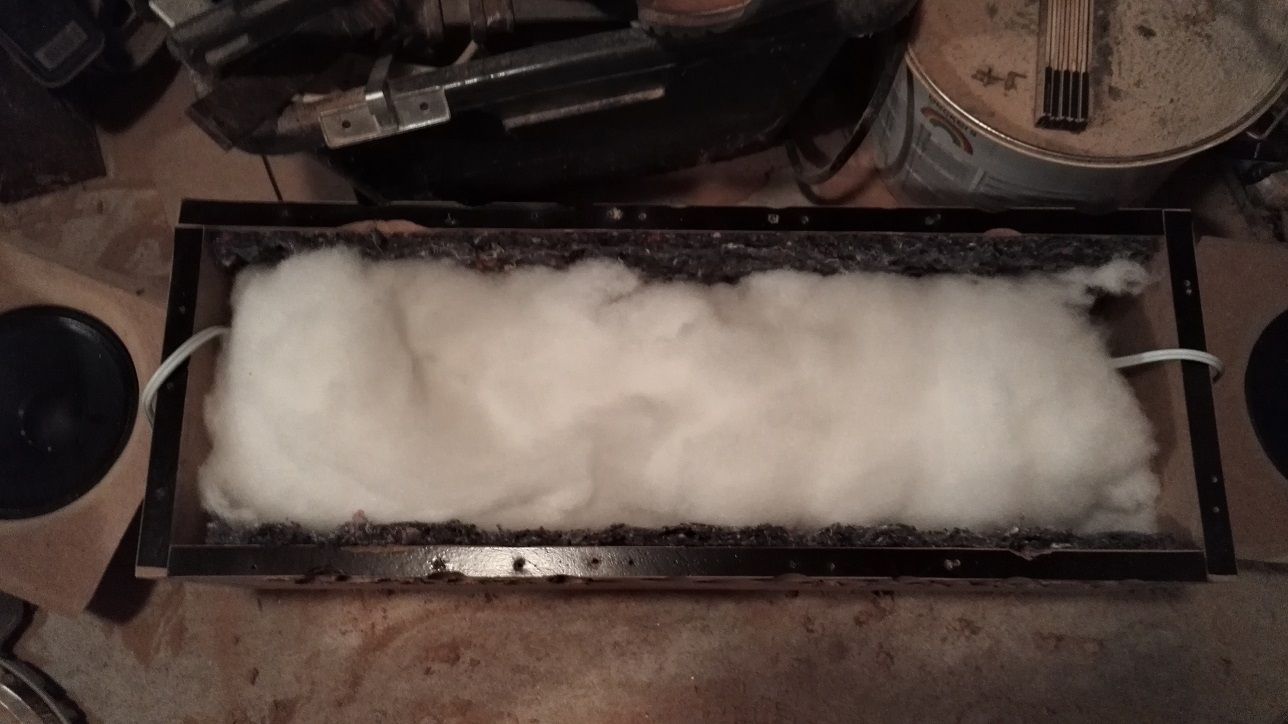

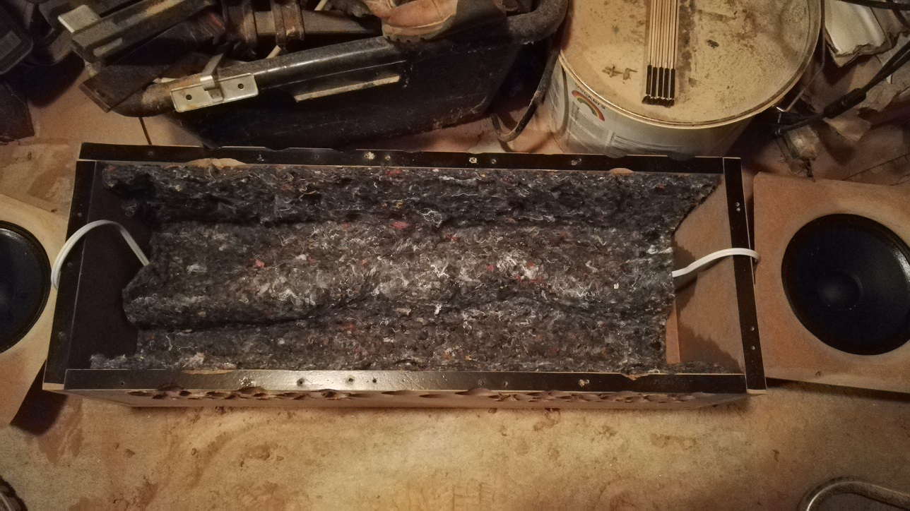

Cotton fabric (flow resistance) is stapled to the MDF:
I then added polyester stuffing:
Resulting response:

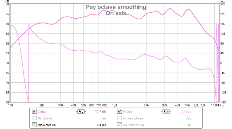

Note that I've expanded the figure to cover 100 Hz-10 kHz (instead of only 100 Hz-2 kHz). Psychoacoustic smoothing, no gating, 1.5 m distance, 1.5 m above ground. I didn't have time to take as many measurements as I've done earlier due to my kid having fever.
On axis:

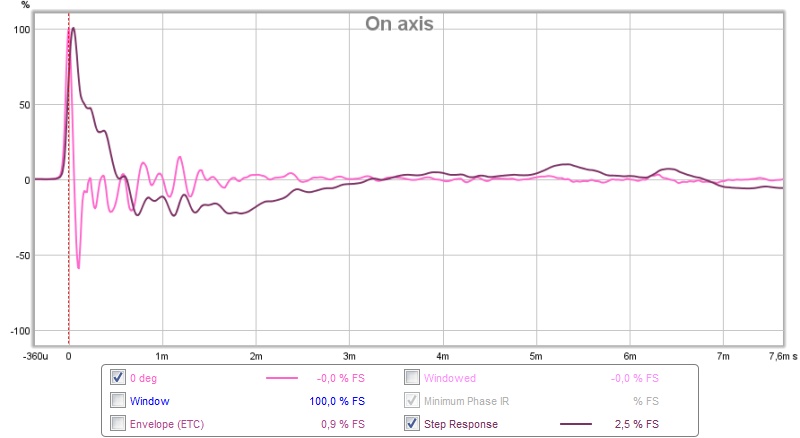

Impulse response:
There is some ringing at ~4.5 kHz. Shouldn't be a problem as I'm planning to cross over below 2 kHz.
Are the holes too close to the baffle? Should I make a new test box with the holes moved backwards? I feel the rear-mounting combined with holes very close to the baffle might be less than optimal.
/Anton

The smoother response might be due to the fact that I changed the material in the box from egg-crate type:
to glassfiber and polyfill:
/Anton

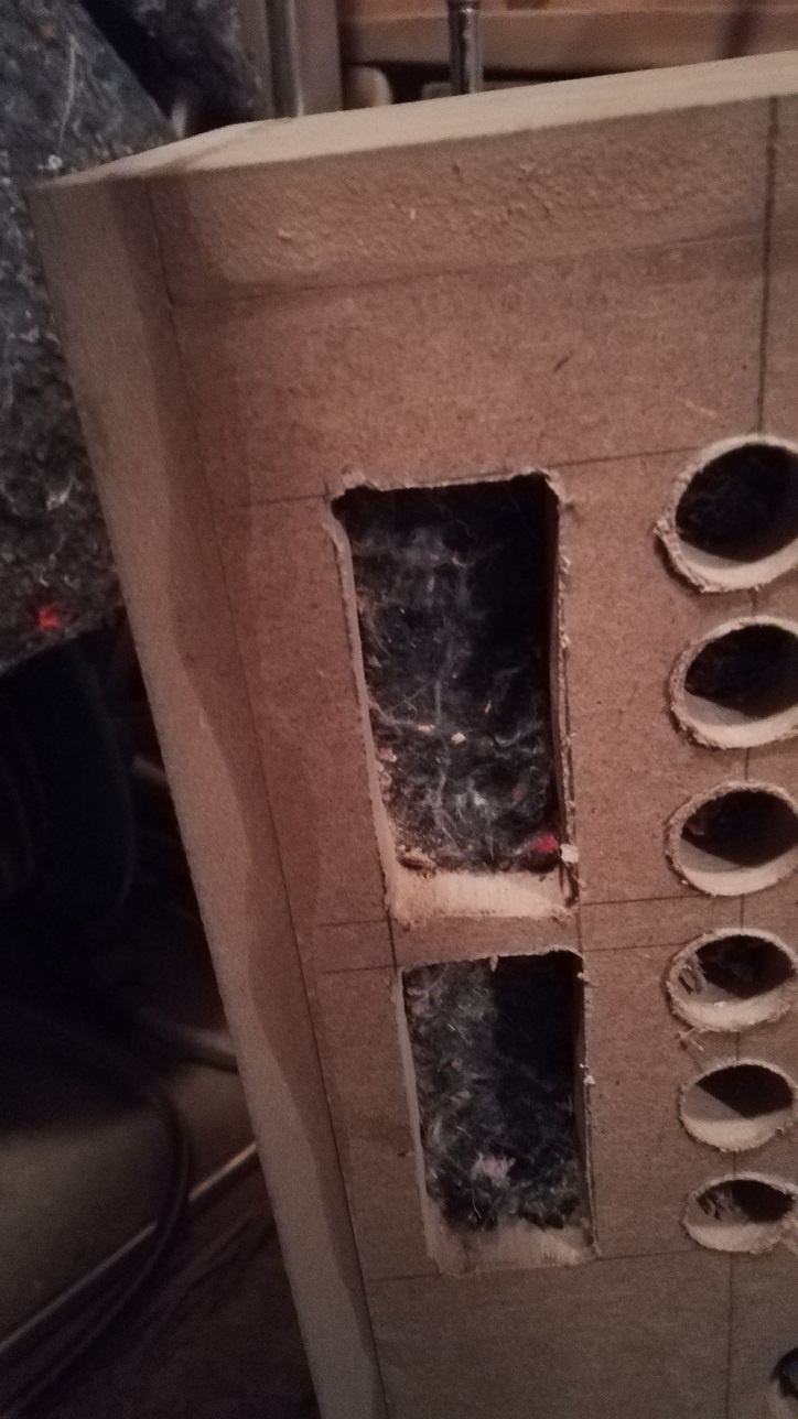

Now I've made more holes:
4 rectangular 90 x 40 mm holes/side added for a total leaking area of (405 + 4*(9*4)*2 = 693 cm^2 = 181 % total Sd) 181 % of total Sd.

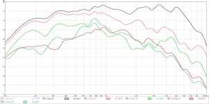

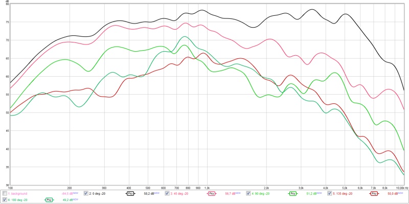

Horisontal polars (0, 45, 90, 135 and 180°):
Compared to earlier, 106 % of Sd (180° measurement missing):
Low end separation has improved slightly.

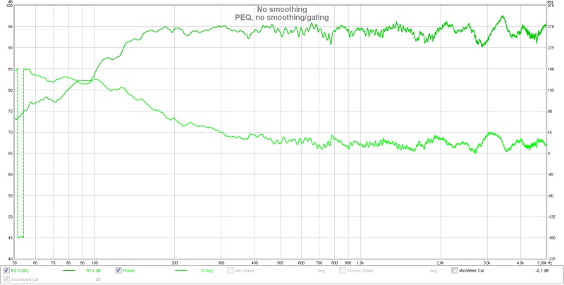

On axis response after EQ (minidsp):
No smoothing or gating.

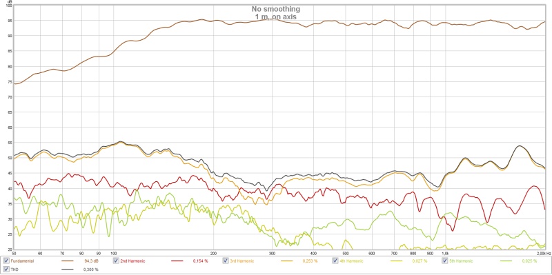

Distortion at 94 dB:

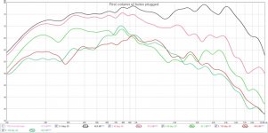

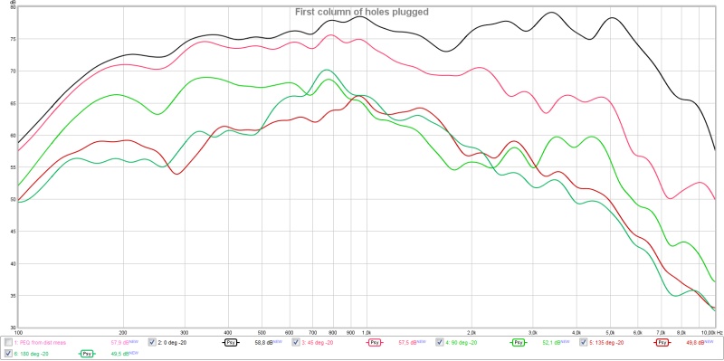

I then tried plugging the first column of holes (closest to baffle) with foam:
Slight improvement, maybe I need to close the holes off with wood. I'll try this.
/Anton
