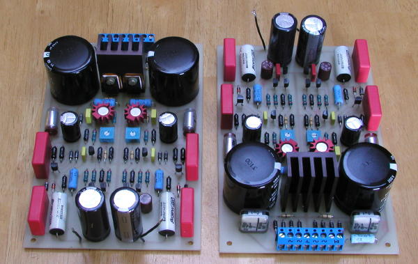

I've buit that regulator and was using them in A-75 front end. Still have the pictured boards, if someone is interested, they are for sale.

Peter Daniel said:I'm selling complete boards, $50 a board.
They can be adjusted for wide range of voltages, the ones in picture are set to 50V DC.
Please email me so we can talk : O ) about this board.

I didn't realy compare this reg to any other, so it's hard for me to comment. However, A-75 sounded really good, may be in part due to those boards?
I was never using a voltage doubler, and I've built 3 sets of those amps.
Pretty good regulator, I should say...
Is it somehow possible to get your board layout/schematic (if it's not also for sale)? My amp just happens to require 50 Volts
