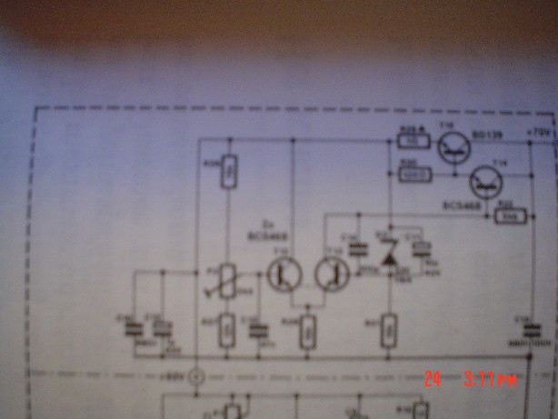

Number two, simple regulator from a fast Elektor amp.
This one is for 70 in, 60 out.
For a higher voltage and current rating :
The BD139 could be swapped for an MJE15030.
The BC546 by MPSA29 or MPSA42, up to 100v in preferably the 29 because it has an Ft of 125 MHz.
3 resistor values altered, and a zener diode.
(could not get a good fix with the light, can scan this one and post a pdf)

Thats funny, the ML pic looks like an active voltage regulator to me.
Even the voltage entries and levels are there, 87 volts in, 65 volts out.
Maybe i am getting old, i even see the regulated and not regulated outputs mentioned on the circuit.

But it’s not designed for anywhere near the current we’re talking about. It could only drive the front end. Now that I have looked it up the same is true about the “fast Elektor amp”.
It’s like suggesting that a Childs wheel barrow could transport a 10ton block of steel. Yes it will fit inside, but no it’s not going anywhere.

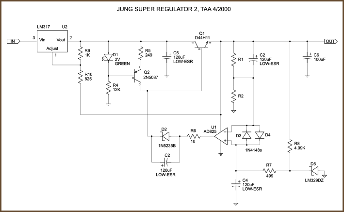

http://tangentsoft.net/elec/opamp-linreg.html
In the 4/2000 issue of Audio Electronics (successor to TAA), Walt Jung published a new version of his regulator with several improvements over the 1995 circuit:
http://tangentsoft.net/elec/misc/diy-series-linregs.pdf
