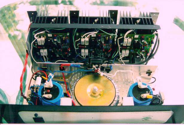

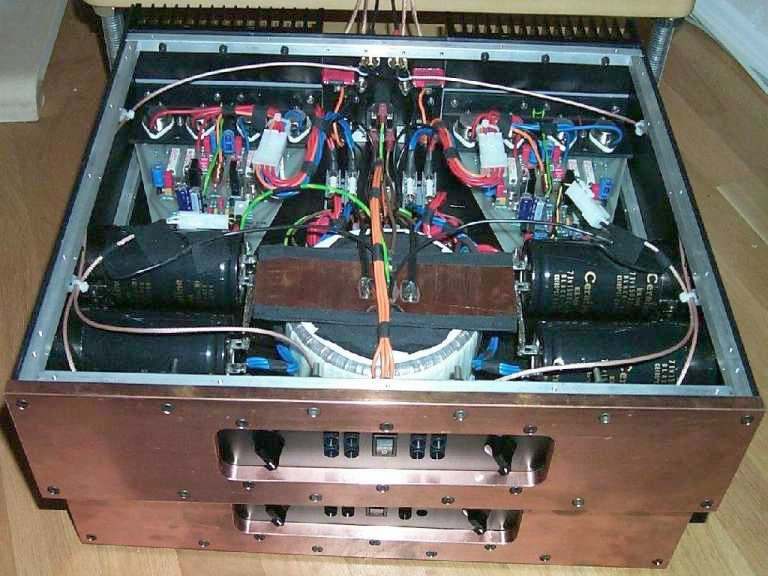

acenovelty said:Wiring?
Are the output transistors or are the output transistors not on the PCB in this pic?
Second pic. The wires are the white things connecting the PCB to the output transistors
\Jens
If the wiring were really such a big deal sonically, the builders of these amps probably would have noticed.
Other than the work involved and attention to detail, seems this is not really a problem.
