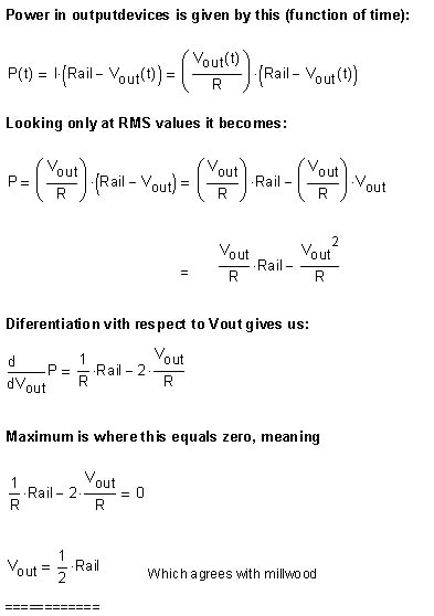

Jens, maximum power dissipation is at 1/3 of full power (class B stage) , assuming ideal parts.

As Millwood pointed out, for DC the maximum power dissipation in the output stage for class B occurs when the load voltage is Vcc/2. For this case, the maximum power dissipation is Vcc*Vcc/(4*RL).
For the sine wave case into a resistive load, the maximum power disspation occurs when the peak load voltage is 2*Vcc/pi. For that case, the power dissipation in the output stage is Vcc*Vcc/(pi*pi*RL).

I didn't follow andy's notation closely. But there is a much simpler way to figure the maximum average power dissipation on the devices in half cycle (assuming perfect devices).
the peak drop on the load R is Vcc (rail voltage). so the RMS value of output voltage is Vrms=Vcc/sqrt(2), and RMS current is Irms=Vcc/(sqrt(2)*R). and the power dissipation on the load is Pl=Vrms*Irms=Vcc^2/(2R).
from the power supply's point of view, it is providing a steady rail voltage of Vcc, and a sine current whose RMS is Irms=Vcc/(sqrt(2)*R). so total power provided by the power supply is Pr=Vcc*Irms=Vcc^2/(sqrt(2)*R).
the difference between Pr and Pl, Pr-Pl=Vcc^2/R(1/sqrt(2)-1/2)=Vcc^2/R*(sqrt(2)-1)/2=0.207*Vcc^2/R, very close to sajti's figure.
Note that this is the AVERAGE power dissipation on the output device. At some point, power dissipation on the device can be higher or lower than this figure - Jens and I provided the true Maximum power dissipation that the device may have to dissipation at an instant, not an average.
If you size your heatsink with the calculated figure above, and you feed the amp with a low-frequency signal (like a DC signal), the amp may overheat.

I believe 1/(2*pi^2)=1/(2*3.1415^2)=1/(2*9.869)=1/19.738=0.0507.
you arrived at the right figure but your formula didn't work out correctly.

I made a huge mistake
0.2027=2/pi^2
I use this formula long time ago, but I learned in the high school so I dindn't remember exactly the source of it.
The Pdmax=0.2*Vcc^2/RL is sure, I planned the heatsinks for all my amplifier with this figure, and all works properly
My current project will use 4pairs of MJL21193/94 with regulated +/-40V. The dissipation will be 5W/device with 8ohms, and 10W/device with 4ohms.

This sounds like your numbers and mine are making sense now. I wasn't careful about defining which power dissipation I was referring to. My formula is for half of the output stage. So to get the dissipation in a single transistor, you would divide my number by the number of output transistors in parallel - two for the Leach amp. It looks like yours is for the whole output stage, so for the Leach amp you would divide by 4 to get the dissipation per transistor - giving the same result.
