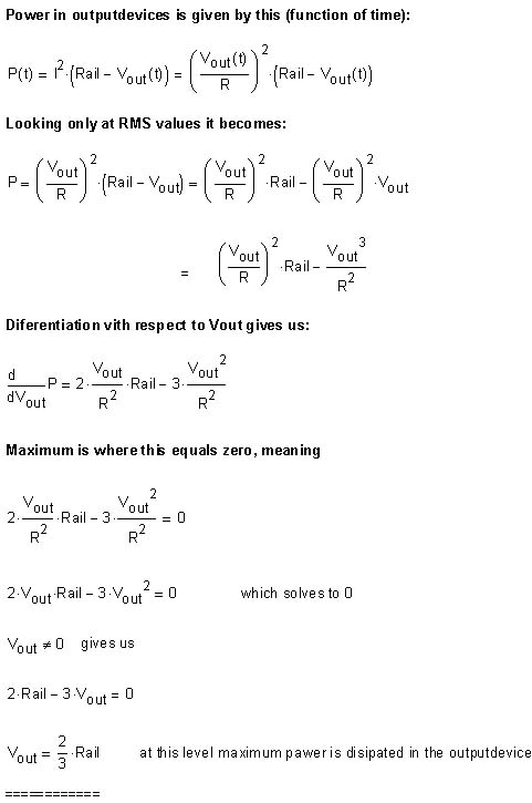

Re: Power in outputdevices
Jens: why is P=I^2*V?
JensRasmussen said:Correct me if I'm wrong
All this talk about maximum power in output transistors confused me, so I tried this:
I that wrong?
No DC current in the devices is taken into the equation
\Jens
