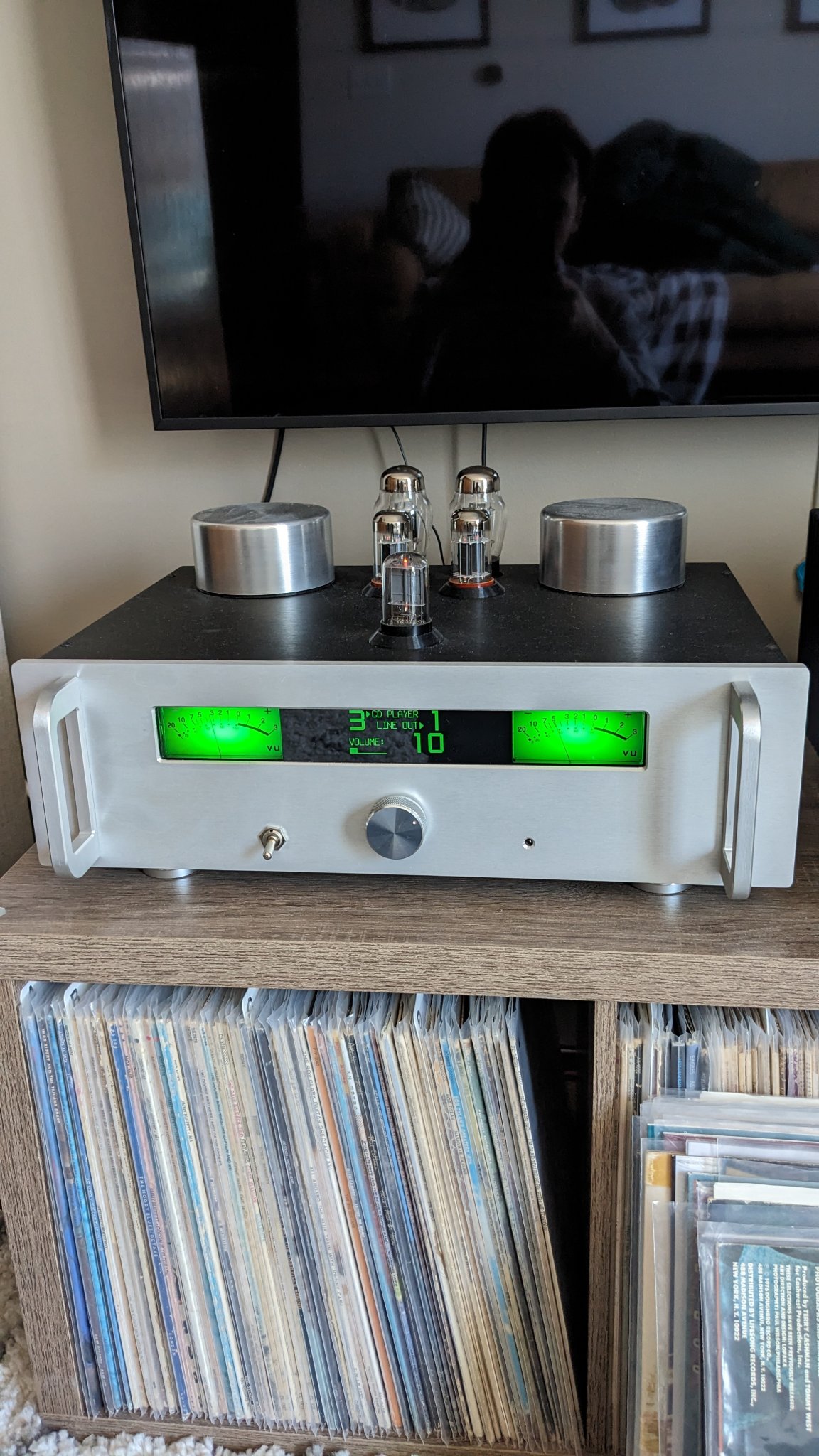

Just a Galaxy u3 with a Milled front panel
