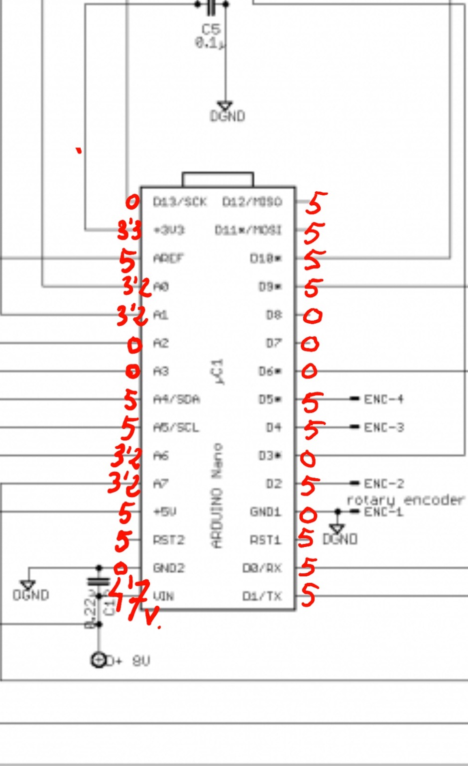

Upload i2c scanner sketch and test the i2c response of your display. I believe display was working before? Is it the same behaviour now with both Arduinos? I remember someone on the thread having the similar issue, something preventing Arduino to boot at all, causing black display and no relay clicks, I don't remember what the solution was.
SDA and SCL both have pullup resistors, so 5V is normal, unless there is a data flow.

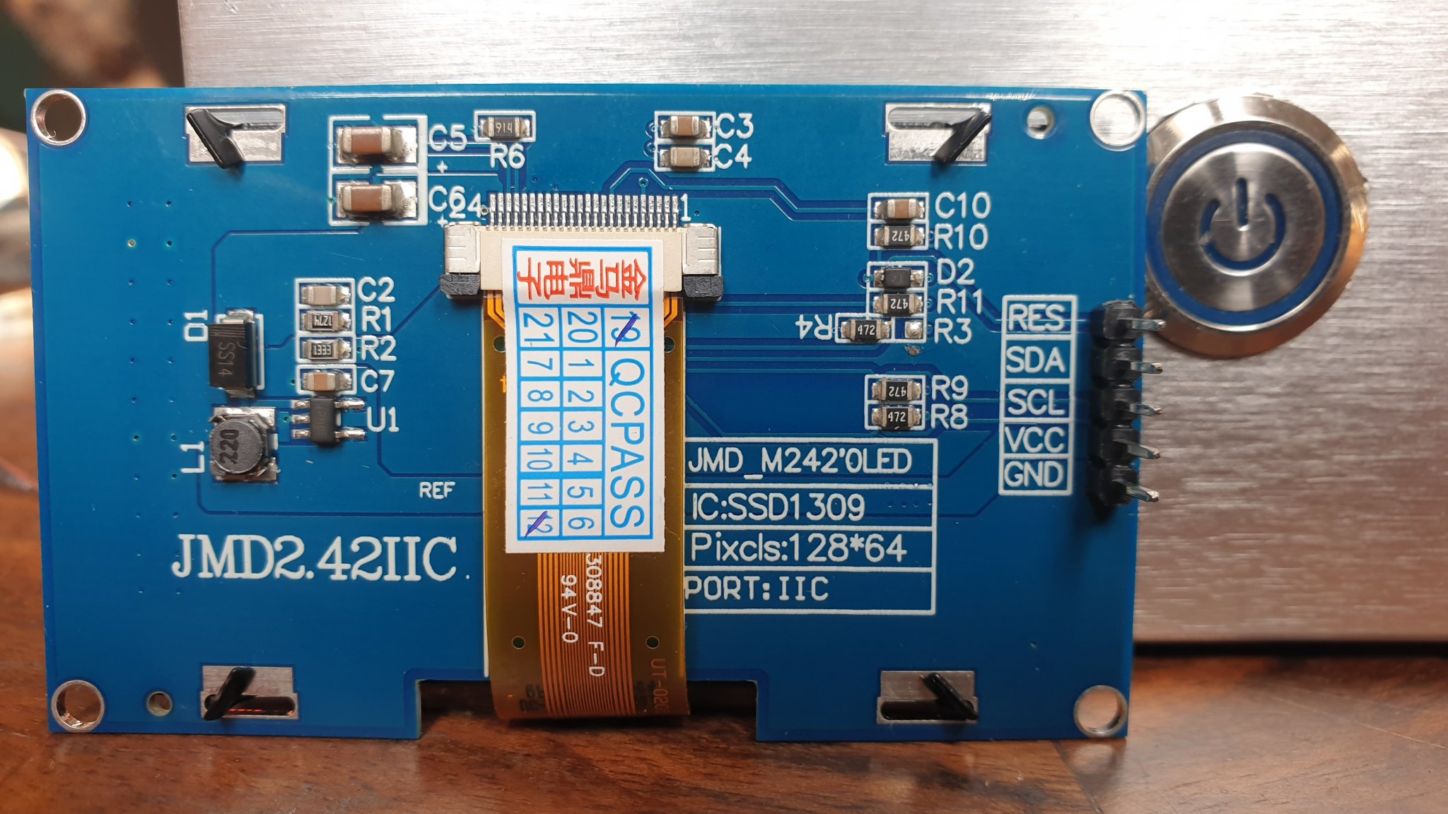

Hi, I solved the issue by replacing the oled display. Now still is ERROR 20, so I continue troubleshooting, but somewhat relieved, as relays are clicking and Nano is alive.
Atch. is my Oled display, maybe of interest, as this SSD1309 variant, not seen it posted here already, and works without modification. Bought it long ago by the way.
