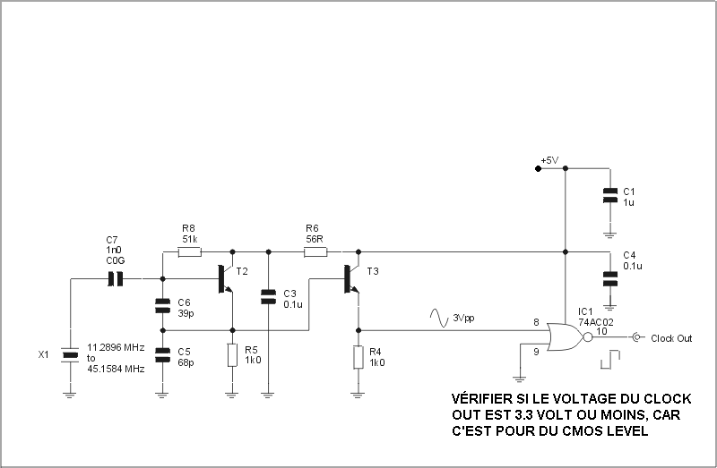

Interesting clock schematic.
About the LClock 2 / C2 schematics.
In that schematic it use a 74AC02, can I replace it by a MC74F02 ?
It have quite same propagation delay specs.
The BFR92A transistors in this schematic are a 5 ghz type, can I use a much lower frequency transistor, any transistors you can suggest ?
Thank
Bye
Gaetan

Hi Gaetan
Sorry i didn't see this thread before.
You should use a 74AC type, as the F type would load the oscillator too much on it's input. Today we have even better types, like the NC7SZ02, a single gate type with very short connection from power pins to the chip.

Hello
I can't have the 74AC type, but I have the 74VHC04, can I use this one ?
Thank
Bye
Gaetan
Hello
Here is the schematic I would use.
Thank
Bye
Gaetan
