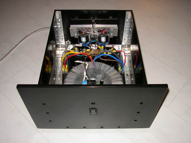

Zappulse 2.3SE
Hello,
I build a bridge zappulse 2.3SE monoblocks and the results are poor no more depth and no details in the music they are gone.
Before I had the Zappulse 2.2SE (no bridging) and they sound very good.
What is the reason that the sound aren’t open, the scheme I took is from the Zap 2.2SE cookbook.
Please can anybody help to get a better sound with my bridge Zappulse 2.3SE.
1 Monoblock:
1 x Amplimo ringkern transformator 2000Va 2 x 42 Volt.
2 x 47.000µF 80 Volt type Mundorf M-Lytic HC.
Here you see the pictures of my amplifier: http://www.htforum.nl/yabbse/index.php?topic=17055.615
Greetings,
Rudy

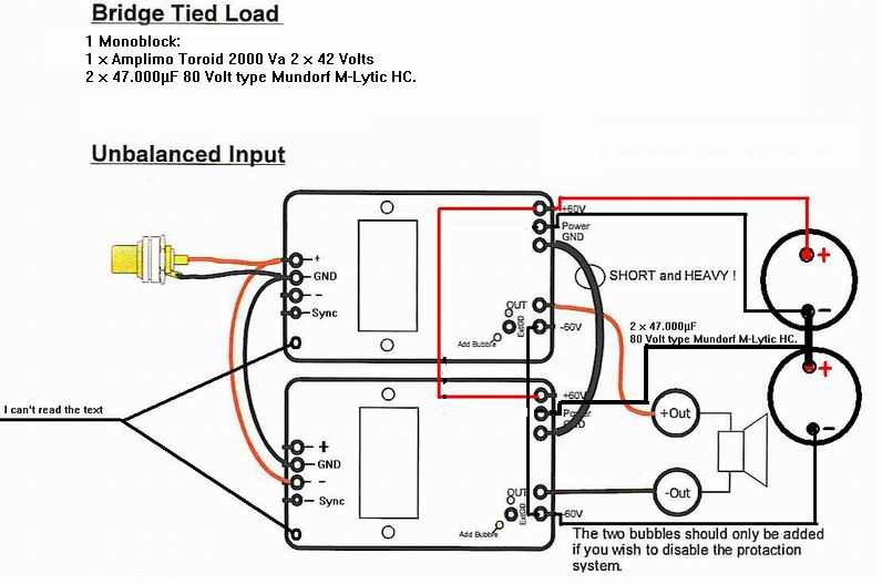

Re: Bridge Zappulse 2.3SE
BMW,
I may be wrong, but I think the Zaps should be connected in series to the power supply. They are now parallelled, so you should remove the connection between the plus-power inputs (60+ <-> 60+) and that between the minus power inputs (60- <-> 60-) and leave the rest as it is.
Greetings, Joep
BMW850 said:Hello,
Now here have a picture/scheme from the wire diagram how I solder the zap.
Is this wire diagram good for the Bridge Zappulse 2.3SE ?
Rudy
BMW,
Greetings, Joep
No, they should both be connected in parallel. However, if your diagram is exactly representative of the wiring scheme then I think I know what your problem is. You must connect each amp directly to the capacitor of the PSU. It looks as though you have one amp connected properly to the PSU then the other amp just hooks off that first amp.
richie00boy said:No, they should both be connected in parallel. However, if your diagram is exactly representative of the wiring scheme then I think I know what your problem is. You must connect each amp directly to the capacitor of the PSU. It looks as though you have one amp connected properly to the PSU then the other amp just hooks off that first amp.
My suggestion was not good anyway. For series connection you should connect + and - of both modules to the ground and the other + and - to the PSU, right? But anyway, so it should be parallel. Sorry for the confusion...
Joep
