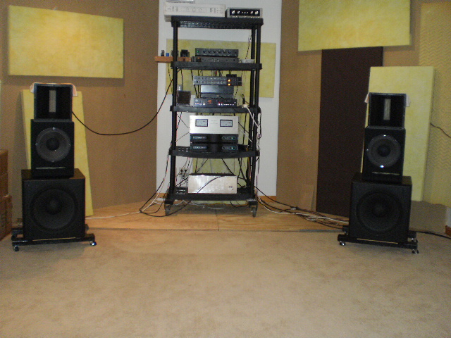

So, My design goal is normaly 120db considering the distance from my stack of speakers there is a calculated 10db of loss.
Anything less than this such as the 85db to 95db range I have smaller speakers that I use nearfield for just listening to as to not rock out the house. he,he

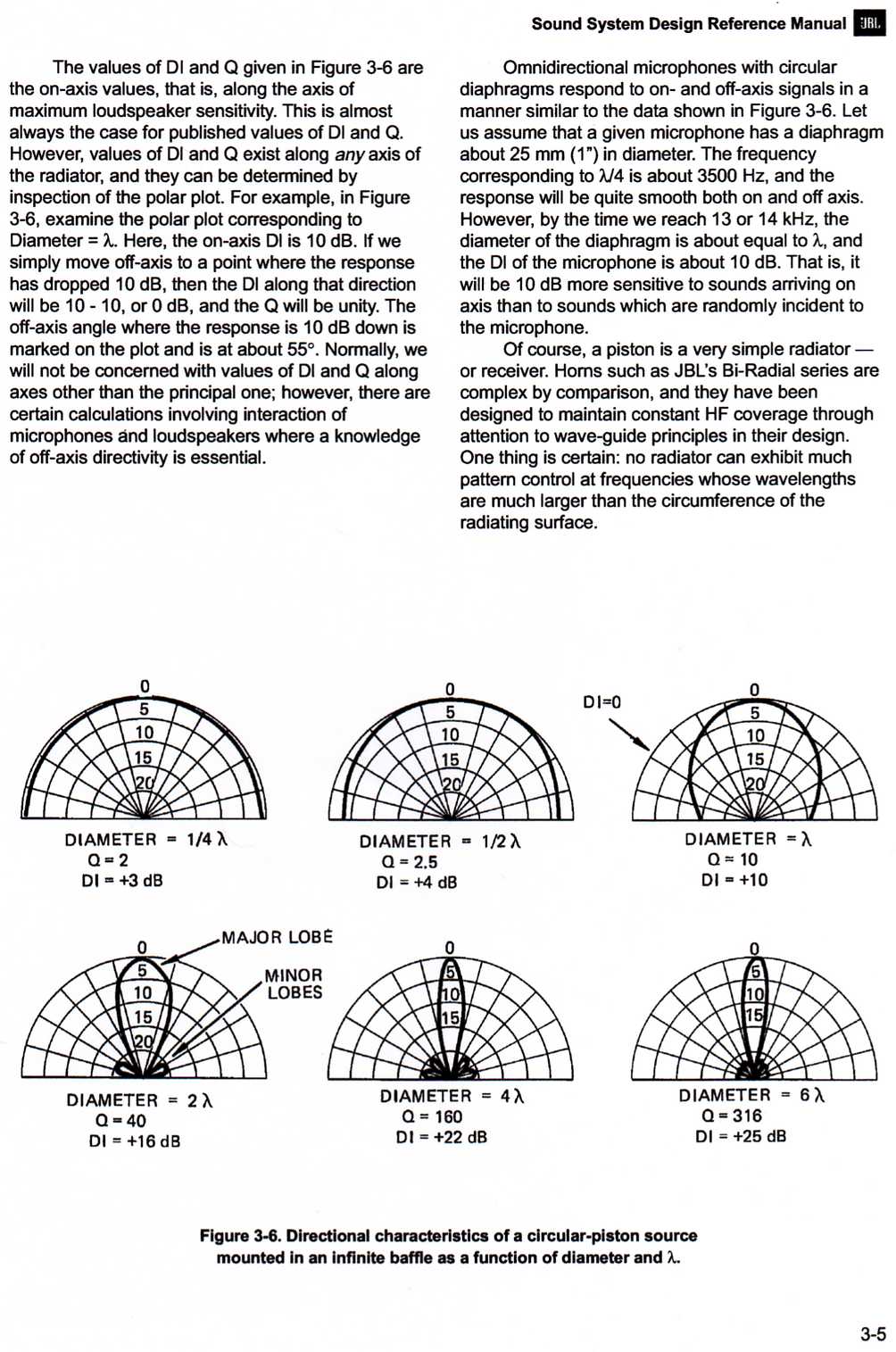

Here are the charts that I have been using to try and determine the width of my next drivers.
I am sure that some of you have seen them before and there are several papers with these same graphs.
I don't have the links but they can be found at the JBL site if you google up "speaker directivity".

See, this is where we disagree, and what the thread is really about. You suggest that the polar pattern must be as wide as shown at 1Khz to mate with a wide dispersion tweeter. Why ? -3dB at 70 degrees off axis ? Is that really necessary ? What acoustical research is this based on, or does it just look "good" on a polar response plot ?I generally agree with everything you talk about but I get the feeling that you stretch some issues a bit in order to hit the 300-3000Hz range with an 8" driver. For example it's obvious from your directivity plots that an 8" driver mates perfectly with a wide dispersion tweeter at 1kHz and a narrow one at 2kHz. Yet you talk about crossing over an octave further, why?
How will your dome tweeter (I assume that's what you have in mind for a wide dispersion tweeter) sound crossed over at 1Khz ? Pretty awful, I guarantee.
What is wrong with 2Khz, which is -3dB at 35 degrees off axis and -6dB at 50 degrees off axis ? That's a whole extra octave the tweeter now doesn't have to handle, which will reduce power handling requirements by 3-6dB, and excursion at least 4 fold, whilst causing the midrange driver very little incremental increase in load.
You also can't just look at the polar response of the driver by itself, you have to consider the summed polar response of the two drivers crossed over with each other, which always makes the polar response much better even considerably below the crossover point. Crossed over at 2Khz the horizontal polar response will be much better than -3dB 35 degrees off axis.
