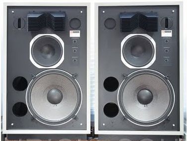

I would like to have a discussing on why 8" drivers are often preferred for midrange duties over 4" ones.
It all depends on what you have in mind.
The JBL4341 uses a 10" for mids. Working bandwidth is 300-1250Hz.
There are many others that use smaller drivers.

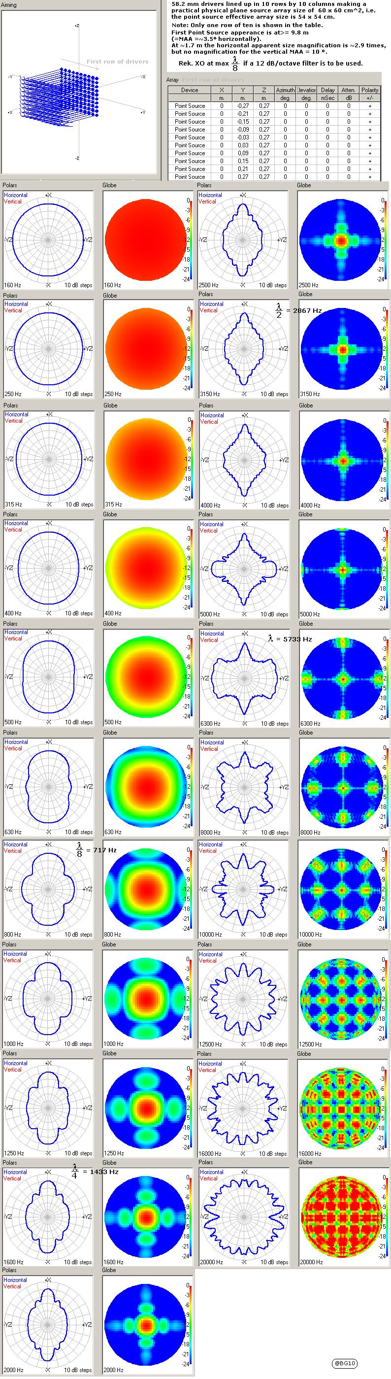

and here is midrange driver that - quite against laws of physics ;) - has advantages of small and large, in fact extremely large - effortless dynamics and power handling, low non-linear distortions, low energy storage
Mms around 2g or so and Sd around 2000 or so :D
extremely high directivity though - so for fans of total direct sound only :D OTOH we are told by experts that it is objectively wise to take the room out of the sound equation, so no problem really
The high directivity would be expected much like a large planar driver.
I wonder what your results would be if you tried a segmented crossover section with the rows of drivers,LIke what is done with a large segmented ESL driver?

here is directivity simulation:
yes, especially one can try delay lines as in Quad ESL
