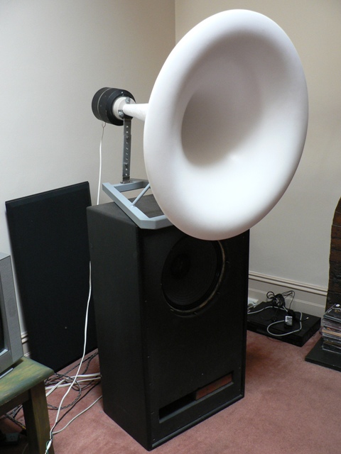

My instincts are confirmed, then. One potential awkwardness with the AH-340 Azurahorn is the sheer size - it's twice the depth and radius of the AH-550. By itself, not a huge objection (aside from price and shipping costs) - BUT, and it's a big but, I'd like the system to be reasonably close to time-aligned, without the tweeter being out a wavelength or more at crossover. The crossover design just goes a lot easier when the acoustic centers are close to each other.
It's a safe guess with a 1.2 kHz lowpass, the 12" driver will have an acoustic center about 3" behind the voice coil (based on a net 90-degree phase lag from the lowpass filter and driver acoustic response). This wouid be consistent with my measurements on the vaguely similar Klipsch Chorus. So that tells where the big compression driver is going to sit relative to the 12" woofer.
With an 8-inch-long AH-550, it overhangs the front baffle by a little bit, but not by much. With the AH-340 ... well, that's a different story. Now we have to contend with actual physical shading by the horn. This is the same mess as coaxials, maybe not as bad, but we have fool around with felt damping to get even reasonable performance from the woofer cone. The multiple close-in reflections are not what we want from the woofer, not in the 1 kHz range, no way.
The AH-340 can be moved further away, of course, but with a 1.2 kHz crossover with a 11.5" wavelength there isn't much room to move the horn too far away without getting into lobing trouble at the listening position. So it looks like the AH-550 is the strongest contender, assuming no throat profiles issues arise.

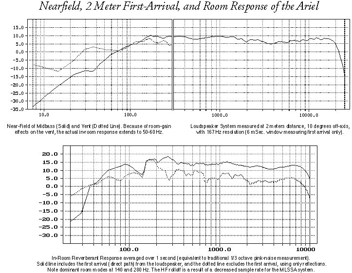

One feature I've wanted for LONG time with MLSSA is the ability to edit out the floor reflection, and replace it with a straight-line (or better yet, splined) interpolation between two sets of visual edit points. Once upon a time I went through an extraordinarly tedious hand-edit of a MLSSA ASCII *.TIM file, and to my amazement, the edit worked quite well without generating obvious spectral artifacts.
When the floor reflection, typically at 3.5 mSec, is removed, you can open the window out to 6 to 8 mSec, when all the other reflections start arriving. The longer window size directly corresponds to greater resolution in the frequency domain, something very worthwhile. The waterfall (CSD) displays also get much more usable - with a 3 mSec window, they're almost useless.
As it is now, I have to build a 2-foot pile of pillows in order to get the floor reflection 20 dB down, so it doesn't interfere as much with the direct-arrival measurement. (A floor reflection at 6 to 10 dB generates quite a bit of comb-filtering, filling the measurement with lots of clutter that obscure real frequency data.)

Several people have written requesting test results for the 10NDA520, so...
For a fairly well known "reference" I included the Seas W26...besides I have another use for it coming up. Both drivers are centered on very similar 19" wide baffles, closed across the top, but open to the sides and back...so the baffles influence the low end and likely introduce a little diffraction on the top end. No smoothing, no baffle extensions, basically "un-fooled-around-with" driver measurements at 500mm.
First, the W26:
Violent breakup at 4k which is why I like to stay below 800Hz with these guys. However, good correlation with the Seas factory curves which have a reputation for brutal honesty.
Now the 10NDA520:
Again, good correlation with the 18Sound factory curves. Bottom line is that the 18Sound factory curves seem trustworthy.
First, the W26:
Now the 10NDA520:
Nice data! Thanks for rolling out the cart and getting the measurements!
Usually I'd grumble about using a 85 by 115 cm IEC baffle with the driver off-center, but there appear to be almost no points of correlation between the two drivers, despite similar baffles. The Seas driver is certainly dominated by high-Q resonances - man, those won't be easy to filter out, a 24 dB/octave filter will just be getting started when it hits the big one at 4 kHz. (Back when I was wrestling with the KEF B139, I found it took 40 ~ 50 dB of filtering to audibly get rid of the severe resonance at 1.5 kHz.)

MBK said:interesting design, surprising that a 1.4" would go that low. No excursion problems / THD / IMD? I sort of assumed around 800 Hz as the lower practical limit for a 1.4".
Altec used this size driver at 500Hz in it's A5 systems using 2nd order filters. They also made 300Hz horns for some of their 1.4" drivers. I haven't taken measurements of these things, but I'll eventually get around to it.
The Yamaha drivers I use have a very unusual suspension - see the patent I linked above - resulting in fantastic compliance and a reduction in side to side motion that allows a narrower gap and a surprisingly small magnet. Another feature of the diaphragm is that the suspension is formed by a photo-resistive etching process out of berylium copper and doesn't suffer from work hardening problems as the pressed diaphragms do.
Meyersound used these drivers in a couple of their loudspeakers. When Meyersound started making their own compression drivers, Yamaha stopped making these. I'm not sure Yamaha ever used them in their own loudspeaker products.
