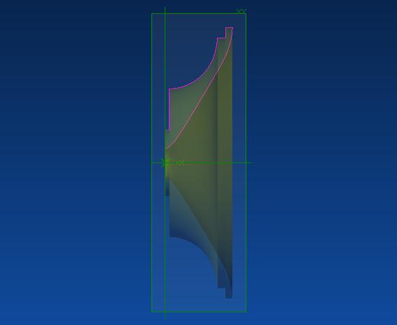

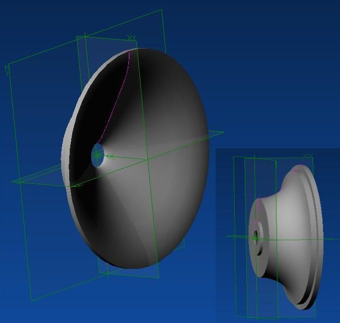

Awrite, then. I suppose I have to go ahead at some point... I'm just afraid my ignorance in horn design might make me waste other people's time (the ones with the tools).
I fiddled a bit with the design, made it into an insert for a flat baffle, with a recess in the back to accomodate a disk shaped adapter to bolt the driver on (with this shallow horn, there is no space for a flange and so any mounting bolt would have to go through to the front side of the horn, so I made space for a backplate disk that the driver attaches to, which can then be screwed to the backside of the horn/WG). Model attached...
Data still the same: 1.4" throat for compression driver or 1" dome+surround, WG has OS throat section for 120 degrees nominal coverage, merging into LeCleac'h flare with nominal 380Hz cutoff. Diameter ca. 14", depth ca. 3", expected to keep pattern control at least down to 1kHz (800 Hz hoped-for). One shall see if these predictions beat astrologers and crystal balls...
The OS profile turns into a conical horn very quickly (read: straight line profile). The deviation from "straight" is then in the fractions of a millimeter. From then on all that's left to do with it is to terminate it somehow, into a flat baffle, or a complete roundover. One could choose a simple large radius, and many do just that. For this design I chose to merge the contour to a LeCleac'h profile of a size such that angle and diameter would exactly line up with the near-conical section of the OS WG, because the LeCleac'h, just as the OS WG profile, claim that the wavefront remains perpendicular to the horn walls at all times. Since it's physics it's all approximations of a complicated reality though (the physicists will wiggle in horror, but then again, I'll say, Lorenz, turbulence, chaos, I rest my case).
