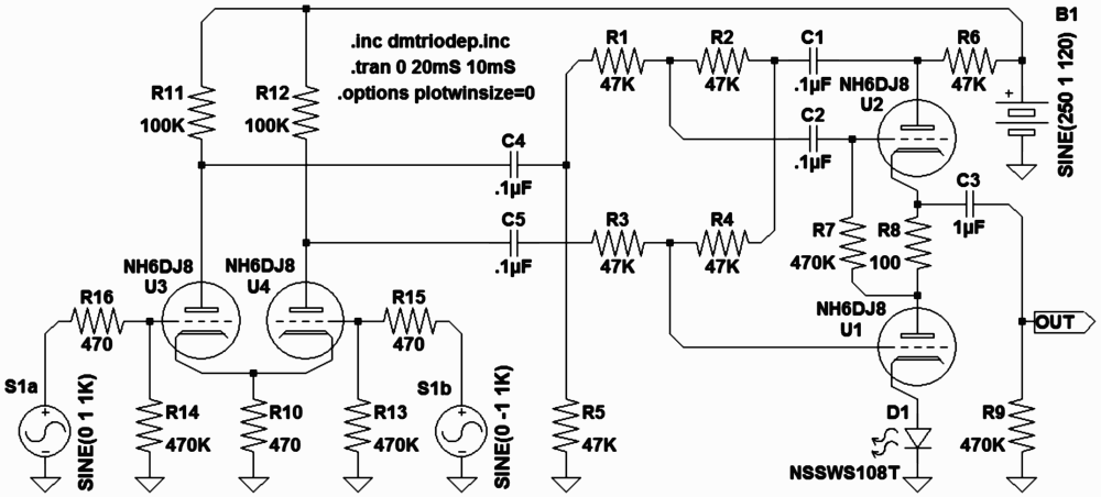

Hey ken, how do you hook up an unbalanced input to your circuit? Or am i misunderstanding s1a and s1b as a balanced input?
s1a and s1b represent differential outputs of a 5V DAC, quiescent at 2.5VDC.
So yeah, they are "balanced" as I've drawn it.
GND is also well withing the 10V range of common modes that this stage can
reject. So 2.5VDC offset can be ground referenced instead with no problem.
Each input presents a 47K AC impedance (47K+47K=94K differential) to DAC.
DC resistance to GND are slightly differrent. But common mode rejection will
hide constant DC error anyway.
If you use a single ended input, I would use S1a as the active signal, and
S1b as the ground reference. As the impedance of S1a is always true 47K
no matter what S1b is doing. The input impedance of S1b depends on S1a
being balanced opposite, else S1b input impedance drops to 31K? Just use
S1a input if single ended...
S1b already has a resistor to GND, you don't have to do anything more to
ground reference it. Any residual balanced mode behavior will only help to
break ground loop problems, so no need to "fix" S1b to local ground. It can
float a little with ground from the previous piece of upstream equipment.
But common mode rejection will hide constant DC error anyway.
Sorry, meant DC mode rejection in this instance, not common mode.
Does both, so I confuse myself...
You will also need dmtriodep.inc to run the simulation.
Generic triode at Duncan Amps. Link marked "PSpice"
As I suspected! Front end LTP don't need power filter,
DWCF common mode rejection takes care of all that.
Now we got Voltage gain! And current gain...
Almost like differential version of Aikido, no idle threat!
Note upper right corner: I have injected 2VPP of power
supply ripple just to illustrate how immune the circuit is.
You won't see any of it in the output.
Though PSRR is indeed still excellent, front end seems
to need at least 150V to work with even half the input
levels shown. Not yet sure if anything can be done to
drop that minimum figure back to the 80V? Its probably
necessary headroom for Mu to swing at LTP plates.
