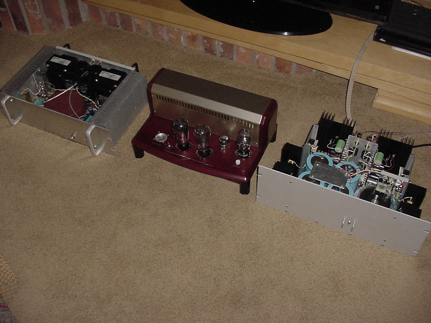

This might be of interest to someone. The attached pic. shows my 'store-bought' Yamamoto A-08S fitted with NOS Cunningham globe 45s, flanked by my SIT creations - 193V L'amp on the left and my power follower design on the right.
A non-scientific 'shoot-out' was conducted over several listening sessions during this past extended week-end.
Bottom line - no clear preference. As with most things audio, it all depends on one's preference/biases, choice of listening material etc. - clear case of 'a chacun son gout'

By 'no clear preference' I did not wish to imply that the amps all sounded alike or had the same character. Quite the contrary, they all sounded different and in quite surprising ways. On numerous occasions depending on source components and program material, the SIT amps were 'warmer' and 'wetter' than the Yamamoto and in somewhat of a role reversal the Yamamoto had better bass control on some occasions. This was the case on the "Kill You" track on Eminem's Marshall Mathers LP - a severe test of bass transients.

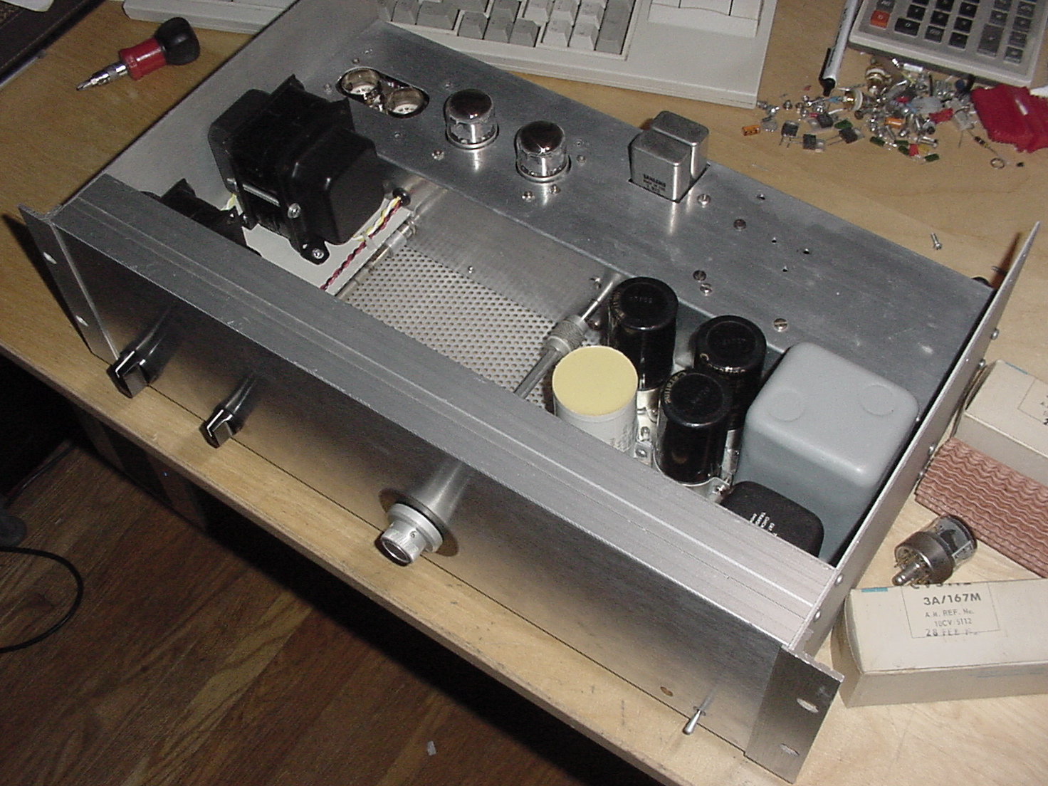

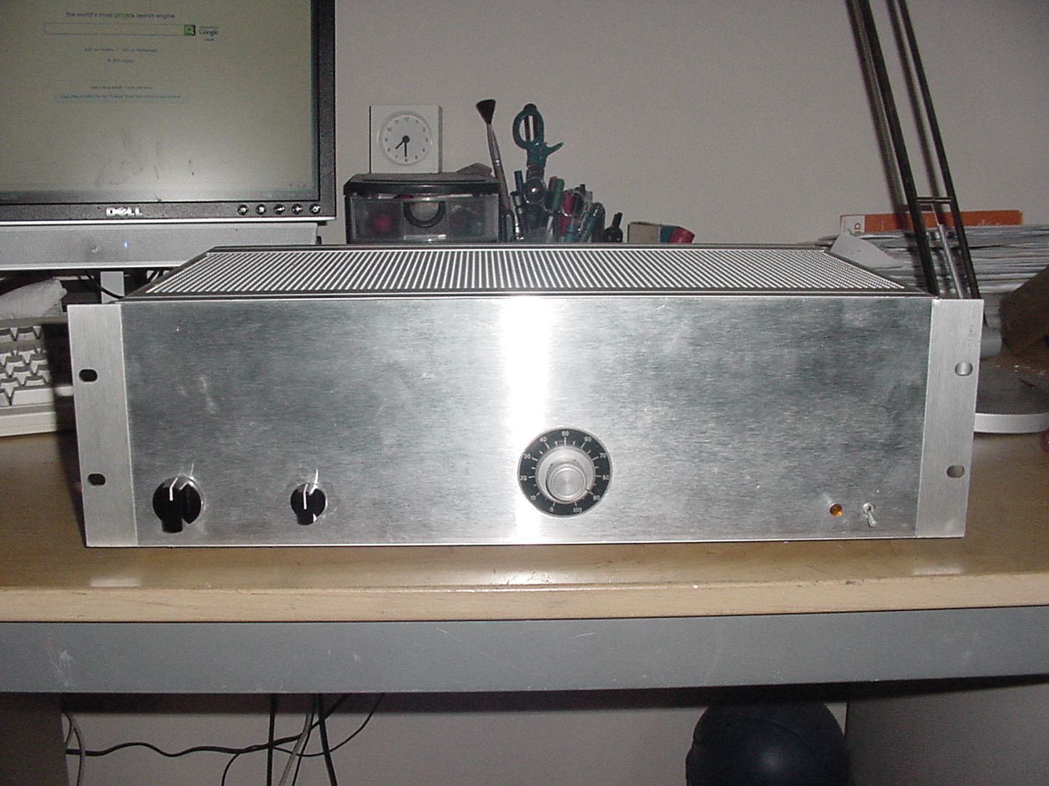

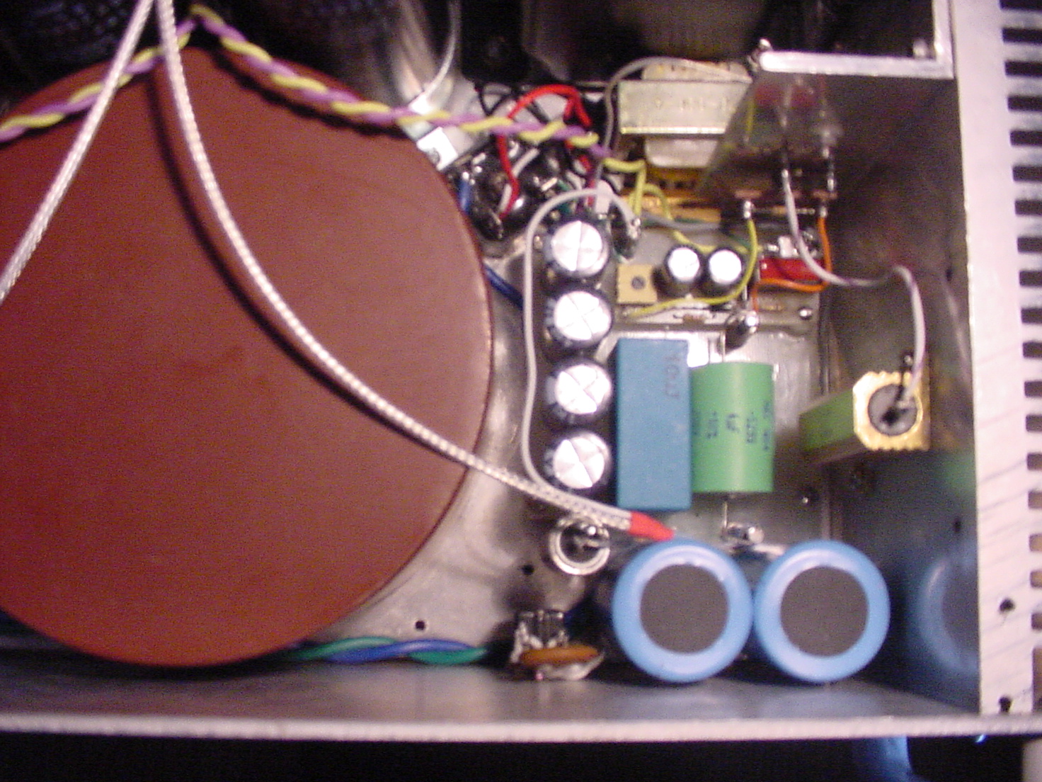

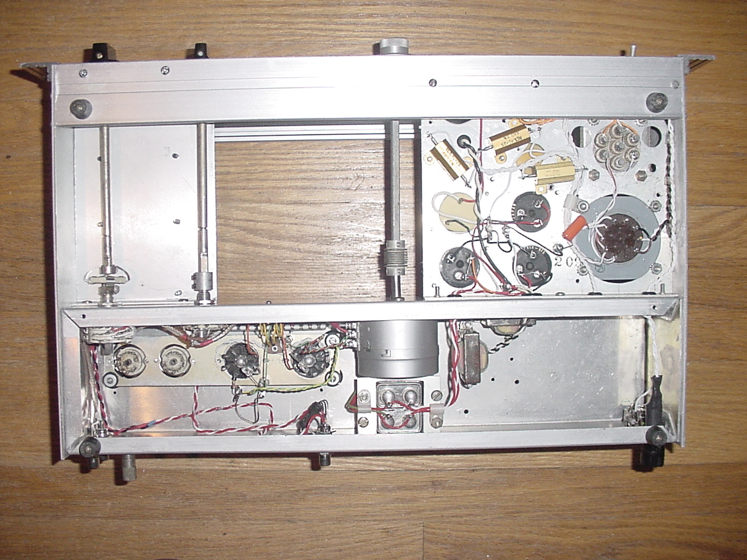

To keep Zen Mod happy attached are some file pics of my Euridice build.

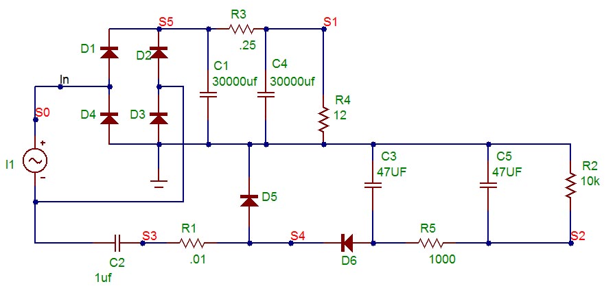

Before I attempt to answer your question , some details are in order - my 193V SIT differs from Mike's design in several aspects. I tried different biasing schemes and settled on self-bias with a by-passed source resistor, which at the time sounded best to me. After the initial novelty of listening to the SIT wore off, I came to the conclusion that the amp was 'warmer' than I liked. There is really no easy way to adjust a self-bias amp, you have to do more than just twiddle a pot, that was when I switched to fixed-bias.
My previous experience with fixed-biasing (tubes) convinced me that unless I was prepared to regulate B+, it was not a good idea just to regulate the bias voltage - best to let both voltages float along together - so it is with the SIT. I used the attached unregulated negative supply circuit suggested by no other than The Master and in doing so eliminated a whole bunch of components including my least-favored IC, the 79xx. So far I have been pleased with the results.
I added a 0.33 ohm source resistor to limit the power-on current surge , prepared to accept the resulting degeneration in exchange for a longer and happier life for the SIT.
The power supply is a CRCLR configuration and I had to use a 20v transformer (Antec AS-4220) to make up for the voltage drop.
The bolded in your text above is an important solution to bias the PP complementary SIT amp which Mr. Pass demonstrated at BAF 2013.

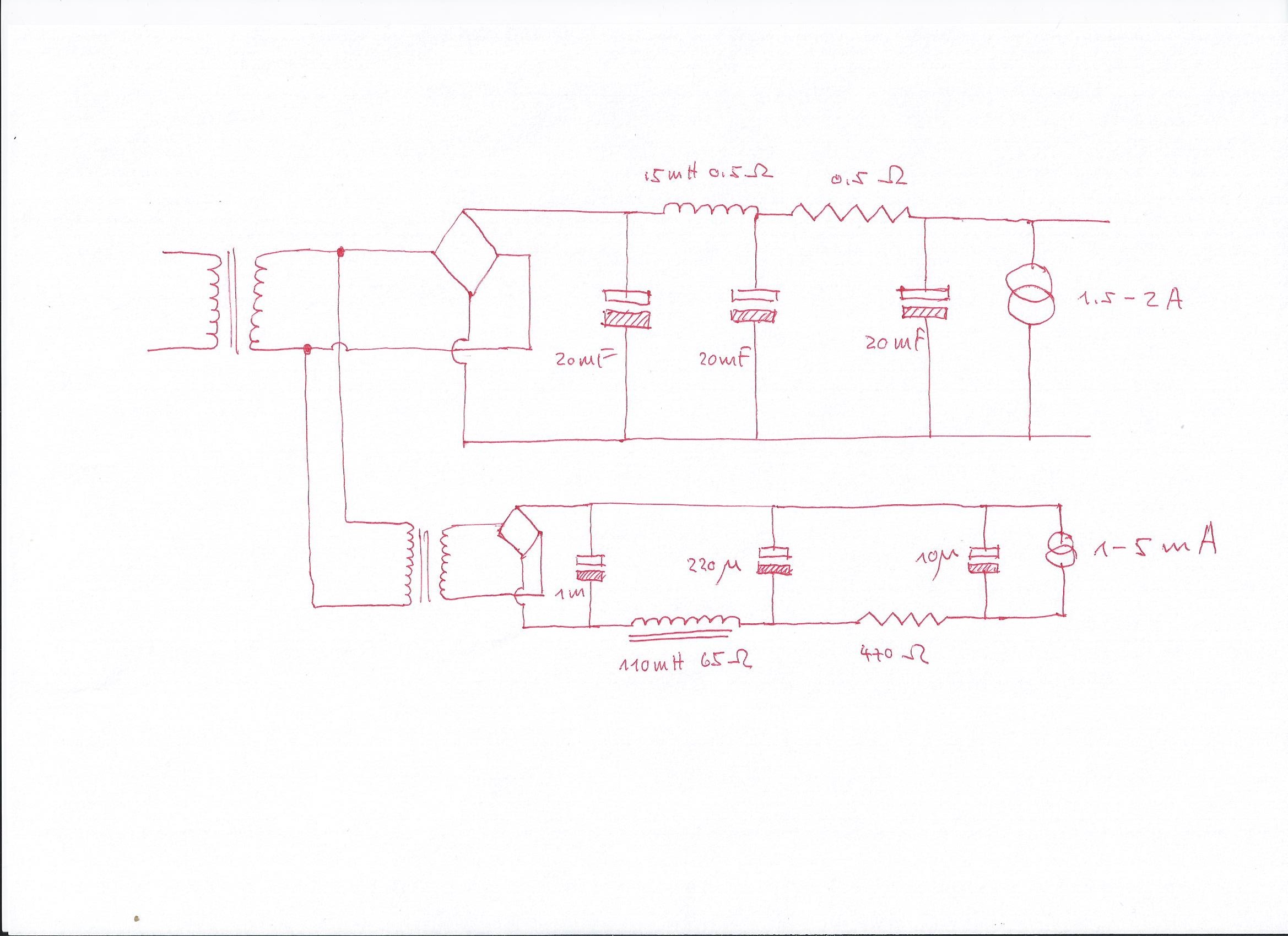

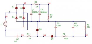

Many thanks audiong for sharing.
Ever since i read post #879 by ilimzn i could not refrain from thinking about the problematic of bias adjustments.
These days i think about transformer coupling to the secondaries of the main transformer.
Simulation with PSU Designer II shows that the Bias is up more quickly than B+.
I do not know what will happen when switching of.
Anyway, as long as nobody has serious doubts? I shall order the small transformer 2x 115V / 2x24V next week and give it a try.
My thanks for pointing out someone else's work is to be nitpicked. Now I remember why I love this hobby so much.
Hello Mr. Rothacher. I was unaware that you were entitled a befitting The Master. A simple statement like audiong wrote about SIT bias tracking plus a reference [please show] is like a L'Amp turning on. Now I see the light. Thanks and best regards,
