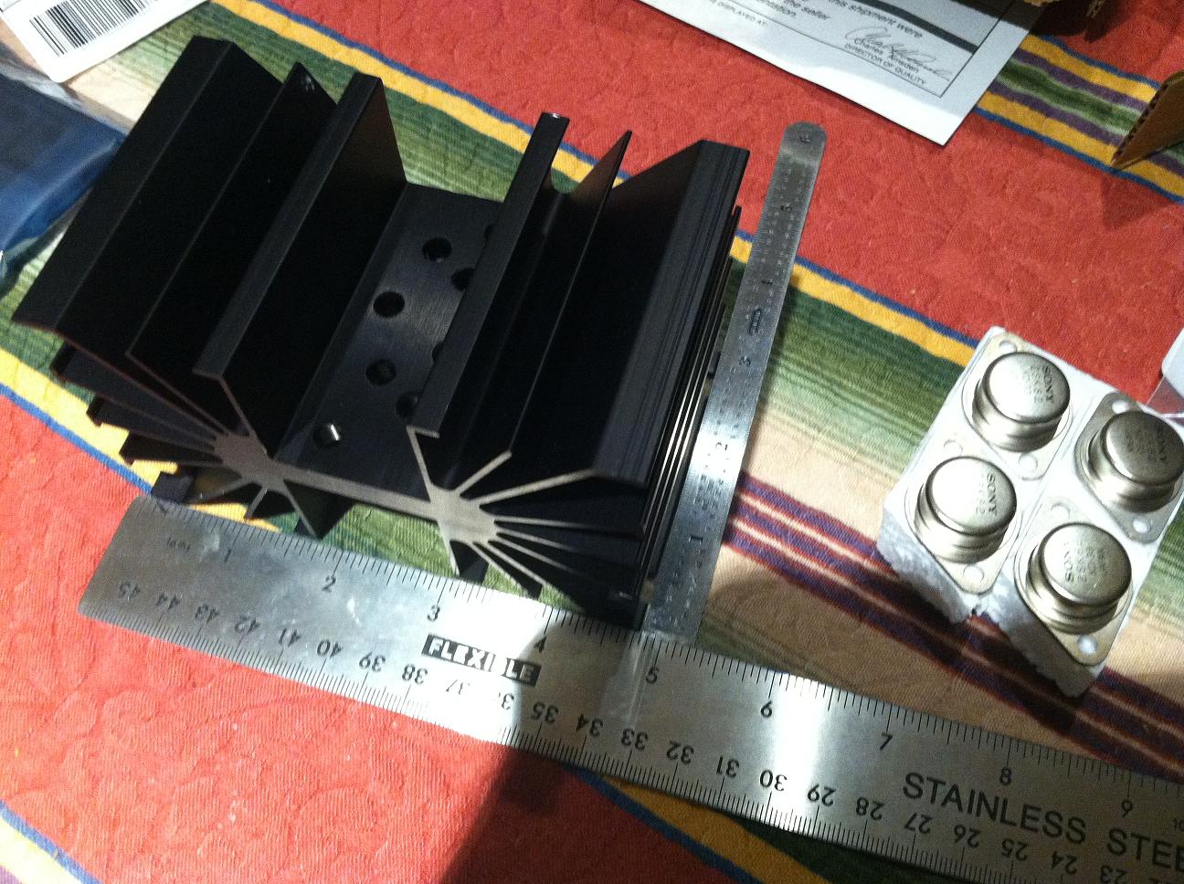

He uses as far as I know the inductor solution, you need more heatsinks for your CCS!That's it?!?!?! That's all? Tell me they go into the case, please!
Had no idea it could be that small!! The extra heat sink I have are at least that big, maybe bigger.
Also have 8 heat sinks that are bigger than that one, if I take apart my Zen v1. I used the transfo from the Zen 1. It ran at 2 amps.

You could use those for lots of things. If you don't have the actual spec, I'd estimate one to be around .8-1.0 C/W.
