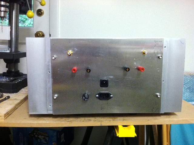

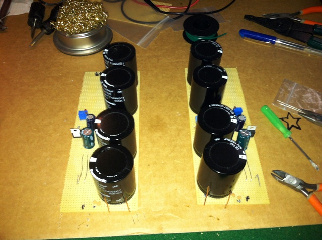

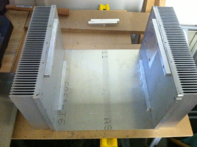

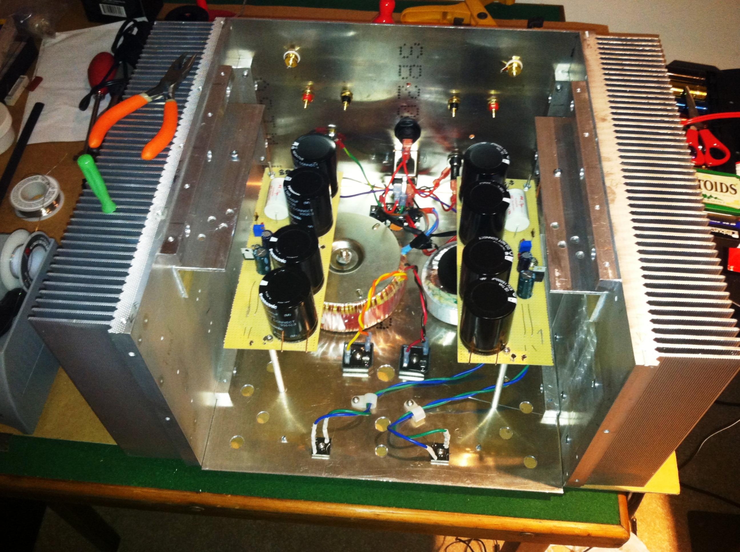

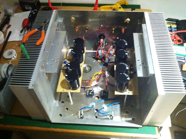

Here's my take on the CCS SIT amp. It's almost complete. Was going to name it MR SITA for Mike Rothacher Static Induction Transistor Amp. ;)
Hope you approve! :D
