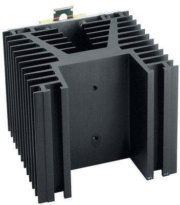

But if my HeatSink for the SIT(found on E-bay) fail - I have spotted one that should fit in box and maybe in spec. On the Elfa-Distrelec- it is specd: Termisk resistans = 0.5 °C/W. Included is a picture of the HeatSink.
I have received a couple spare SK82 - so I`m safe if the first blow. And I didn`t know where to get the proper sink earlier.
So Michael - if you could help if my first SK82 goes up in smoke.
Best to all - and thanks for all support this far in my build.
Olav

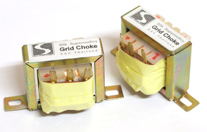

I've forgotten who I promised this to, but here's the info on the Hammond 193V.
Not bad, and we get a nice efficency boost from the lower DCR iron core. You can put those 24V supplies to use now. I didn't experience any loss of inductance at 2A (or the rated 3A for that matter).
You could even run this one with a 20V supply @ 1.4A for a nice little 7W amp with 2% THD at full power.
No, I haven't listened to them. The measurements are in the pdf. Have fun.

.5C/W is good. The heatsink pictured looks reasonable by calibrated eyeball.

The SITs are pretty robust current-wise, but running them too hot isn't a good idea long-term. In fact, the cooler the better, IMO. Remember, we're already pushing it on the Max Pd. I never hesitate to oversize my heat sinks a bit when possible. Also, do a really good job with the device mounting, clean the surfaces, and use generous amounts of goop. The heat will also affect the gate leakage and perhaps upset your bias. Thermal stuff is often ignored by us DIYers; the more amps you build, the more you'll pay attention to those matters.

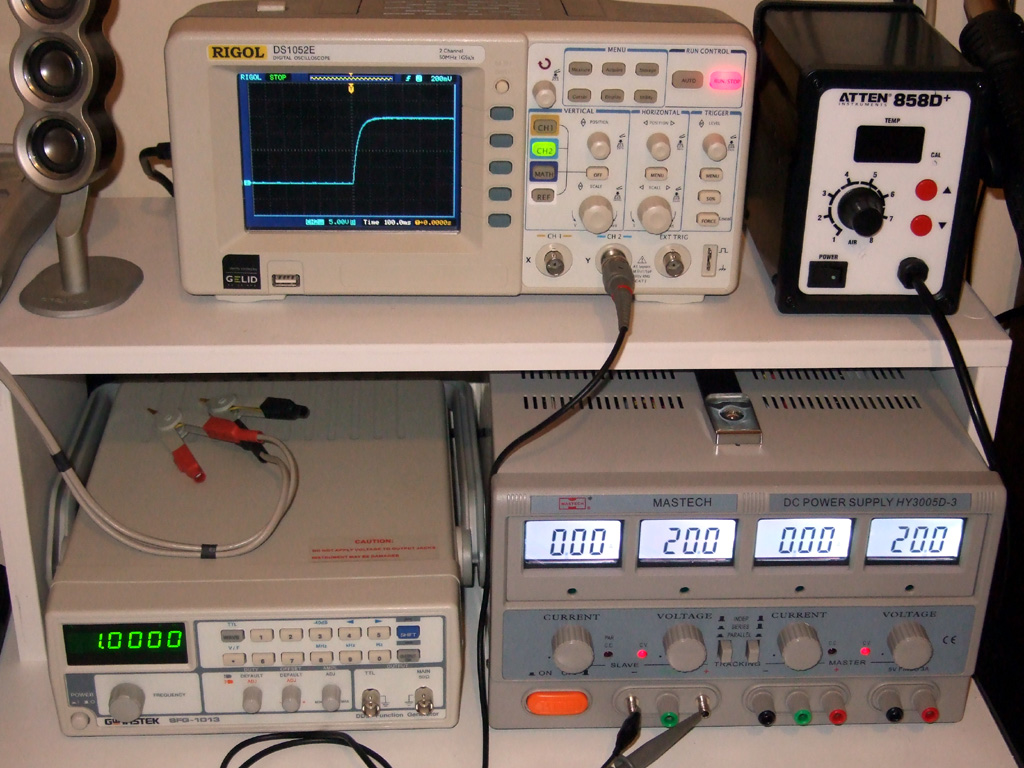

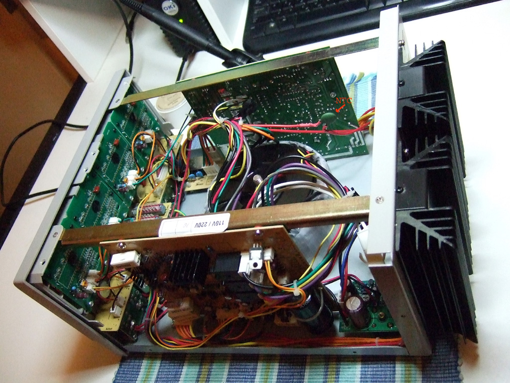

Maybe a bit OT, maybe not given this kind of amp's power supply range. There are $200 double and $130 single linear high current regulated bench supplies about. I have a double 30V 5A unit for series linking up to 60V high or up to +/-30V symmetric. Also because I could find one of the fan-less variety in doubles. Maybe good for checking out such amps fast, listening, and then deciding to keep and build them their own costly supplies. And for a number of other projects of course. For Matching MOSFETS, SiC JFETS, SITS, also. But don't use it as a circuit's CCS, you remember it did not work correctly for member Protos amp. It takes to fit an NTC primary side not to trip 10A breakers (I put one there). That trafo is 500VA easily. Construction is so-so, but OK for the price. Its meters look set true. Setting the scope's trigger for single shot, I captured the power on event. Looks smooth, no over voltage or ringing. That one's a 5V/Div 100mS/Div ramp up.
