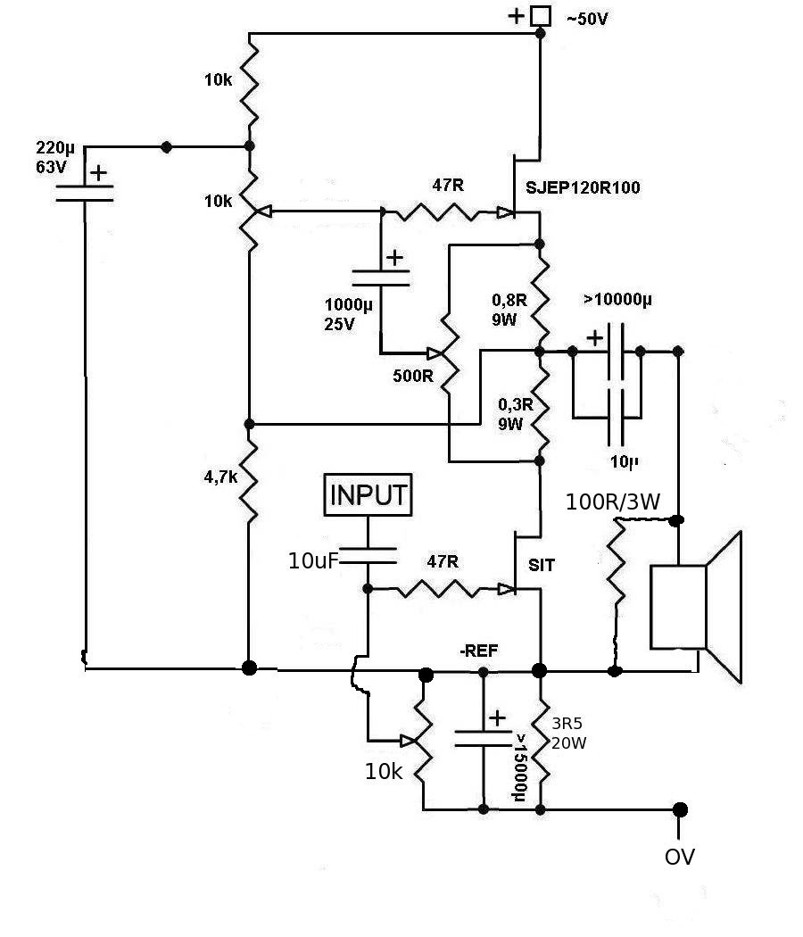

L'Amp: A simple SIT Amp
I hope this "handmade" picture helps...:)
I hope there are no faults, I am in a hurry to go to a party in Heidelberg.....46 years Abitur celebration......two days....
see you later on monday...:D
I'm just tuning back into this - do you tie back to "-Reference" or Ground in your diagram. Ground seems possible based on prior diagrams, but only you know what you've built.
Joined 2009
But you all can help me !!!!
I do not know what is the better possibility grounding at 0V or at the negative reference...

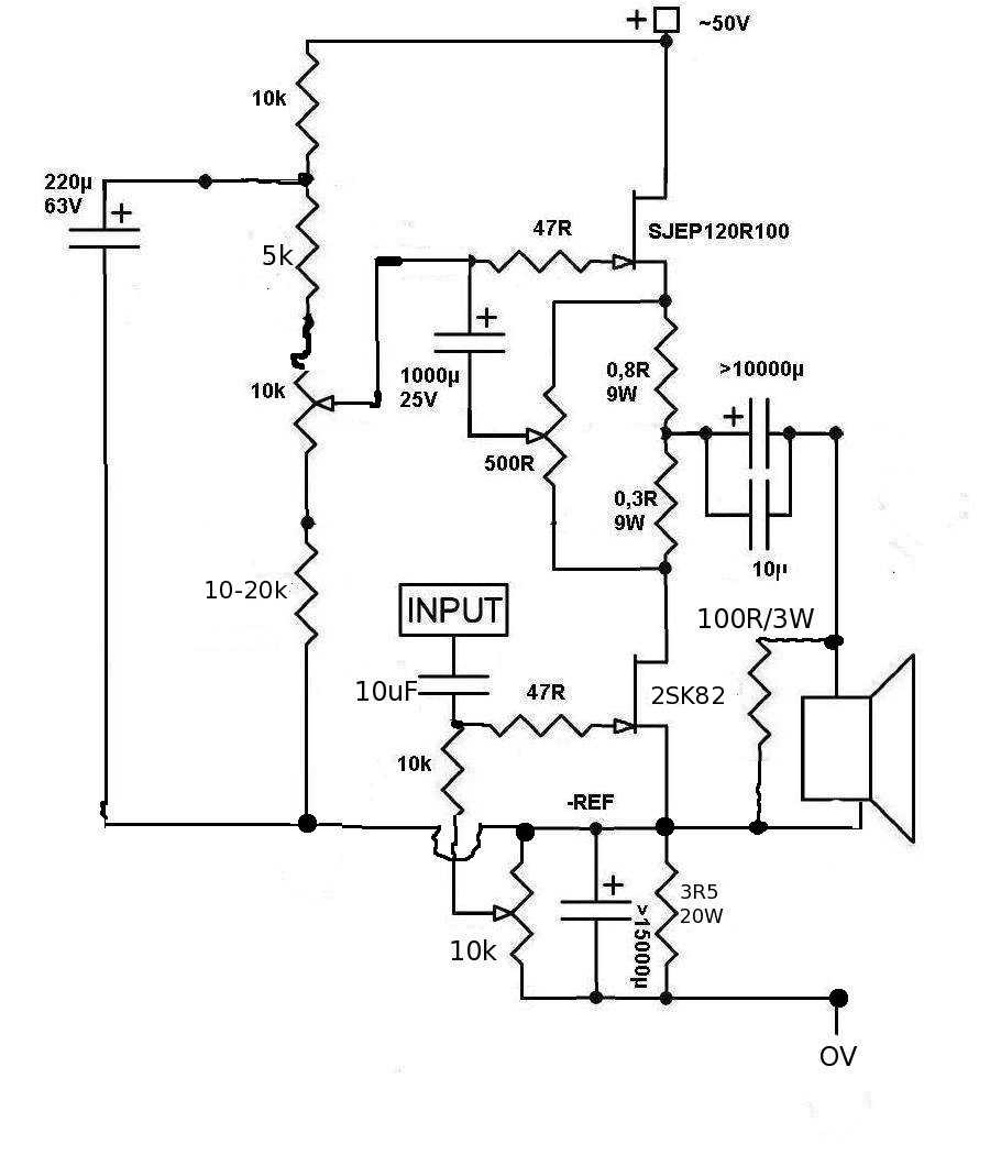

O.k. I am never perfect, must be a disease....
I forgot in both pictures the 10k resistor going from the node point input cap and 47R gate stopper to the wiper of the 10k biasing pot of the SIT.
You can see this 10k resistor in all pictures of Mike!
And the connection from the 4k7 resistor to,the output node is not necessary.

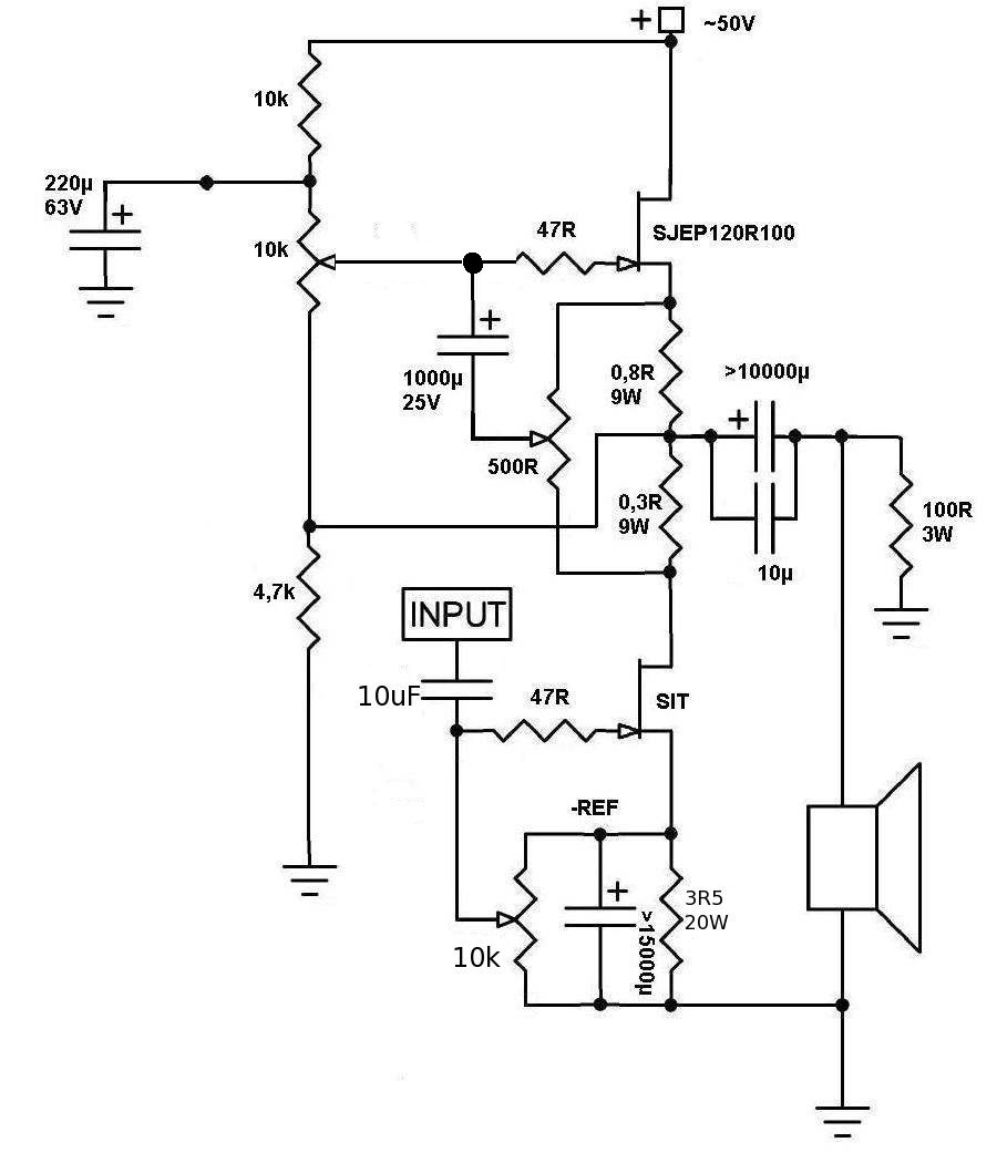

the 3R5 biasing resistor delivers the biasing voltage that you can fine-tune with the 10k pot, I would keep the value of the 3R5 resistor as low as you can. It depends on the current you want to have for the 2SK82. With 2A and 3R5 you get a maximum bias voltage of 7V. That might be unnecessary high, so you can go with the resistor value a bit lower. With 1,5A you can calculate yourself....:D
I still cannot understand the biasing network of this circuit. What is the voltage at -ref and where do you get it from?
From my point I see the vfet biased by a 3r5 to ground BUT then I see a -ref attached to the source. Since the current will flow in the path of least resistance it should flow from source to -ref and basically the source is at -ref voltage whatever resistor you may put between source and 0V.
