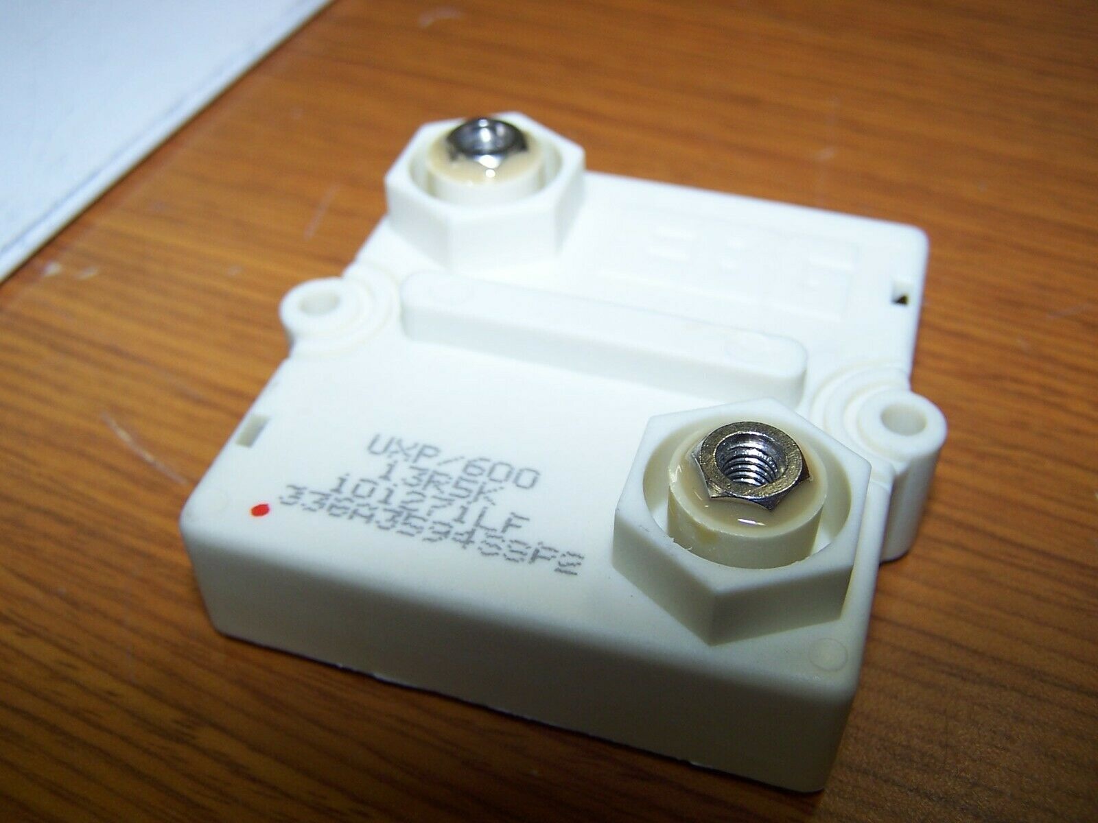

I am curious how its sound with light bulb but other Diyers write with power resistors sound is very good as well. If you don't want use 3 or 4 cheap wire wound resistors in series
https://www.ebay.com/sch/i.html?_from=R40&_nkw=100+watts+wirewound+resistor&_sacat=0&_sop=15
the alternative choice can be something like that
👀 NEW EBG ULTRA HIGH POWER RESISTOR UXP/600 - 13R5K - 336A3594SSP2 | eBay

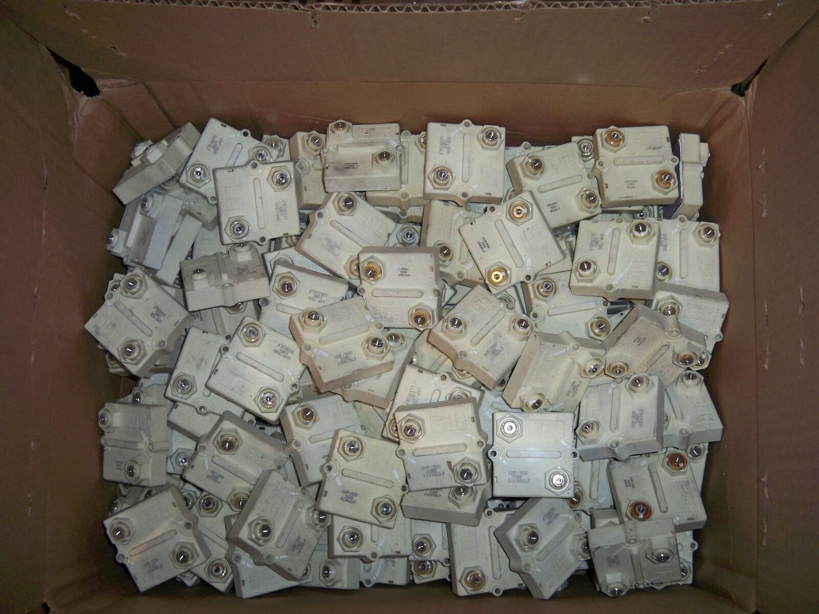

Yes industrial resistor to put on the heatsink with layer of thermal paste

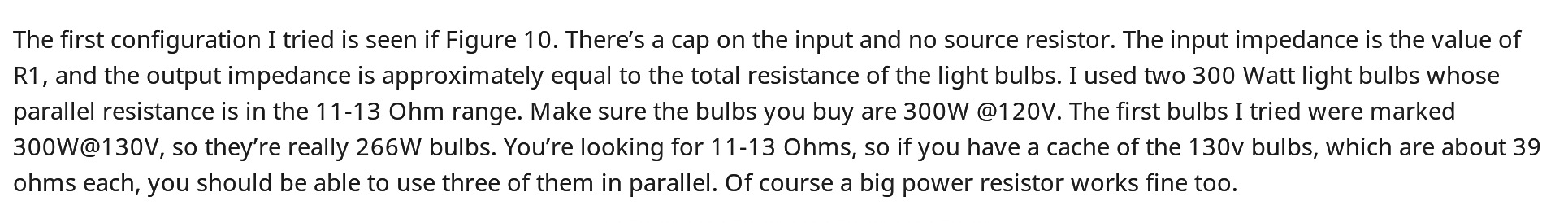

Output impedance = total bulb resistance 11~13R
I see 1R less used 10 pcs. of 10R rated at 300W at good price
QTY:10, EBG (VISHAY) UXP/300 10RK 10 OHM/10OHM 300W FOIL NON-IND.POWER RESISTOR | eBay
Could be interesting resistor model to try with big Tokin as well

..so a 8ohm extra easy load
Look at Mr. MR post # 3 L'Amp: A simple SIT Amp
Yes original L'Amp circuit is optimised for 8 Ohms speakers load
