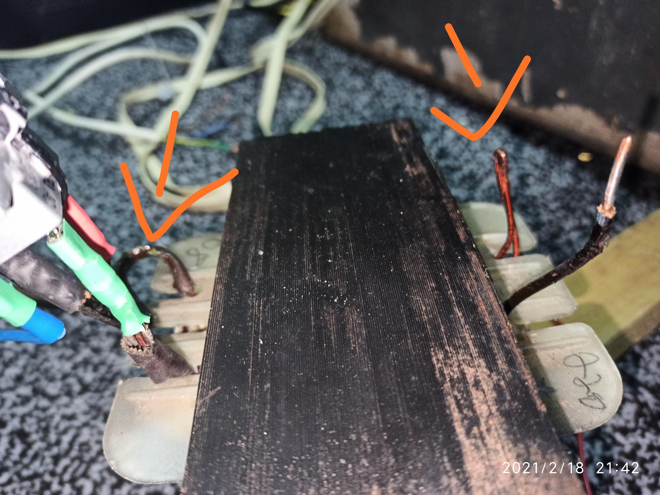

I took a few steps back.
connected only the transformer to bridge and caps.
if the chassis is not connected, all good
if the chassis is connected trough thermistor (or directly), Depreciation relay of the hose is pop out.
Is a body of an electrolytic shorted to the chassis? Is the transformer shorted to the chassis? I suspect the latter; if you are using a toroid its easy to have the insulation pierced by accident.
maybe is the transformer.
i don't know why, but the primary is connected to the secondary :confused:
but still, it work.
as diyer, i never give-up.
after watch this transformer, its “bucking” configuration, so the amplifier work only with float input, and i cannot connected the cap to ac line ground, because then the ac line ground is sort to natural.
so or o work with float input, or replace the transformer.

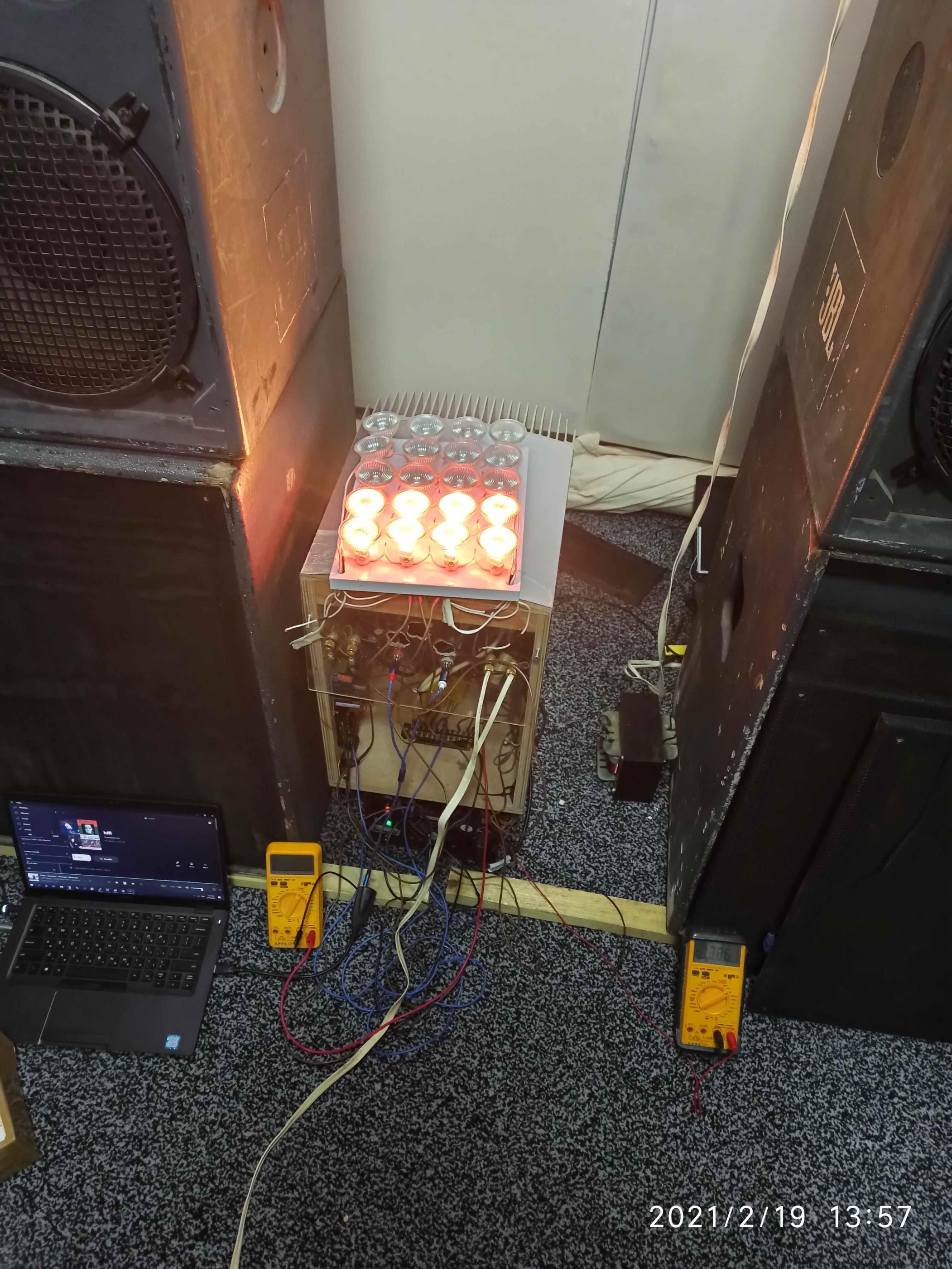

Thank to everyone for the concern.
In the end the transformer structure was such that there was a common natural, this lesson cost me 200$ :)
I replaced the transformer to normal transformer with Independent secondary-primary, and the amplifier works (40v 3A)
