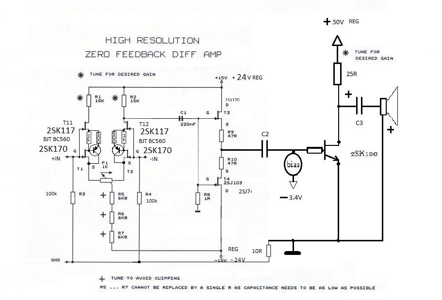

I'm used to working on high voltage amplification with tube circuits but not SITs.
Do You read all Mr. Pass articles about SIT's and Vfet's ?
http://www.firstwatt.com/pdf/art_sit_nemesis.pdf
http://www.firstwatt.com/pdf/art_sony_vfet_pt1.pdf
....and more FIRST WATT ARTICLES
It's depletion mode transistor You need take care.

The PowerReg (maybe all power regulators) make the voltage climb slowly, so it is sort of a soft start. You will need good quality, high voltage, low leakage capacitors (and high voltage transistors) if you decide to use it. Of course, the negative V bias circuit will be there first if you use a conventional voltage regulator.
The regulated power has the added advantage of reducing the capacitance required for a linear PS.
I attach an App. Note that deals with high voltage regulation.
Good luck and have fun.
M.

Yes, I had this concern too: sometimes I feel the regulator might taint the sound but a well executed VFET amp will erase your concerns in two seconds, probably, plus the bass is great.
The PowerReg, with film caps, ends up being BIG.
My own preference is for a resistor loaded VFET amp (the R protects the VFET, as MR explained before) with a "low thermal memory" input section, like the one I posted before. This really opens up the sound and increases dynamics and transparency.
(I use slightly different local feedback resistor values now)
Good luck.
M.
PS: apparently the 2SK30 JFET has low thermal memory effect, as shown by Hephaïstos, so I will check this with a simple differential pair soon!

Ya, high voltage high current PSU are huge.
At the end, I'm probably gonna use a tube driver stage, but for initial phase, anything simple to hook-up will do. Thanks for the schematic and links! I've read Mike's stuff over and over again, hoping not to smoke my limited THF-51s.

I am already listening to the 2SK30A GR input. Sounds nice. Probably "rounder" than the 2SK170, though transconductance is much lower than the later.
Anyway, the cascoded-CFP input ("Low TMD") sounds better than both, IMHO, more dynamically contrasted, more transparent and with a certain "magic" to it.
M.
