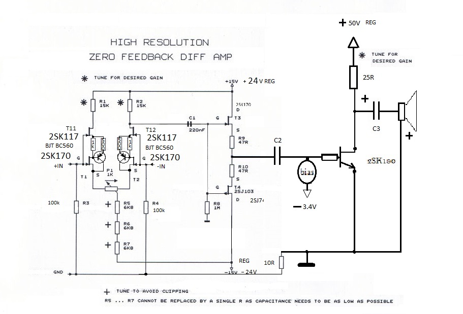

As some may know, I am experimenting with Peufeu's recommendations for diminishing (putative) thermal memory distortion effects, like the cascoded-CFP input pair. Well, yesterday I replaced the input pair differential with a "cascoded-compound CFP" pair of units, using Toshiba's SK170 as both, the cascodying element and as the "driver" of the CFP pair and a BC560 PNP as the "emitter follower" of the pair, with a 1K resistance on its emitter. I confess I studied some academic articles about this compound Szicklai but they were too much for me, so I took the plunge as the good Lord seemed to advice me...and it worked! :D
First listening tests are very encouraging. :cool:
I attach picture of the cascode-compound CFP units and a diagram of the target amp...
I hope you like it.
M.

Waths is the gain of your interesting CFP?
Waths bias have the sk180 for 50v B+?

I now realize that I never posted the updated schematics...I will do ASAP. My AMNESIS amp project is consuming all my free time :eek: My whim was to put there a CFPcascoded-CFP output and now I my trying to stabilize it :confused: That amp rivals this one soundwise...
No idea what the gain might be; I confess I didn't measure much parameters and went directly to listening. The gain is formidable though as both stages amplify. The gain can be set by trimming R1 and R2 on the diffamp, well and also trimming Rd on the output stage.
IMHO, key to good sound is providing separate regulated supplies for each section. I might test now separating signal and power ground with 10R, now that I think of it...
The bias is -3.3VDC for my 180 units and that for 1Amp current, last time I checked...
Mr Pass published a version with CCS that of course must be more efficient. I have it here somewhere...
As I said before, I had not the time to do the multiple mods that swarm in my head :(
M.

Hi Max
thanks for the schematic.
your CFP scheme fascinates me and I would like to try to adopt it as a front-end of the MoFo. since you've posted the diagram from memory I'd like to ask you to verify it.
I could make it fast on a perfboard with a supply at + 15v / -15v.
I would also like it if you describe in detail the most important parts of the circuit and possibly how it works
Thanks again.
Be aware that I'm only a dilletante with no formal tuition in electronics, and that I don't know MoFo nor its requirements from input signal point of view...
The diffamp is a classic differential amplifier with a common-drain buffer attached. I suppose C1 is not strictly necessary if you have something like C2.
Better go with +/-24 supplies for better headroom. Use your favorite low power VReg.
R1-R2 decide the gain and the resistor tail (R5->Rn) defines the current for the CCS. You must check with oscilloscope to avoid clipping and to secure adequate gain for your next stage. Choose high quality, low noise resistors for best sound. IF you cannot have desired gain, you can mod it with the transistor based mods recommended above.
Note and respect pin description (G.S.D.) for the JFETs as there is a small mistake on the original schematics that I always forget to correct...
Good luck and may the Force be with you.
M
