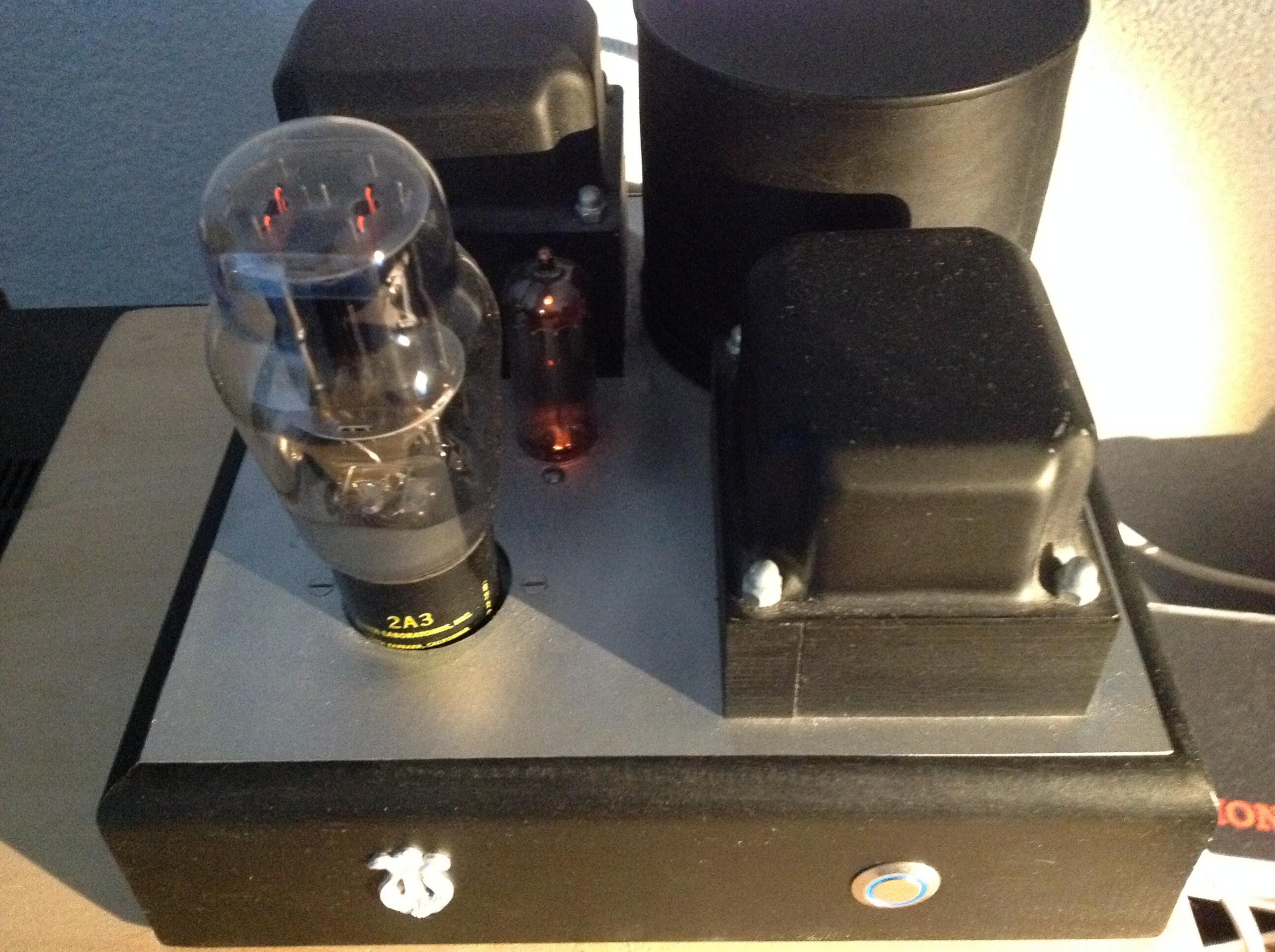

Tube 2A3 triode i compare with Inductor L'Amp.
Well tubes amp need very high quality output transformers and psu that not the case in my small 2A3 monoblock's.
Sound good but i think tube OTL ( output transformer less )
amp's is much better and have wider band with frequency range.

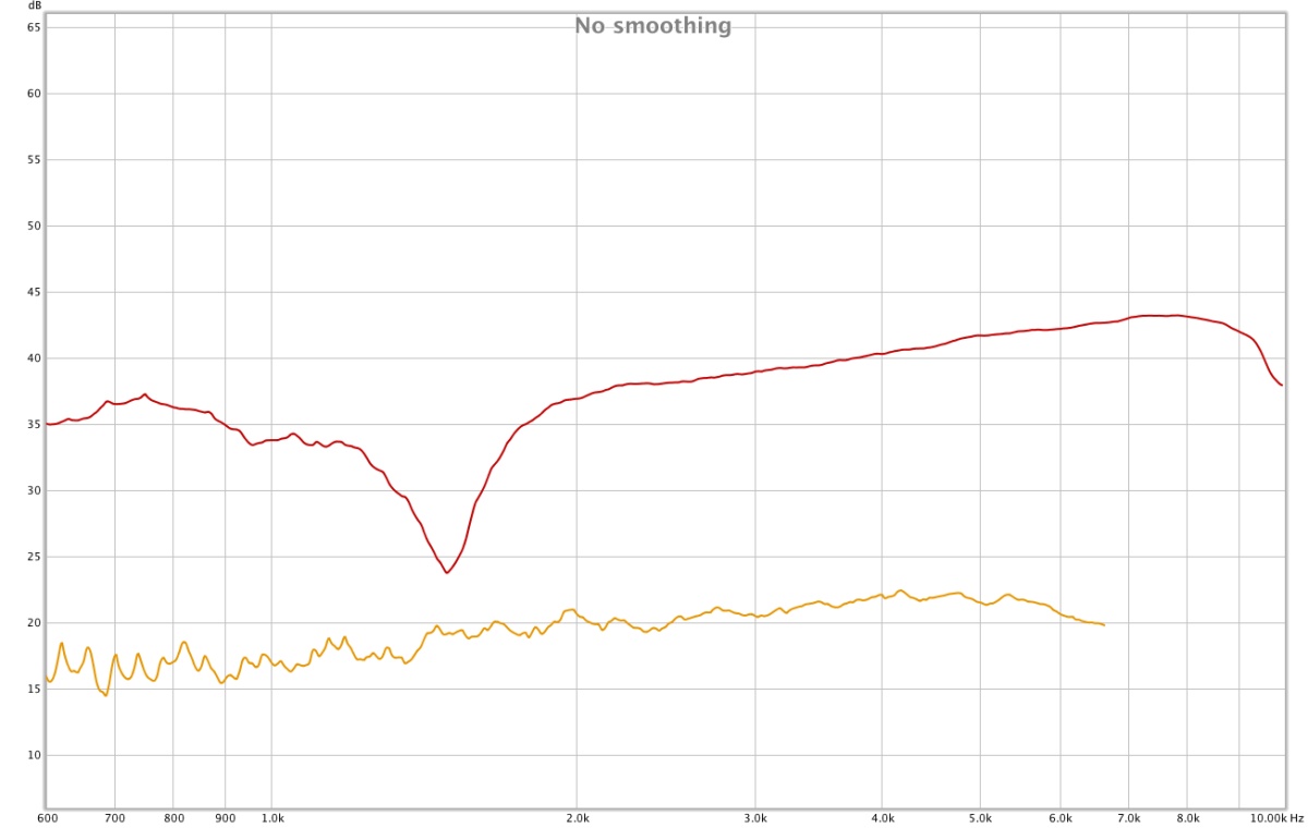

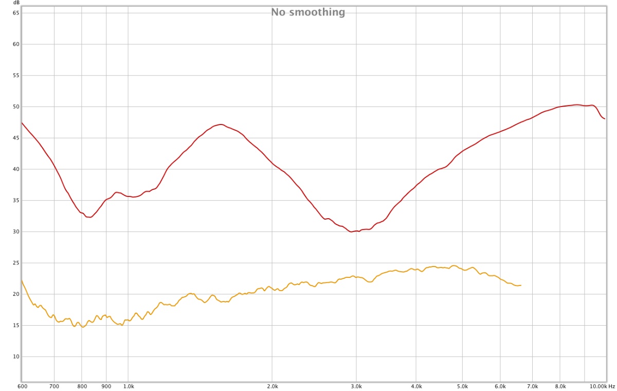

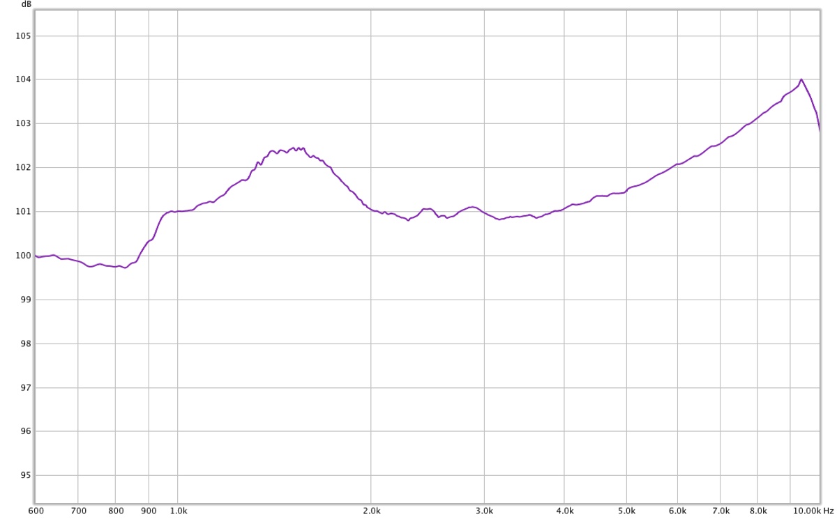

I was trying find why I get more SET-ish sound with choke version than the resistor version. The correlation between THD and speaker impedance would be the reason.
The THD plot of the choke version is similar to those of the tube transformer output amps, and the one of the resistor version is flipped. The sound of resistor version has more resolution, but I do not presume it would be related to these plot.
The attached plot is measurement of the amp output connected to JBL 2450SL driver.
Choke, Resistor, FR. Red is 2nd, Yellow is 3rd.
After carefully listening to those versions today, I think I can conclude this behavior is actually the SET magic that I have been felt.
My theory is this. 2nd harmonic adds glow, makes instruments larger, which makes me feel things are closer to me. However, with choke, the amount of 2nd harmonic is a lot different depends on the frequency position, so something like vocal is moving back and forth depends on the note she sings. This behavior makes me feel she is moving in front of me, more life like, 3D, intimate. But when I play something like clearly recorded piano solo, such as Glenn Gould, I know the grand piano should not be moved back and forth, so I just feel some notes are more exaggerated and pokes out unnaturally. String quartet sounds lively and real as a whole, but it’s very hard to focus one instrument in the quartet, because all of the instruments are randomly moving back and forth.
With the resistor version, the vocals and instruments doesn’t move, it stays on one plane. Probably not deadly still as PP amps, but I can still focus detail of each instrument much better, but vocals are much less life like.
This effect is not really related to the whole amount of the 2nd harmonic. It is clearly heard at most bias positions.
Both sounds really good, just different. I think I will make a switchable version. :)

About R an L sound differences, apart from Harmonic Distortion and PSU noise, I can add damping factor in determining some sonic difference. All those parameters in unison will play the role. This is why is so hard to determine the sonics from charts :) (even so, I love to make all measurements I can)
In practice, the resistor version will parallel the SIT drain AC resistance with resistor, lowering output impedance.
Yep, I had to add EQ to match each version's frequency response when comparing them. More so for the choke version, as you said. :)
