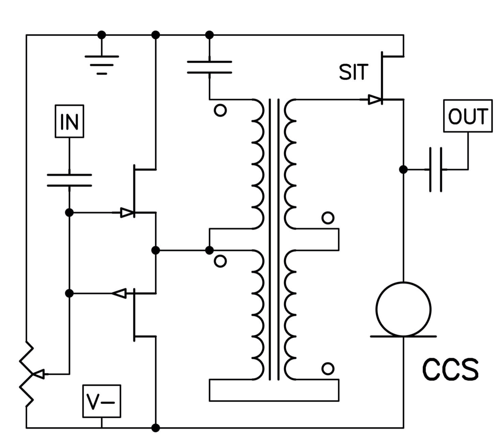

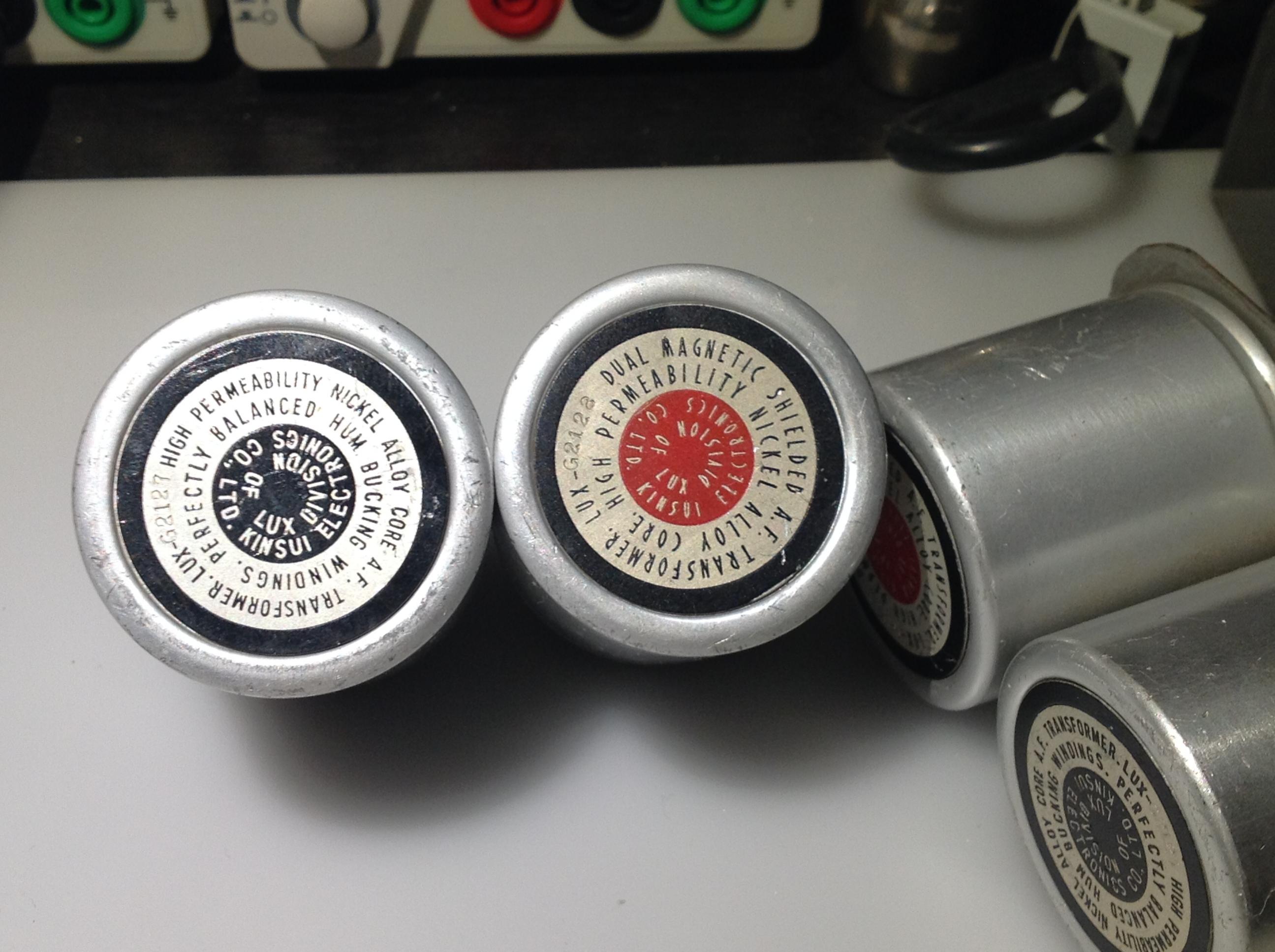

With the input transformer music is smooth and natural.
Caps are good too i don't have teflons yet.
Last change was MKP bypass for 10000 uF.
LSK jfet's + autoformer gain stage can be interesting experiment.
I can make try this but not easy because i always work on circuit with schematic
and his components values: jfet's Idss, resistors, trimmers ( caps too?) etc.
Brave souls please guide me

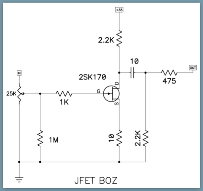

you could try the http://www.diyaudio.com/forums/pass-labs/103050-jfet-boz.html ...
Thanks M_Balou for bring this Papa schematic
i was thinking about front-end like M2 or try Mr. Pass new circuit variant adaptation
for 2SK82 and his 193V inductor load. In drawer Edcor 600:10K , 600:600 and + vintage
Have a nice day

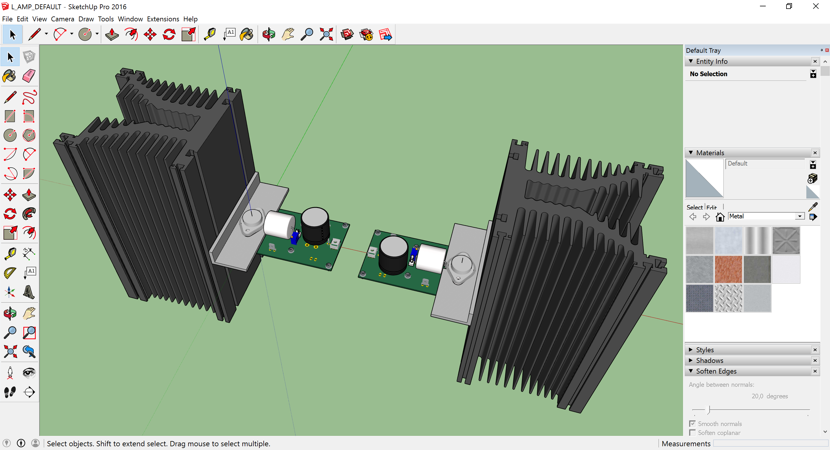

I connected the amp to my main speaker's horn (800 Hz & up) today, and I find this is a really good sounding amp even though my prototype's build quality is nothing but awful.
Soundhappy, thank you for your comment about the transformer. I decided to make another quick prototype pair with cap input as a woofer side amp.
Have you finalized the bias and voltage? I'm still trying different ones. BTW, my heat sink becomes too hot with 2xSIT @20V 2A,
so I will have to redo the heat sink job.

No i don't finalized but i do try different points up to 2A and 25V | 27 V later.
It's completly new vfet who is weak up now from long sleep ~ 35 years.
I like try more Bias current but i give him time and stay polite at 1.5 A for one month.
My heat sink is hot too. For the moment L profile is in reverse position ,
definitive amp version be up side down that distribute better all heat from bottom to the top.
I do try other resistors technology and brands.

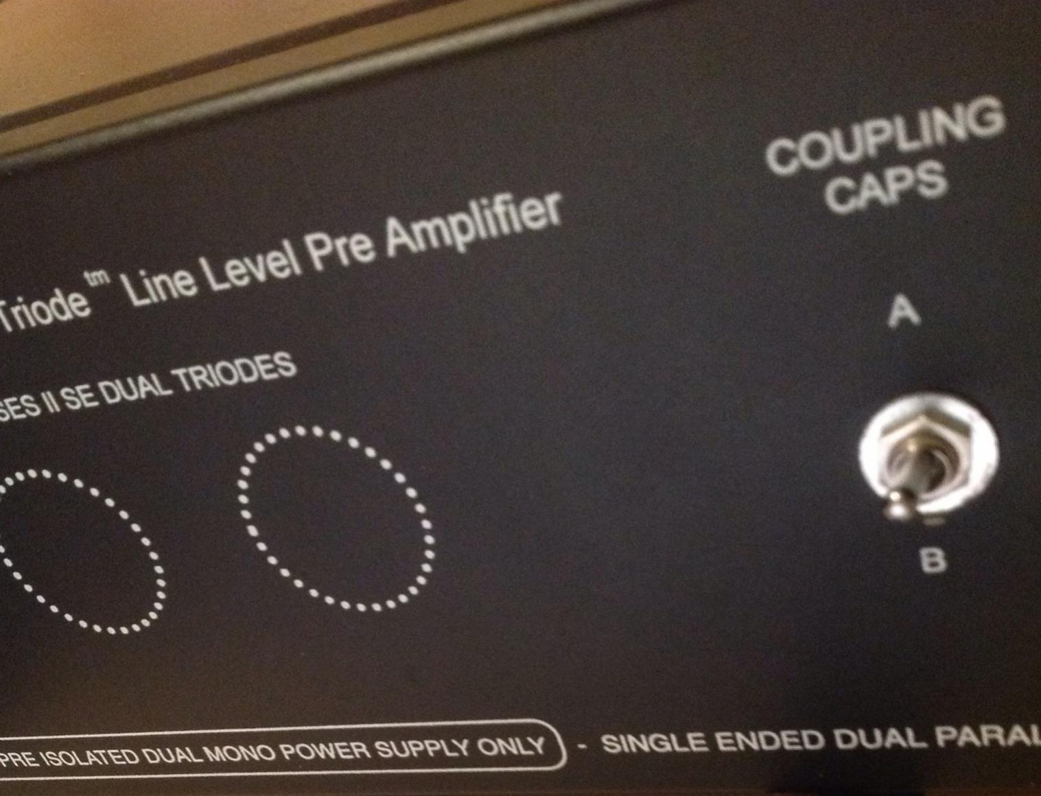

Preamp is modify by me and i do use switch one positon for nice caps and
the other for 600:600 transformer. Get choices bring modularity.
After that i can skip input caps of the vfet amp without the risk hooray
