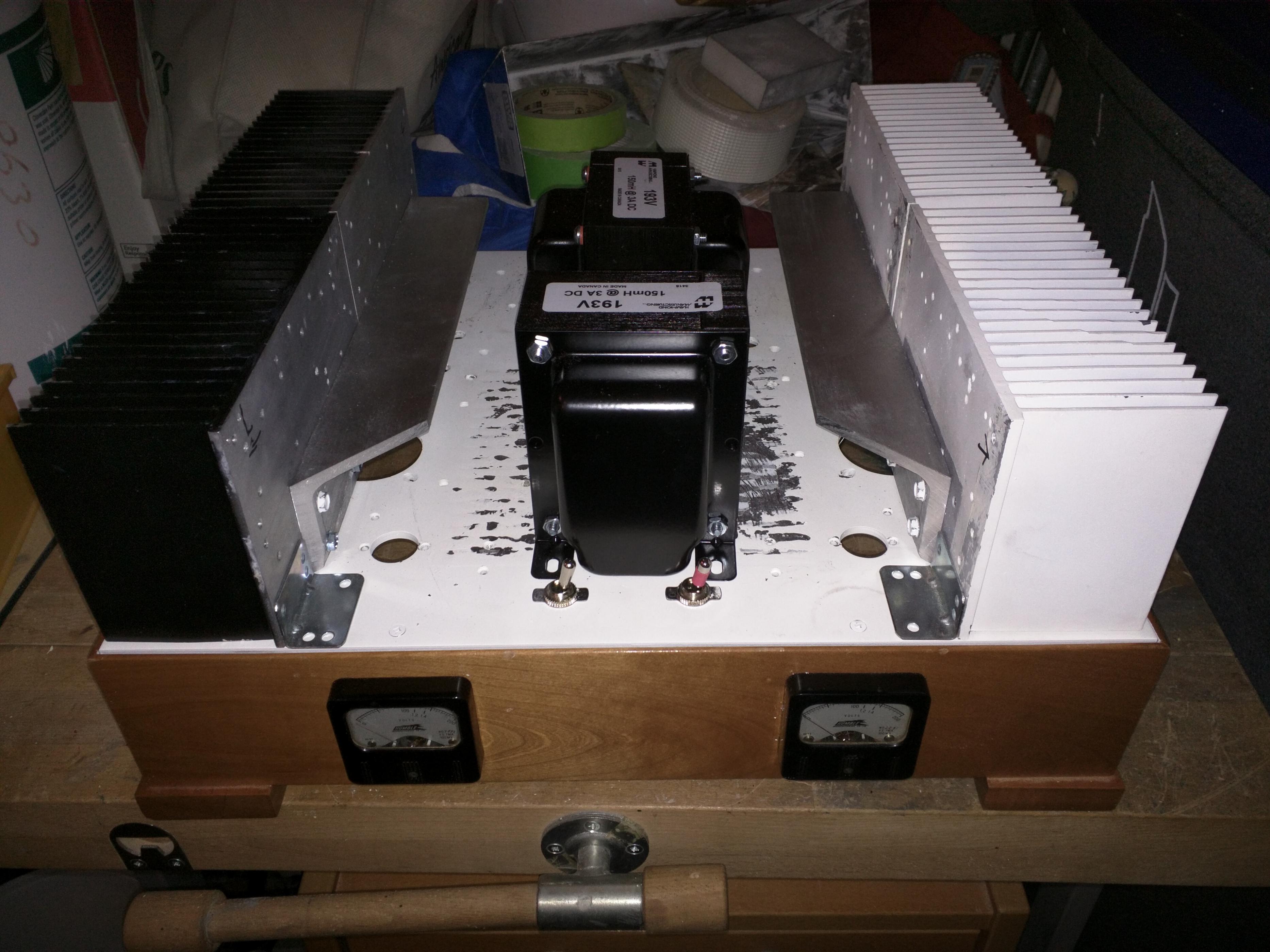

Looks about right to me. I would chrome plate the transformer covers and those corners for a more spiffy look when you finish testing.
I like it as it is. imperfections , contrasting colors, recycled stuff.
I am very interested in hearing how the LAMP with 2SK180's sound. I have some too, have not gotten around to building with them however. Looks like I need a giant heatsink!!!
Good idea.
I'll post on every step I go. Hope someone with experience will give guidance and or advice. The Chassis looks big, but it's big if compare to my other amps.
I still have trouble to place all those parts around, up and down.
